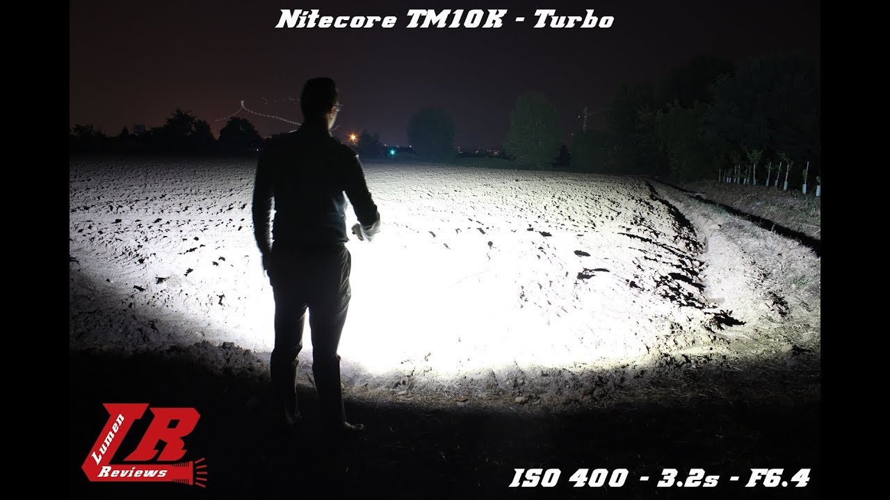

Beamshots
As you can see, the beam is very wide and it barley reaches the 100 meters mark on the max output. It is a floody light as you could tell from the combination of LEDs and reflector.
