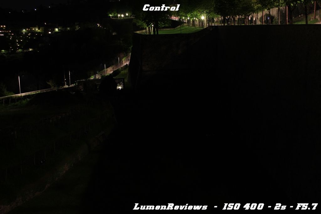

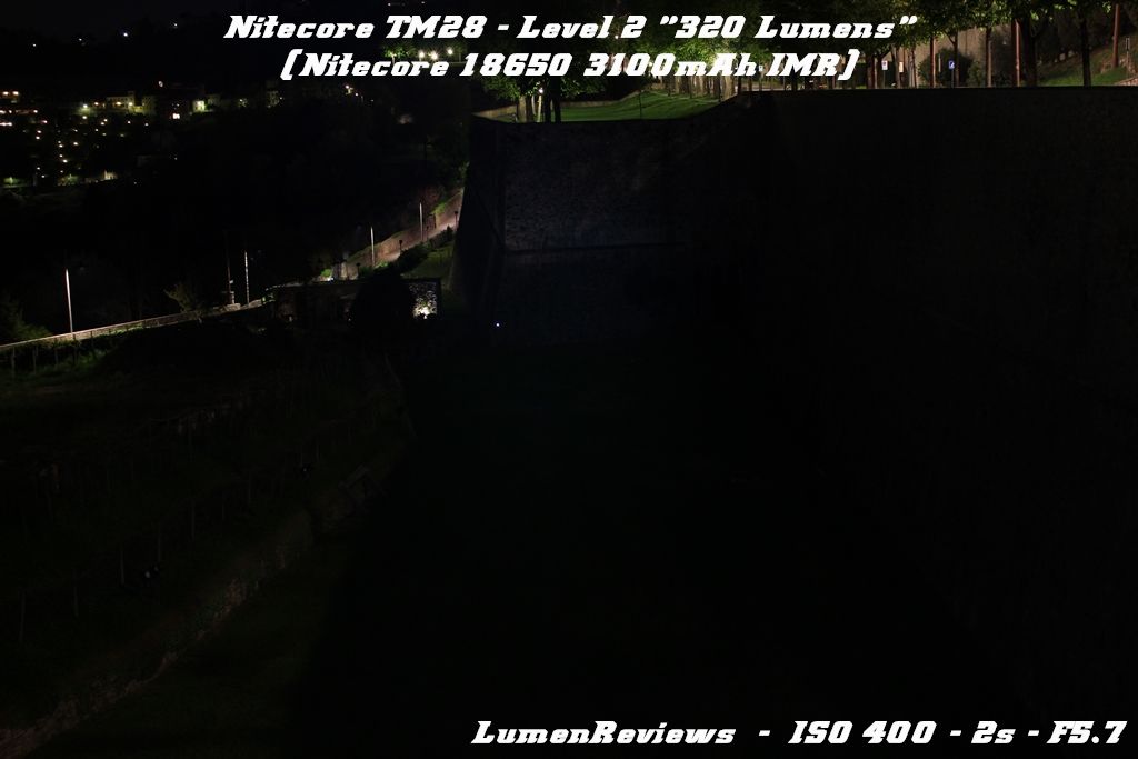

Beamshot, 100 meters at the threes.
Level 1 pointed to the right
Level 1 pointed forward
Level 2 pointed to the right
Level 2 pointed forward

As you can see, the light offers a balance of flood and throw. The spill is wide enough to hit my shoes (means that I have fully lightened my walking plan) and even with 320 or 1000 lumens you have more than decent visibility at the distance.
In these shots, I’m on top of a wall. The other side of the wall is 167 meters from me. I do not know why in the last pic the temperature balance changed. The light does not go from cool white to warm white at turbo, for sure.
Almost doubling the distance, the TM28 still covers easily the 170meters, with a spot that now is very wide, (so it will not have a great further throw), meanwhile the spill is still very vivid and wide.
As I said, the TM28 has a balanced beam, with decent throw and an intense, wide and usable spill.
