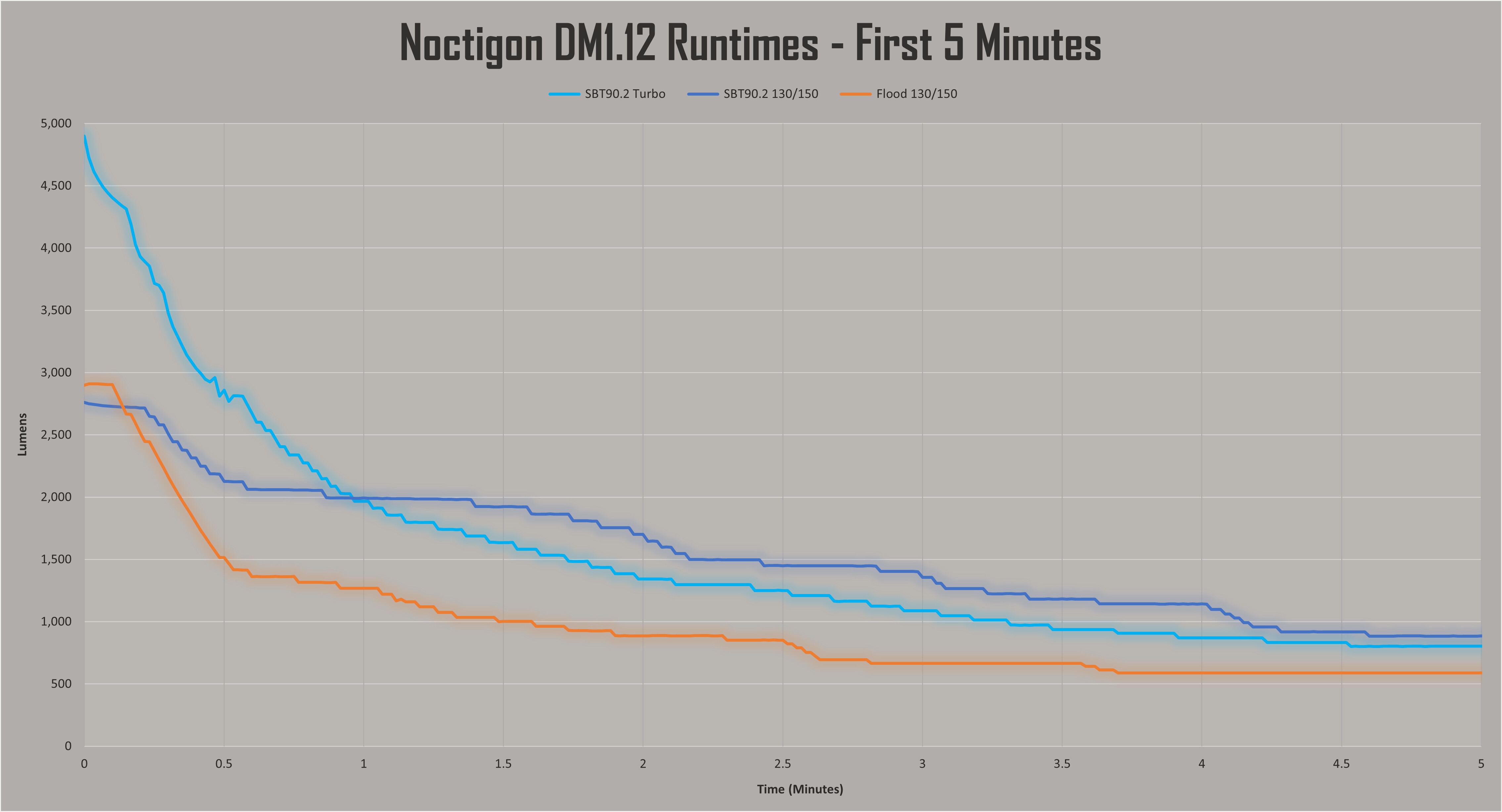

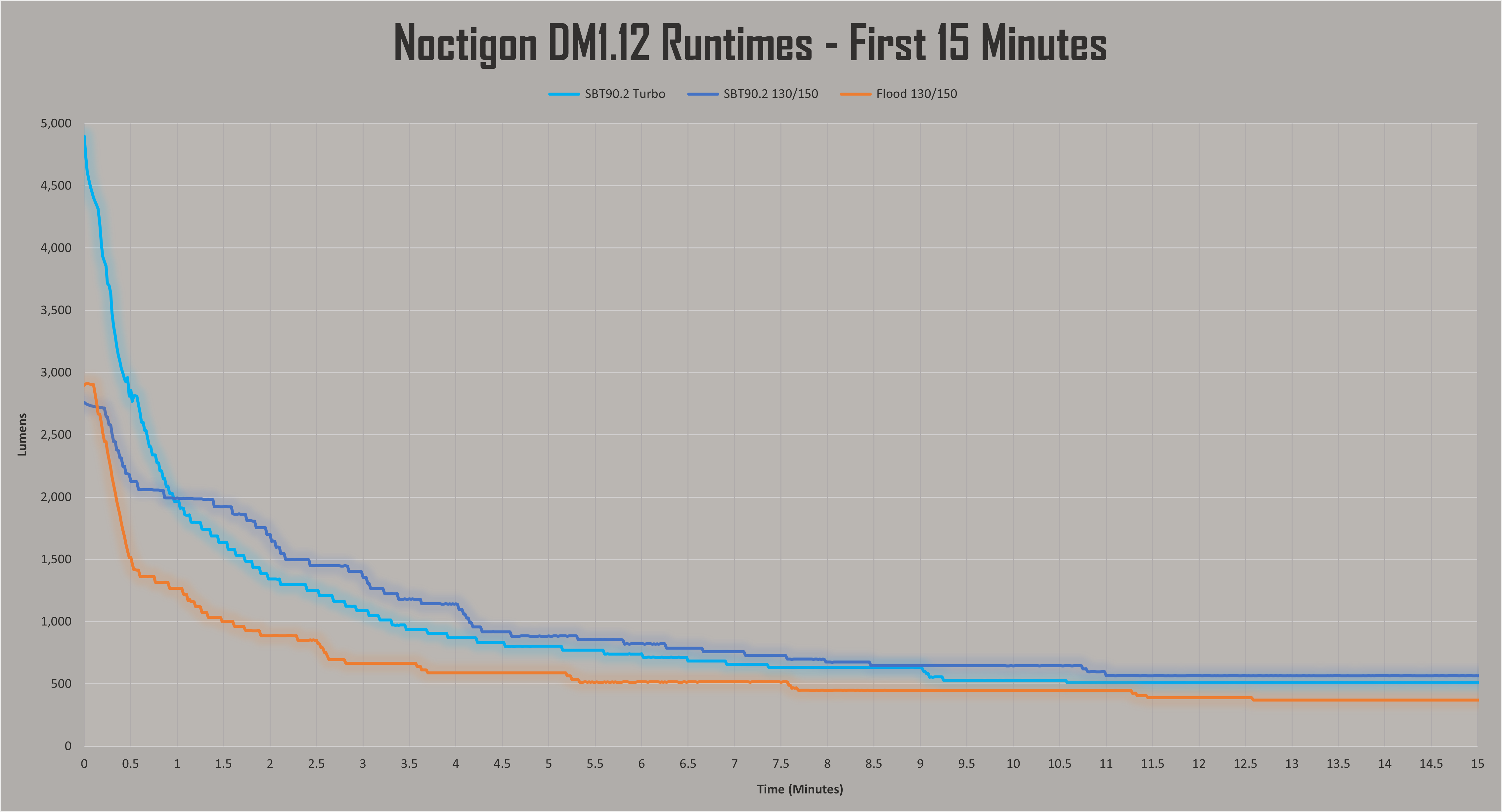

DM1.12 Runtime (Turbo) - First 5 Minutes:
Naturally we see a pretty quick drop from Turbo, but the curve is pretty smooth which is good to see. The flood channel has a more noticeable drop over the first 30 seconds.
DM1.12 Runtime (Turbo) - First 15 Minutes:
After just 8 minutes or so were are at around 20% output, and the light is quite warm in the hand, but not at all uncomfortable. This level is still plenty bright, but I would hope to see a bit better sustainability with this large head. This is more due to thermal limit, which is discussed further down.

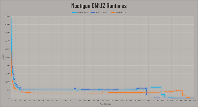

DM1.12 Total Runtime (Turbo):
Total runtimes are a bit under 3 hours on average, a bit longer for the flood channel on turbo. This is fine in use, to be expected from this driver.

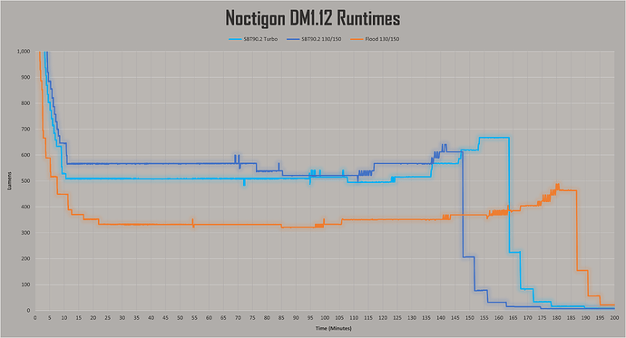

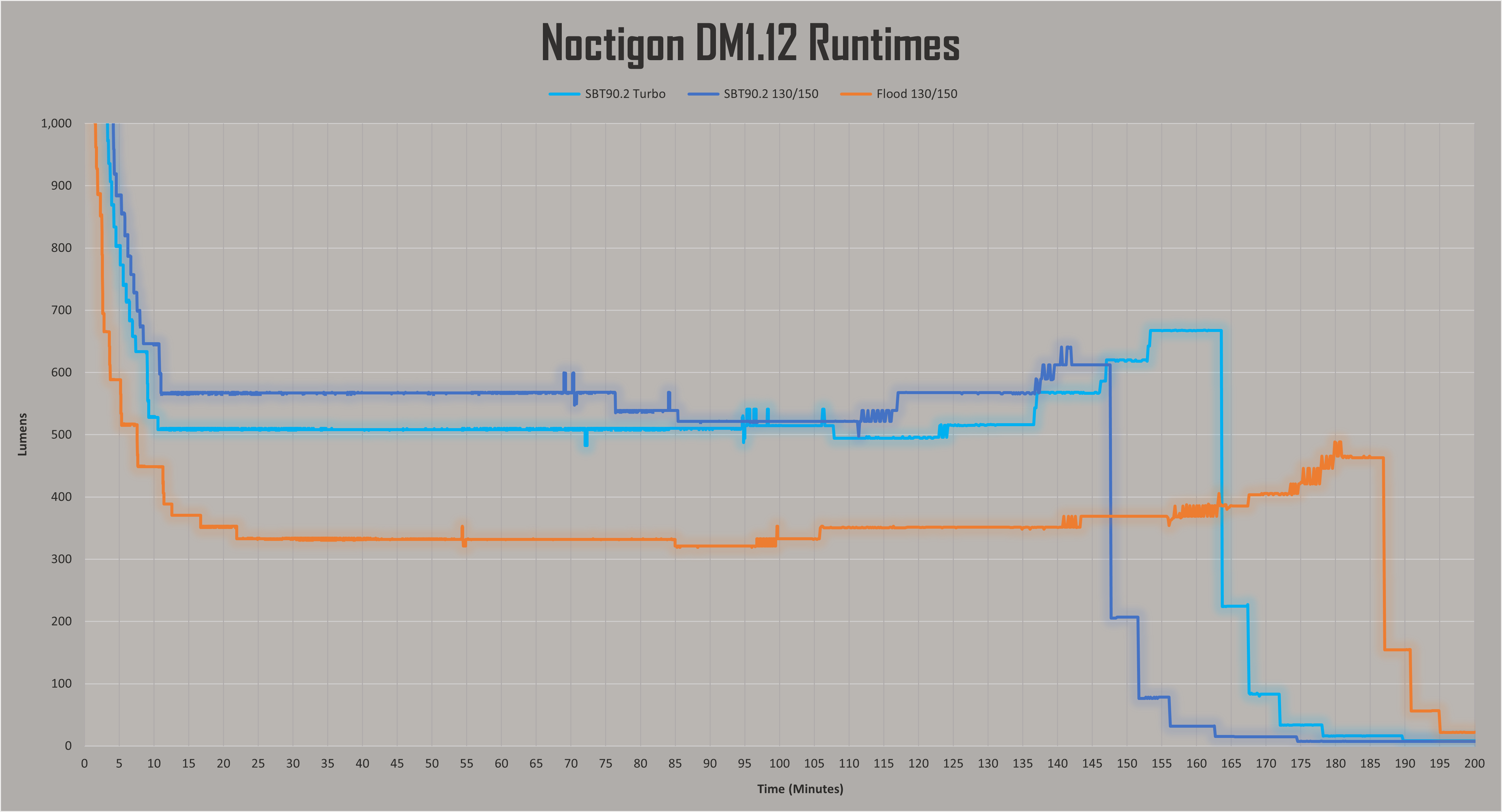

DM1.12 Total Runtime (Turbo) - Y-axis set to 1,000 lumens:
This was at the default limit of 45C - sustainability for the SBT90.2 is very solid, with ~550 lumens sustained for about 2 and a half hours. The flood channel however is a bit weak, with just 300+ lumens for most of the run. This is not good, I would have liked to see at least double that…

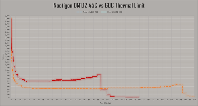

DM1.12 45C vs 60C Thermal Limit (Turbo, Flood Channel):
As it turns out, raising the thermal limit to 60C will give us just that! We are now sustaining 600+ lumens from the flood channel (and getting about half the runtime…)

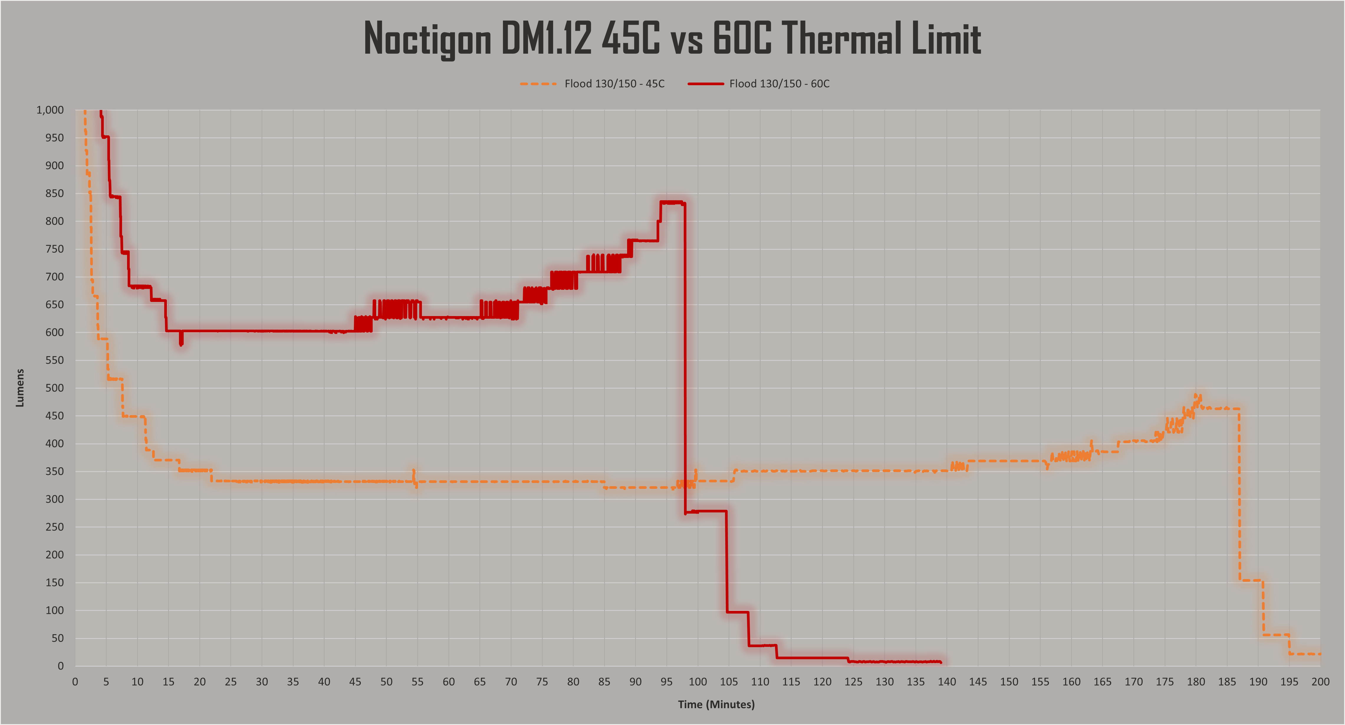

DM1.12 45C vs 60C Thermal Limit (Turbo, Flood Channel) - Y-axis set to 1,000 lumens:
I am much happier with these results, as now there is a mimnum of 600 lumens during the run, and as the battery voltage drops and drive becomes more efficient, it climbs all the way up to 800 lumens before dying out. Unfortunately, there is a pretty severe penalty to battery life as a result. The light is also much hotter in the hand, to the point of being uncomfortable.
I am somewhat disappointed in this flood channel. Output is either fairly low, with decent battery life, or pretty high, with poor battery life and a lot of heat. Note that maximum output will be substantially greater if you do not get the SBT90.2 version, as now the flood channel gets the full FET drive instead of the throw… but efficiency will not improve. Other reviewers measure about 4,000 lumens on turbo with this configuration.
