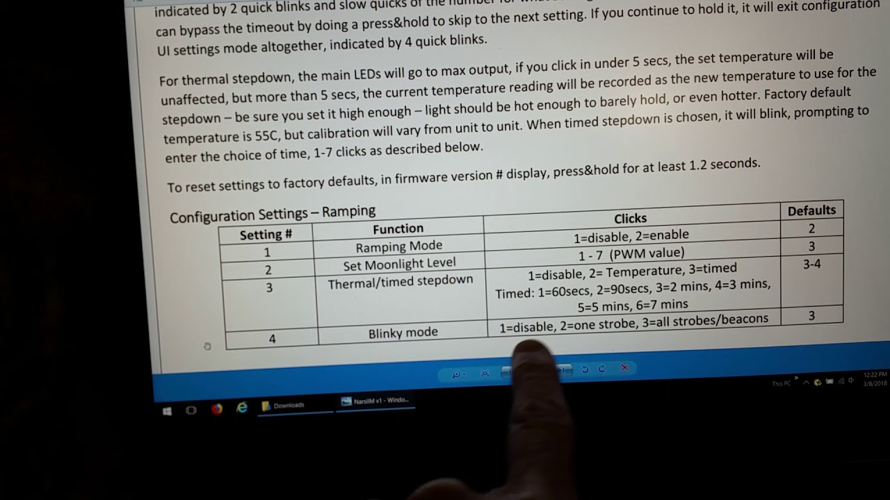

UI on this thing is a dream when i compare it to the S42. The UI on the s42 was horrible in my opinion, even after forcing myself to carry it for 8 days i still hated it. Narsil v1.3 on the s43 is in comparison a dream to use.
1 click for on
1 click for off
- click and hold when on to ramp up in lumens, let go and click and hold to go back down.
2 clicks for instant turbo
-double click again for strobe (this function is off by default)
3 clicks for batt check
4 click for electronic lockout
5 clicks to turn on momentary mode (click for full output, release for off.)
- to disable momentary mode you need to twist tailcap on then off to reset.
