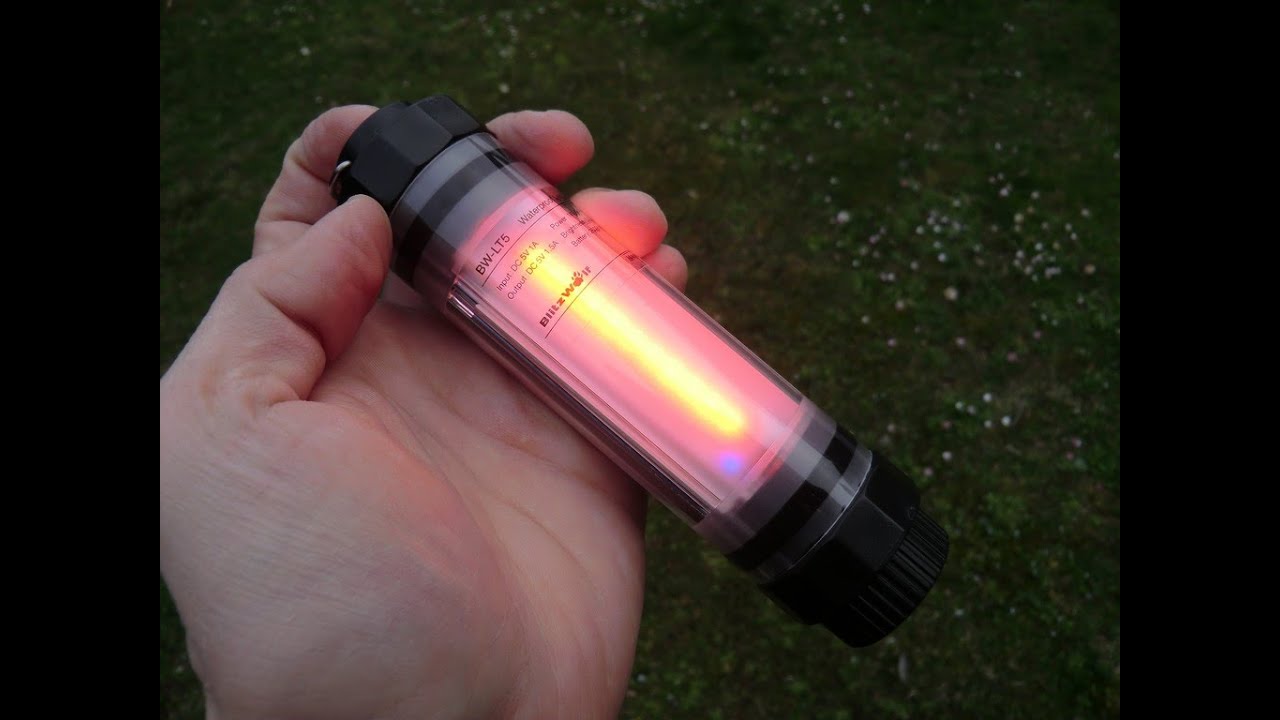

Let’s turn it on! First white light,
and red light
The tint of the light is slightly warmer than a CW, but it’s not a neutral. I can’t see PWM with my eye or with the camera.
