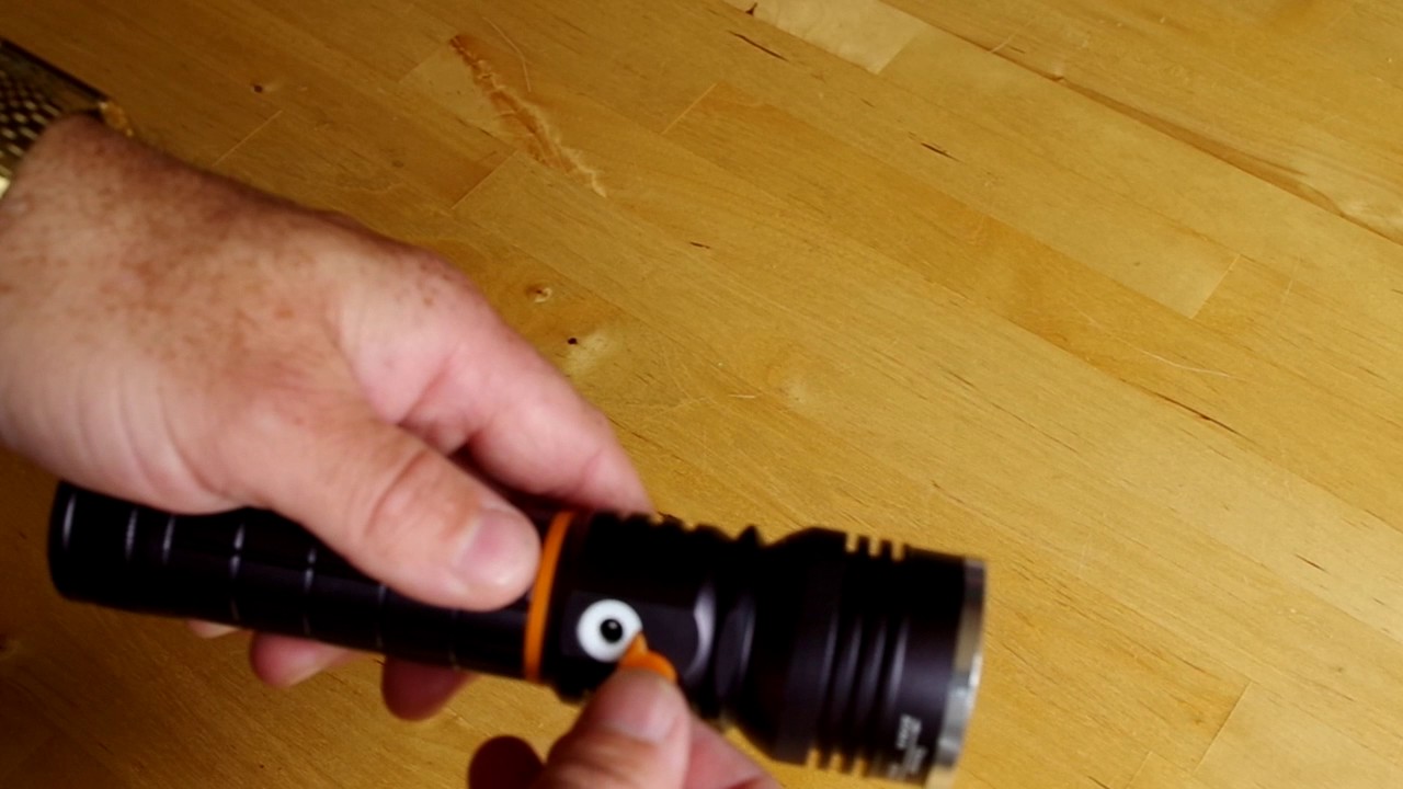

Exterior Design & Ergonomics:
This is a nice budget, light. Fit and finish is pretty good overall and it’s a nice anodised colour. Threads aren’t as smooth as the best out there, but it seems perfectly fit for purpose.
The tailcap magnet is very good and will happily support the weight of the light. The rotary mechanism on the zooming head is also easy to use and effective.
I’ve found you need to use a fairly slim 18650 in this light. I’ve been using Samsung 25R’s in it. But something like a Samsung 30Q is too fat to fit in the battery tube.

The orange ring on the body will glow if you don’t extend the handle when using the COB
Very nice floody light from the COB
Closing the handle slightly over the COB effectively allows you to lower the light being emitted, without the need of a separate mode.
