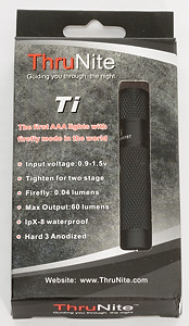

The light is delivered in a cardboard box with a window. Some of the specifications are printed on the front of the box.

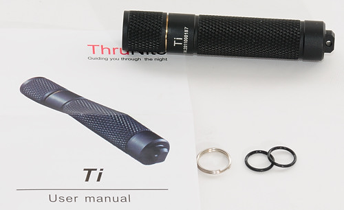

The box contains the light, two o-rings, a split ring and a user manual.

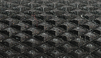

Both the head and the body is covered with ample knurling. The light does not have a spring in the body tube, this is not possible with this type of switch.

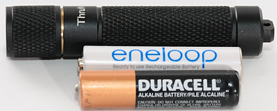

Measured size and weight:
Length: 74 mm
Diameter: 14 mm to 14.4 mm
Weight: 28 gram with eneloop
