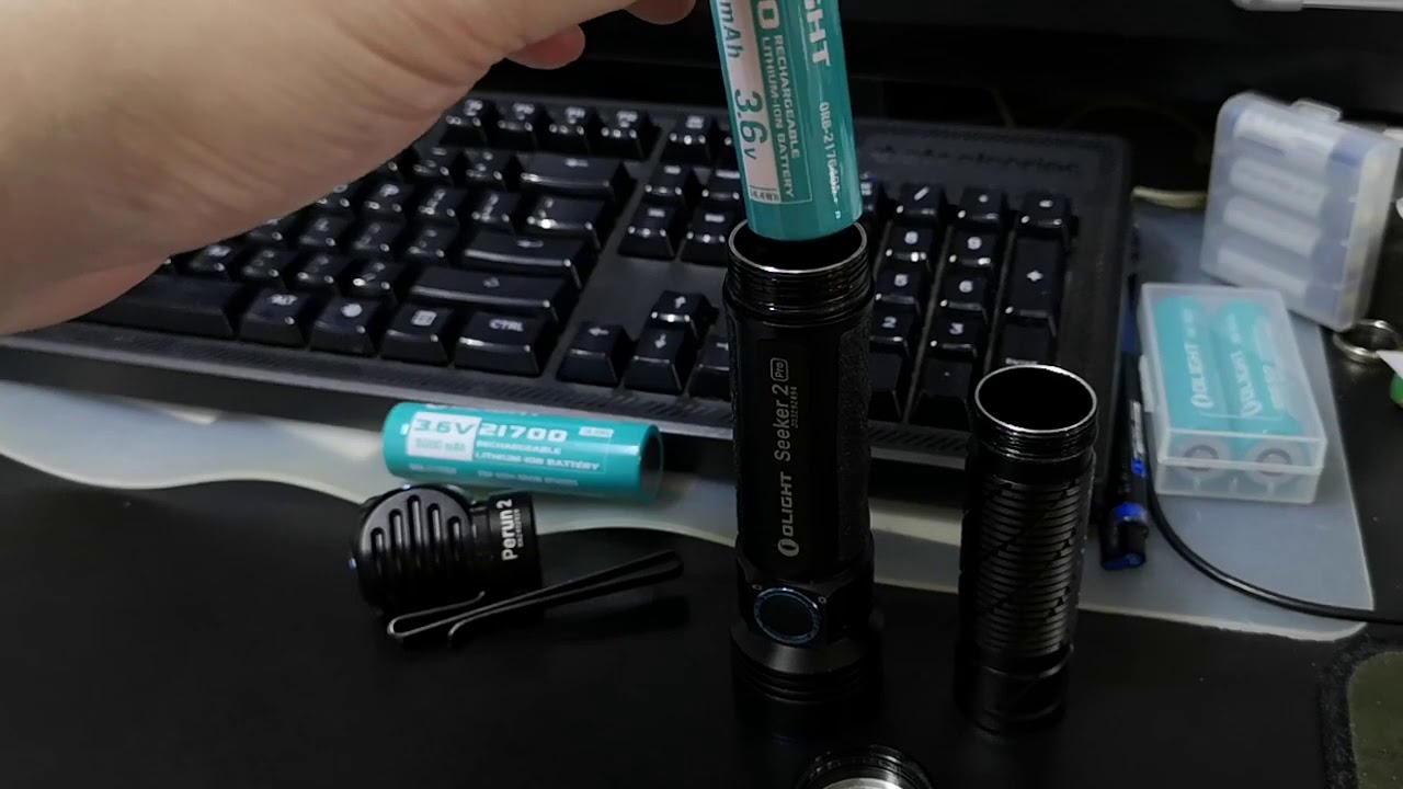

Forgot to mention that Perun 2 (and 2019 Perun) does support the use of normal high drain button top battery as long as the length of the 21700 or 18650 makes contact. Of course, you won’t be able to recharge using the MCC3 charger.
Sliding Perun 2 battery into Seeker 2 Pro…
