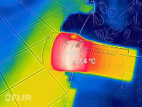

I tested the 3 higher levels both at Room Temperature with no cooling, and cooled by a fan.
Uncooled vs cooled plots show a big difference, due to Olight output regulating circuit. Remember that the 2 types of plot represent 2 opposite situations: one where the light sits inside a tube with no air circling (the worst one for cooling), and one where the light sits in a tube with a 10” fan, standing few cm away, pushing cool air on it (the best one for cooling).
In real use, you should always be in between these 2 extremes, and should expect proportional difference in the regulation.
The light becomes hot at turbo levels, no surprise here. I can still keep it in hand in the outdoor, and I will enjoy this more in the coming winter.

Someone asked on-off tests. For this one I had my hand on the light for the whole test.

For this test I had to let my hand on the light for the whole test.
