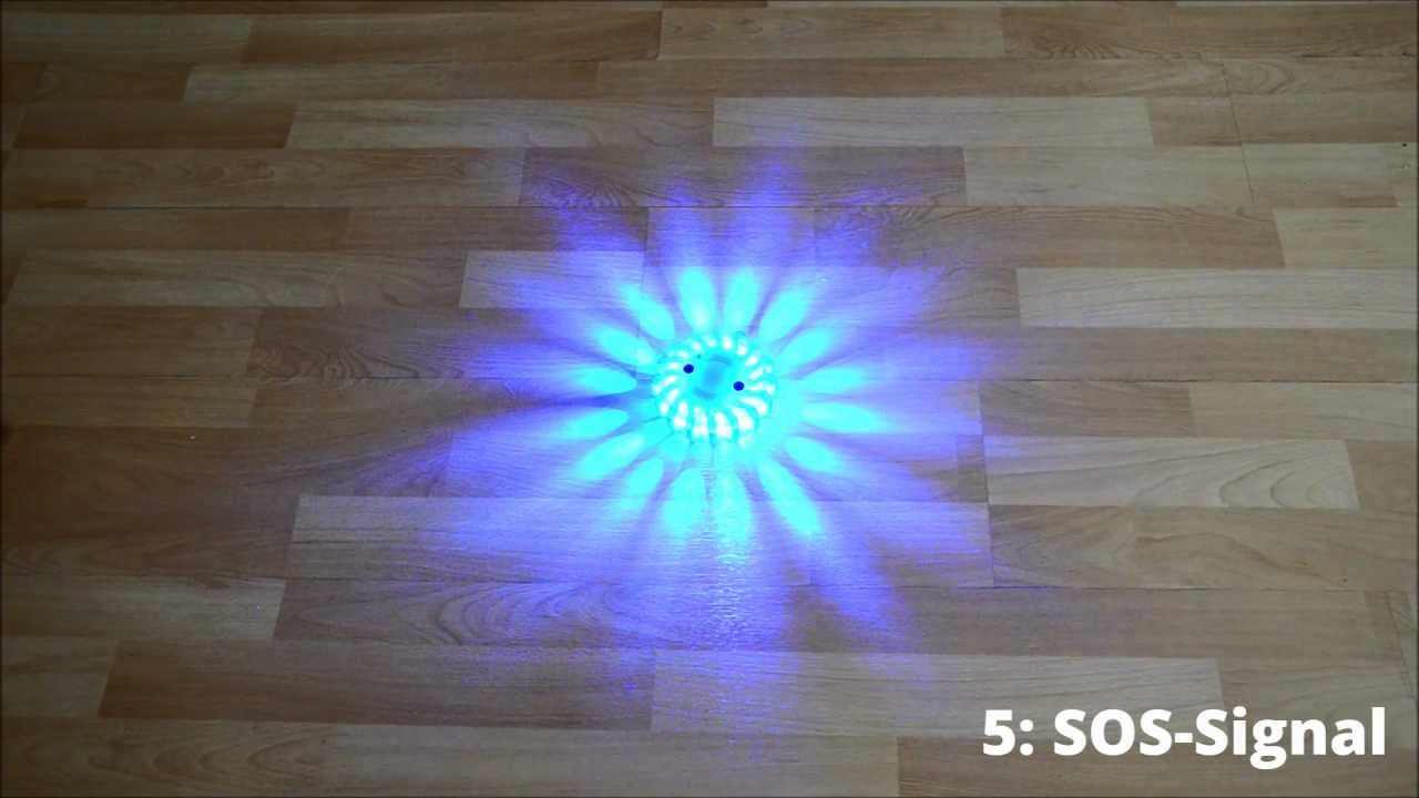

The dimensions are very respectable, is very small compared to its potential!
The magnet is very comfortable, returns useful in many situations, it is powerful enough to keep it
fixed in place.
The power button is designed well, hard enough, you do not activate inadvertently,
Press 1 again to turn
Press 1 again to switch modes in a cyclic manner, from off
Press and hold 3 seconds to turn it off in memory mode, the subsequent pressure we find the program you previously saved.

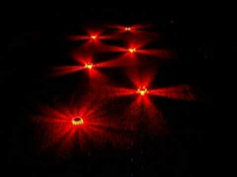

It ’ a really well made product ! considering the cost to have it,
their relatively small size , and the usefulness it has, really recommend it !
Find application / use on a number of occasions , visibility at night is really high …
In my work , sometimes I stand around a bend , I put a couple of meters before, so that the bogies
from the presence of people can understand immediately after …
I see a great replacement / addition to warning triangle for car, in case of nebia , stop in for emergency
and anything can happen …
