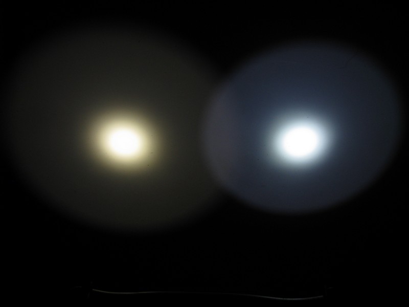

To show you the tint, here is the light up against my Ultrafire WF-502B with a cool white XP-G R5 and NANJG AK-47 3-mode driver (1 amp), first at 1/25th second to show spill, both on their maximum brightness. The 502B is a P60 host, so it has a larger reflector that focuses the light better, but the hotspots are about the same size:

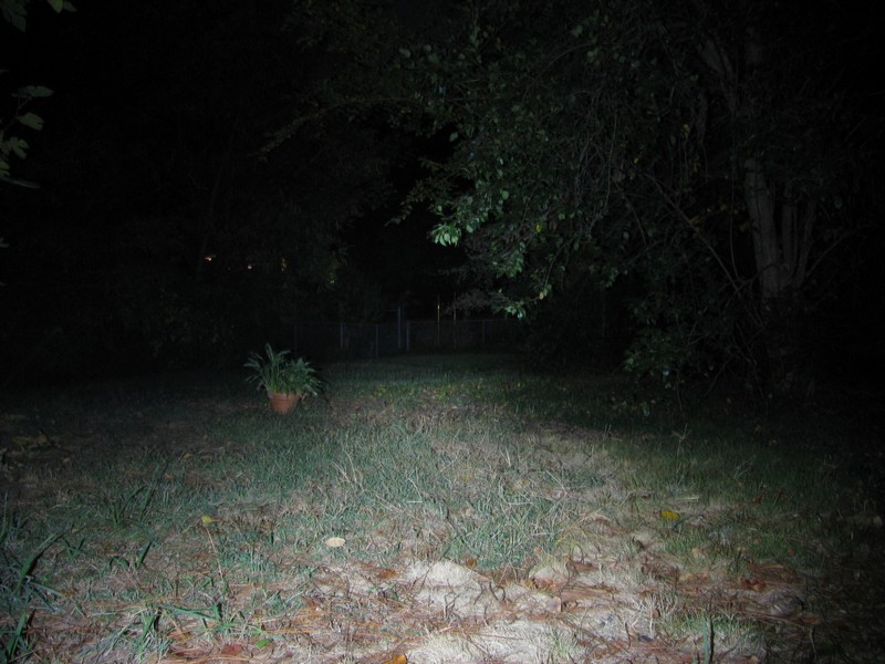

On High, you can make out the plan and barely see the fence posts:
Now on Max everything shows up pretty well:
