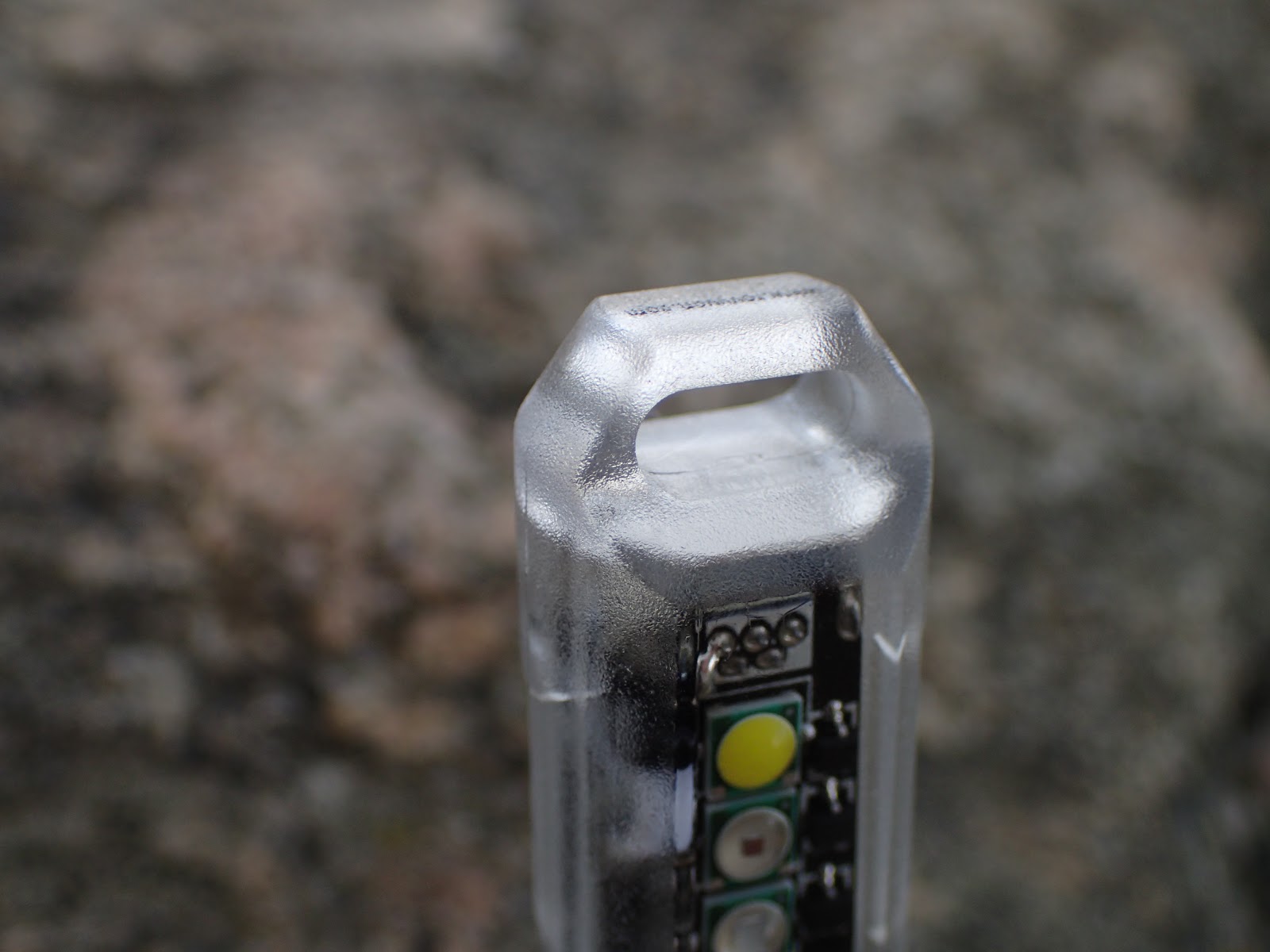

The body of the light is made of a clear polycarbonate, and brings back fond memories of old game consoles. The top side has a switch near the head, and a clear section showing the three side LEDs. The opposite side has some printing on it indicating the brand, model, and other information. Below that is the cover for the micro-USB charge port. I've had mine in a pocket with my keys for a few weeks now, and the plastic doesn't show any major wear as a result.
The tail has a loop in case you want to attach it to something, with the website printed on it. This light won't tail-stand, and obviously mechanical lockout isn't an option.

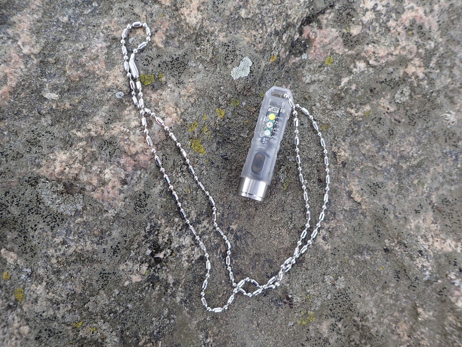

The loop on the back can be attached to a keychain, but RovyVon also includes a lanyard and a "necklace" you can slot through. The lanyard is almost laughably large compared to the light, but it works. The necklace is a bit too reminiscent of a bath chain for my liking, but it's functional and easy to swap out if you want something snazzier.

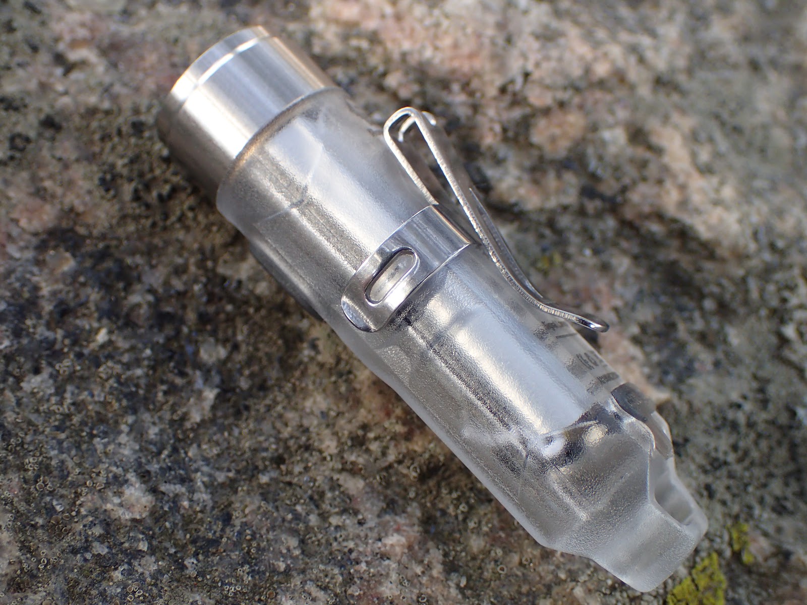

The clip is very short and doesn't carry especially deep, but it has a solid hold on both the light and whatever you clip it on to. I personally don't often clip lights this small to my pocket, but the reversible nature of this clip makes it great for clipping to a hat and using it as a headlamp. It can also be clipped to a jacket or bag when using the side emitters and blinking modes for a great locator beacon.
