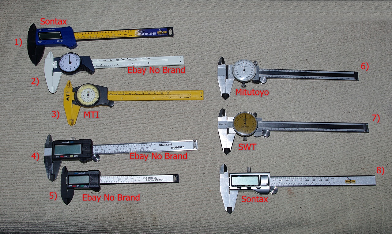

I love measuring tools , especially accurate measuring tools . For about 30 years now I have owned calipers and I just don’t know how I could possibly have gotten on without such . Dial or Digital calipers may not be the most supremely accurate tools in the world , and there may be some variance from one to the next but that does not matter if you use just the one and as long as the measurement is consistent and repeatable .
I have for a long time thought about a better or higher grade of digital caliper so when Banggood offered me the opportunity to review the SHAHE calipers I could simply not resist the opportunity . I have owned / do own quite a few calipers already and the idea of adding another caliper was just to good to resist . What comes in the plastic case is a very nice caliper / two batteries / a plastic tool for removing the battery cover / a test certificate / and instructions in Chinese .
