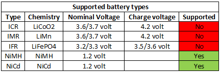

Shan SH-168DLCD
This is a NiMH only charger and it can charger AA and AAA batteries. The charger has some advanced measurement functions.
