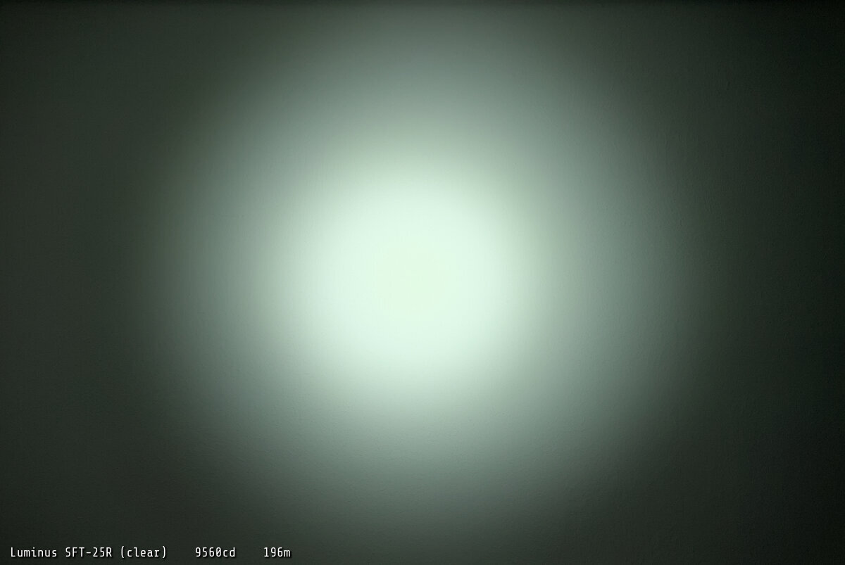

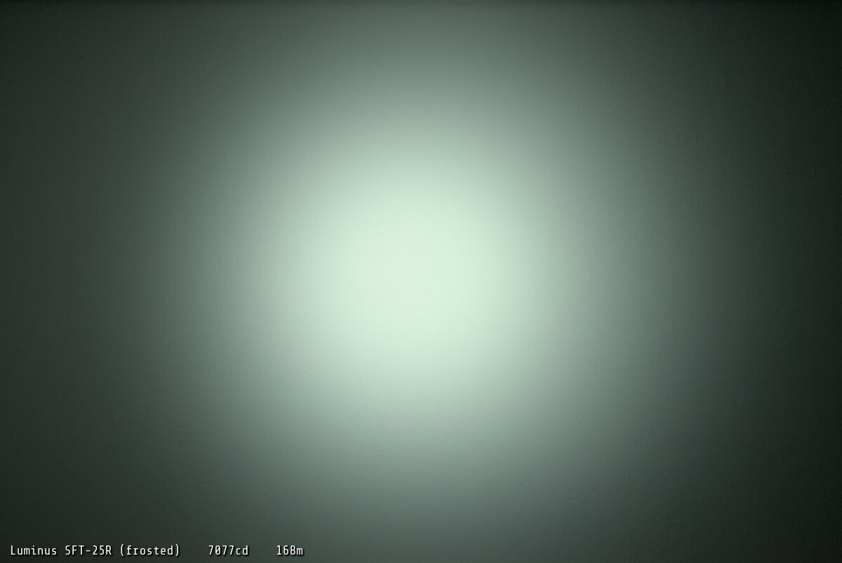

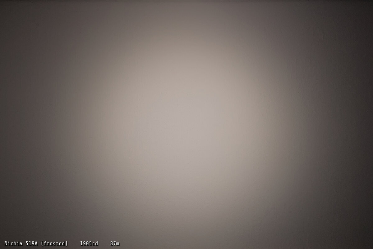

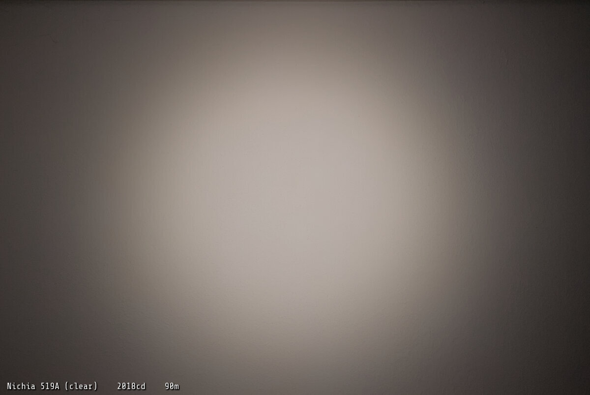

In the EC150, three LEDs are used side by side behind a single TIR optic. A glass with a bluish anti-reflective coating protects the optic from scratches. The Nichia 519A version has a clear optic.
The version with the Luminus SFT-25R, on the other hand, uses a frosted optic that slightly diffuses the light. This reduces the throw somewhat but improves the flashlight’s suitability for close-up use.
Both models produce a soft beam with a diffuse spot. However, the SFT-25R’s light is a bit more focused in the center and brighter. Especially when compared side by side, the strong greenish tint of the SFT-25R is clearly visible, while the Nichia 519A impresses with a noticeably more neutral color.
Outdoors, the difference in throw is clearly noticeable. It would be interesting to compare the SFT-25R paired with a clear optic for even greater throw (Skilhunt offers TIR optics as accessories). That said, a flashlight this size is generally designed for close-range use. In that area, the Nichia 519A version delivers excellent performance that fully convinces me.

SFT-25R (frosted): 7077cd / 168m
SFT-25R (clear): 9560cd / 196m (+35.1%)
519A (clear): 2018cd / 90m
519A (frosted): 1905cd / 87m (-5.6%)
I haven’t risked to dedome it yet because it currently has such a nice, neutral tint. I can’t measure it, but based on feel, it’s pretty much spot-on at the BBL. With the frosted TIR it definitely looks a bit more neutral than before.
