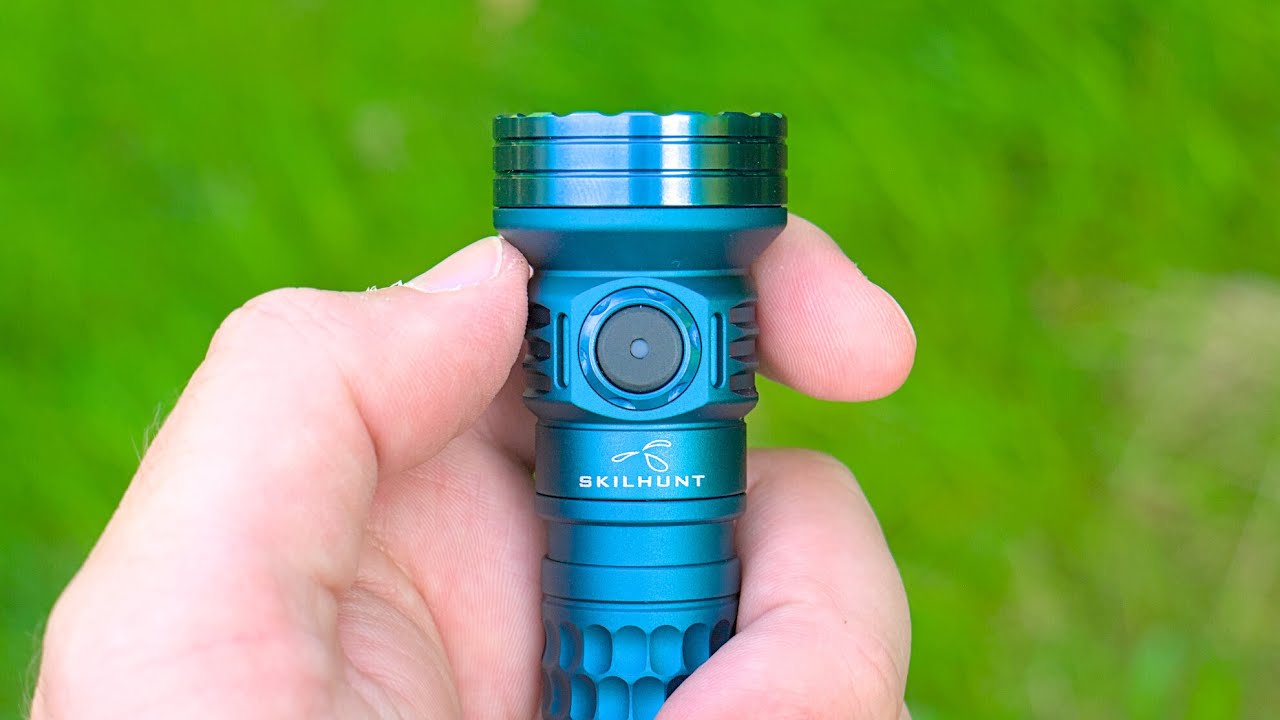

The MiX-7 is operated via a button on the head of the flashlight. It has a matt, solid plastic surface and is slightly recessed in the bluish bezel. When you press it, you hear and feel a precise click, regardless of where or from what angle you press it.
The button is somewhat difficult to find by feel as all sides of the head are slightly flattened. It is easy to confuse it with the charging port, which has a similar shape and sits exactly opposite. If you have the clip attached, you can use it to help you find the button.
