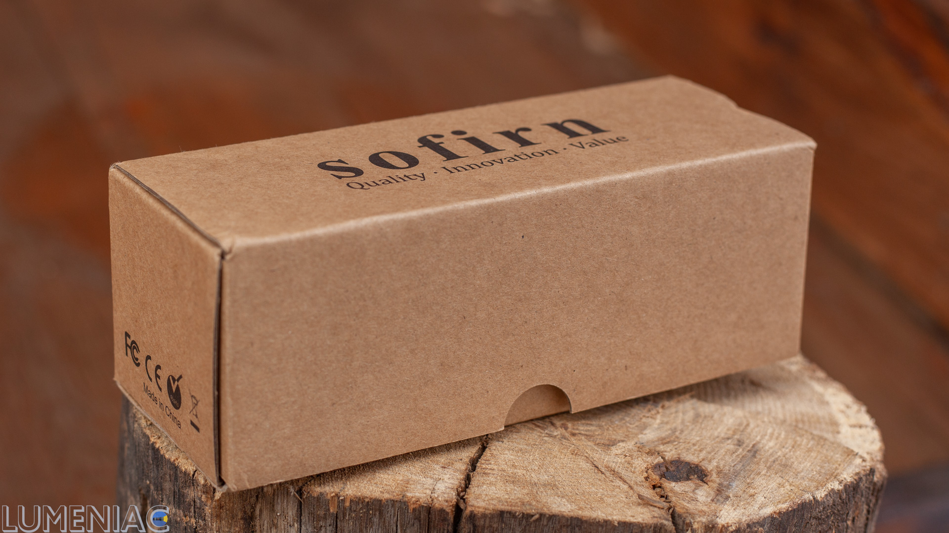

The most common beige cardboard box, nothing new. Not very good in terms of a gift
The kit contains absolutely everything you need: a flashlight, a 21700 5000 mAh battery, a lanyard, O-rings, a charging cable, a manual, an adapter for 18650. No holster, but, well, that is what u expect for this price

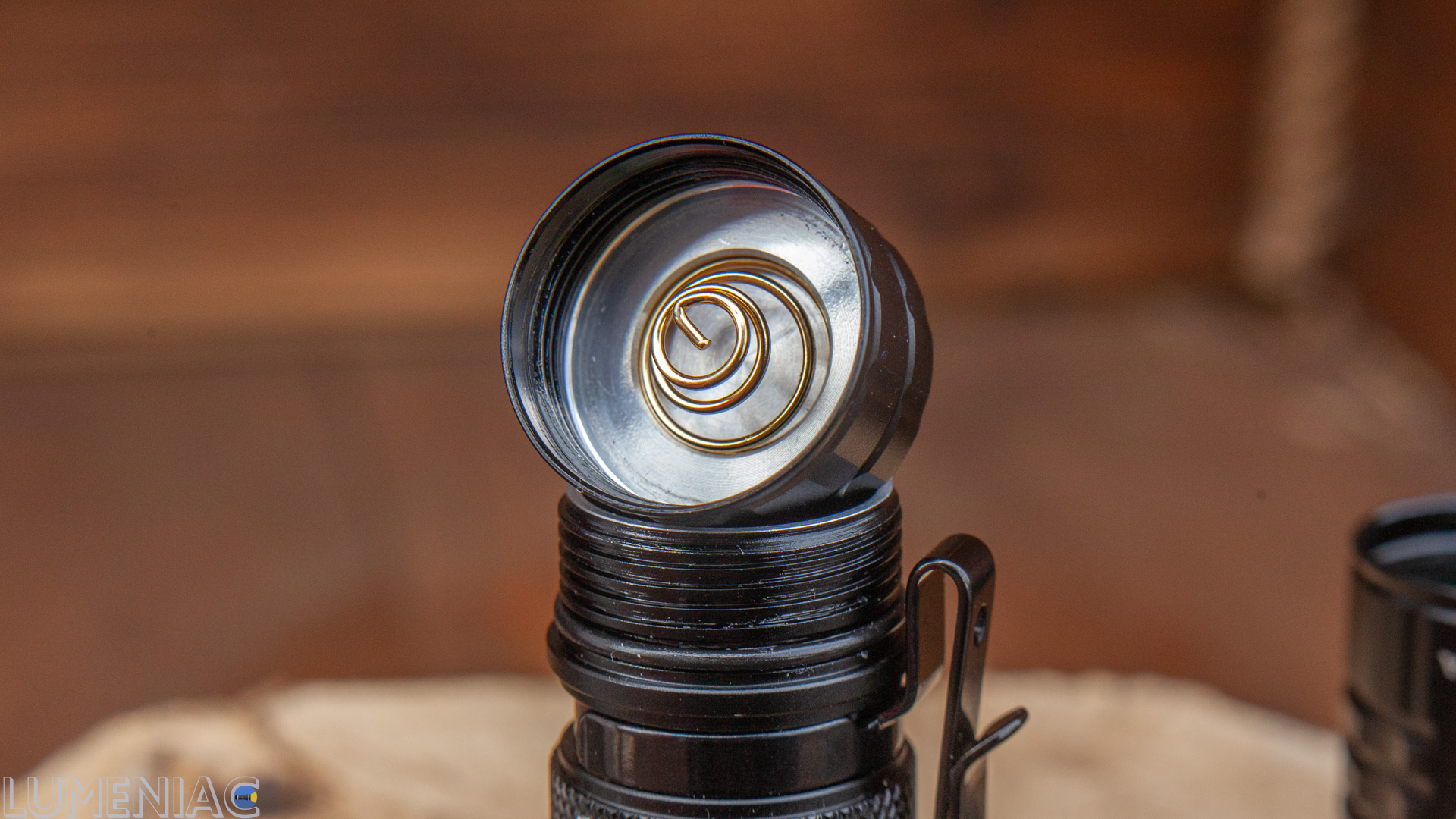

The flashlight can be disassembled in three parts. The middle part can be installed in any direction, there will still be contact and the flashlight will work.

The spring is of medium thickness. Despite the fact that there is a pin of the contact pad on the head, contact is not interrupted upon impact. I struck on the wooden table with effort - the flashlight shone without turning off. The threads are well lubricated.
But, still, i`m not sure Sofirn IF22 will withstand gun recoil like the same Sofirn C8G does.
