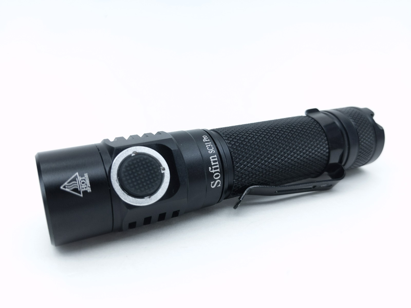

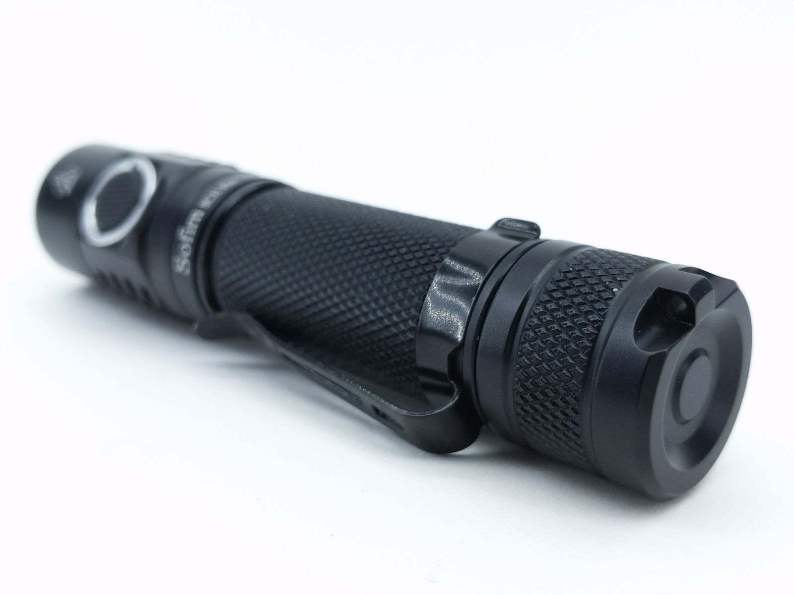

Fit & Finish

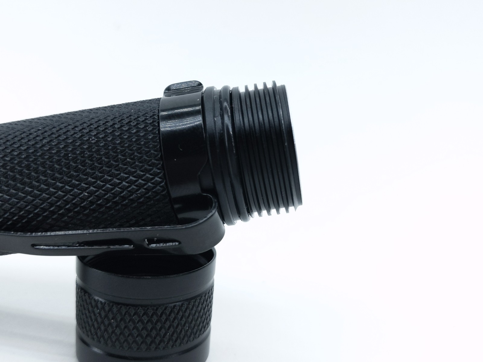

Like most Sofirn lights I’ve owned, the SC31 Pro feels well made. Certainly not high-end, but the threads are clean, square-cut and mesh well. Knurling is cut nicely without being overly grippy. Anodizing is full and satin-like. And for the first time in my experience with the SC31 series, the engravings line up! It’s a small thing, but it helps to appease my OCD tendencies.

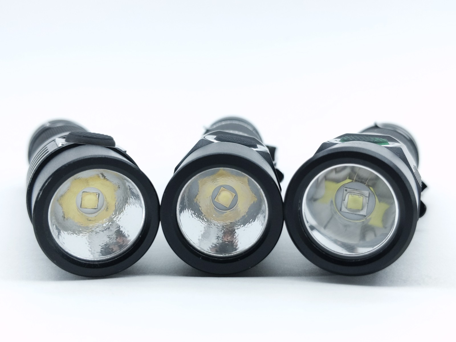

LED & Reflector
The original SC31 used a Cree XP-G3 with the full Cree-rainbow effect. The SC31B swapped that for a Luminus SST-20 including High CRI versions. The new SC31 Pro has changed LEDs yet again. This time we’re looking at the Luminus SST-40, a potentially more powerful 5050-footprint LED. My sample is 6500K, but is fairly white (no angry blue!). Sofirn also offers this in 5000K, but that was not available at Amazon when I acquired my light. The reflector, like the other SC31 versions, is smooth. However, this new reflector has a larger opening to accommodate the larger LED and is a bit more shallow than previous ones.

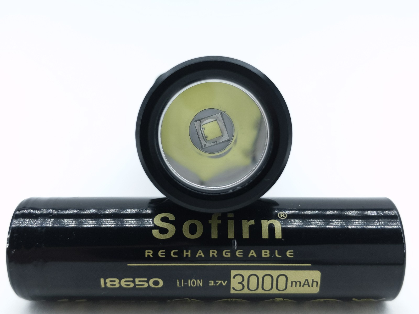

Battery & Charging
The SC31 Pro kit includes a Sofirn-branded button top 18650 battery with a stated capacity of 3000 mAh. Unlike the first two versions that used micro-USB for charging, the SC31 Pro now uses USB-C (finally!).

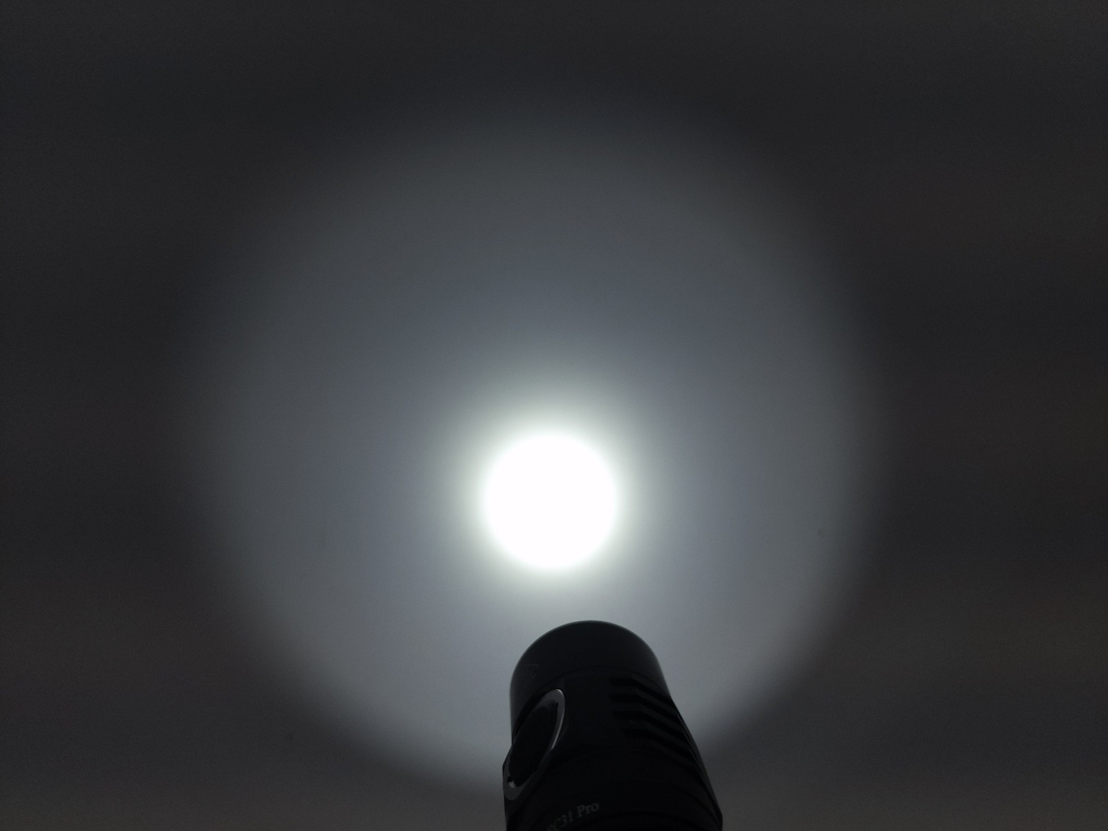

Performance & Runtime
I charged up the included battery, slapped it into the SC31 Pro, and fired up my lumen tube. Then I started scratching my head as the output dropped hard and fast. 1 minute into the test, it was sitting at 200 lumens and only 30°C. Hmm…. oh yeah. Thermal calibration. :person_facepalming: With the flashlight measuring 27°C by an IR thermometer, the temperature check said 49°C. Ouch, it was reading 22°C high. No wonder the output dropped off a cliff; the flashlight was barely warm but thought it was hot.
PSA - perform thermal calibration. Do it.
After calibration, actually Turbo
NOTE: this full runtime graph is using the top of the ceiling, not Turbo
Observations
  • Thermal calibration is absolutely necessary (have I said that enough?)
  • I measured 2434 lumens at 0 seconds and 2255 lumens at 30 seconds
