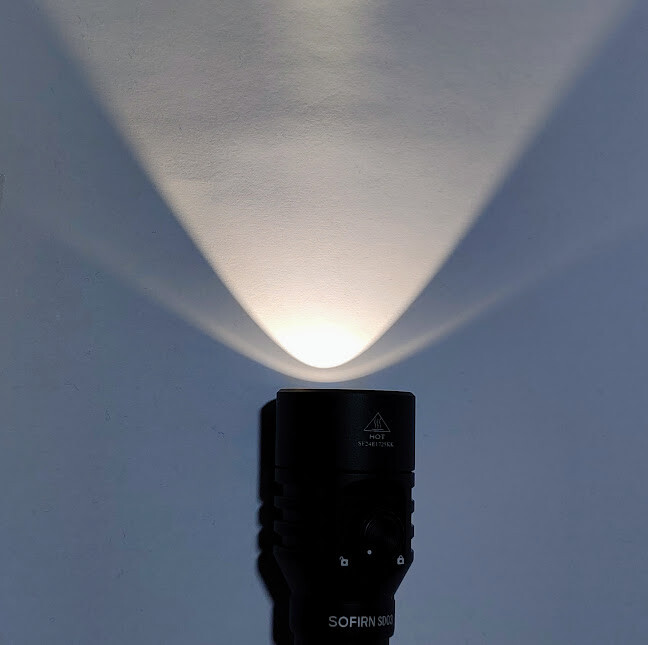

Beam
The SFT40 is a domeless LED and sits beneath a rather deep reflector. The light quality at Ra 65 is moderate, the spot is slightly green.
The beam and spill are pretty tight, as expected from such a setup. A range of 447m is a lot for a light this small. There’s a ring around the beam.
