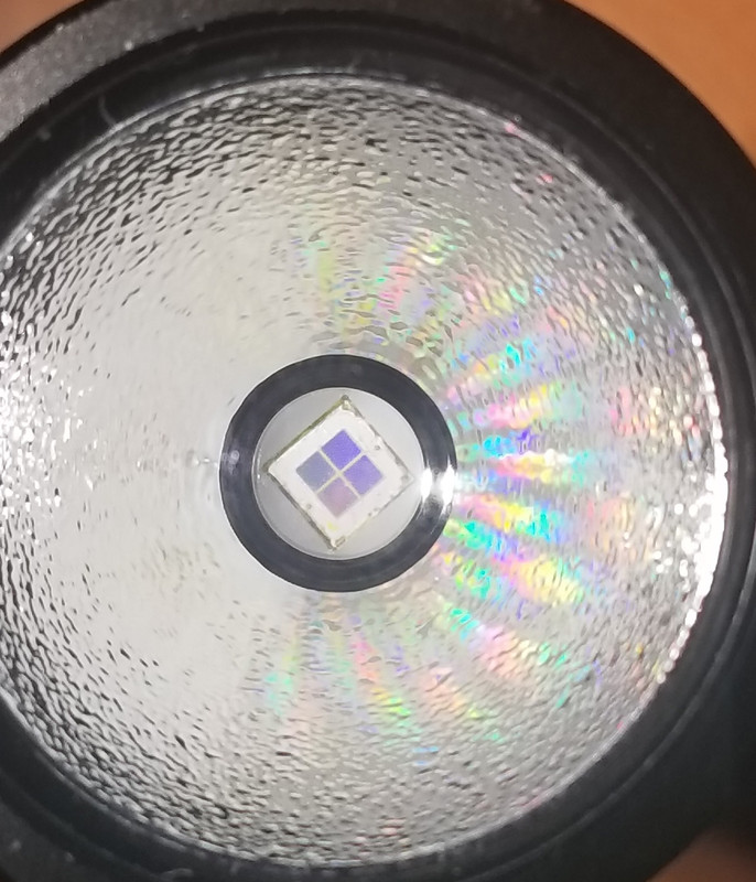

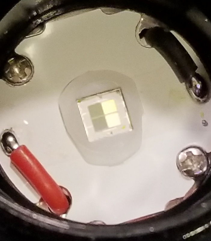

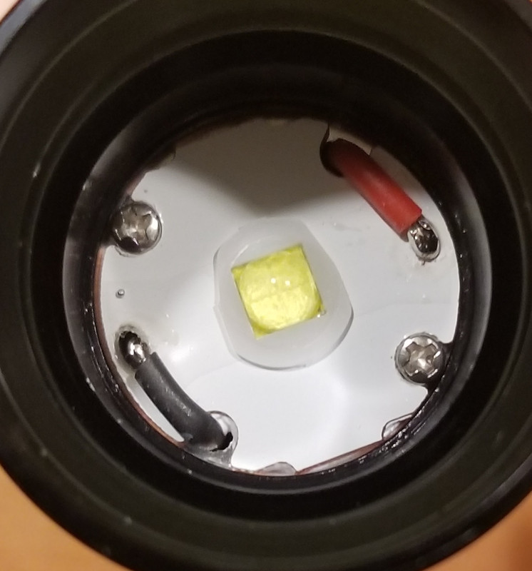

So next step looked quite obvious: let’s disassemble the light, replace the emitter with 3000K XHP50.2 and be happy ever after.
Unfortunately Sofirn has made some some further changes along with the step-down timer removal.
