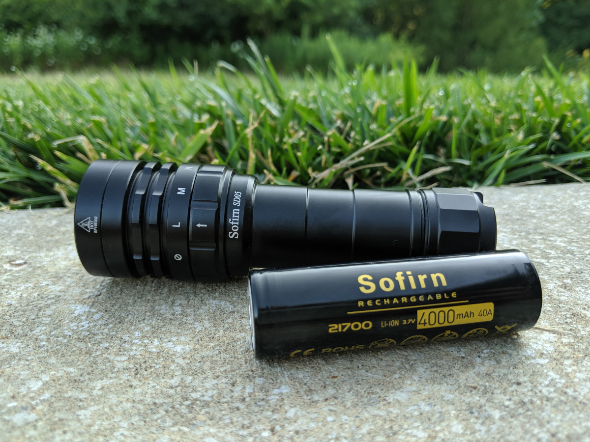

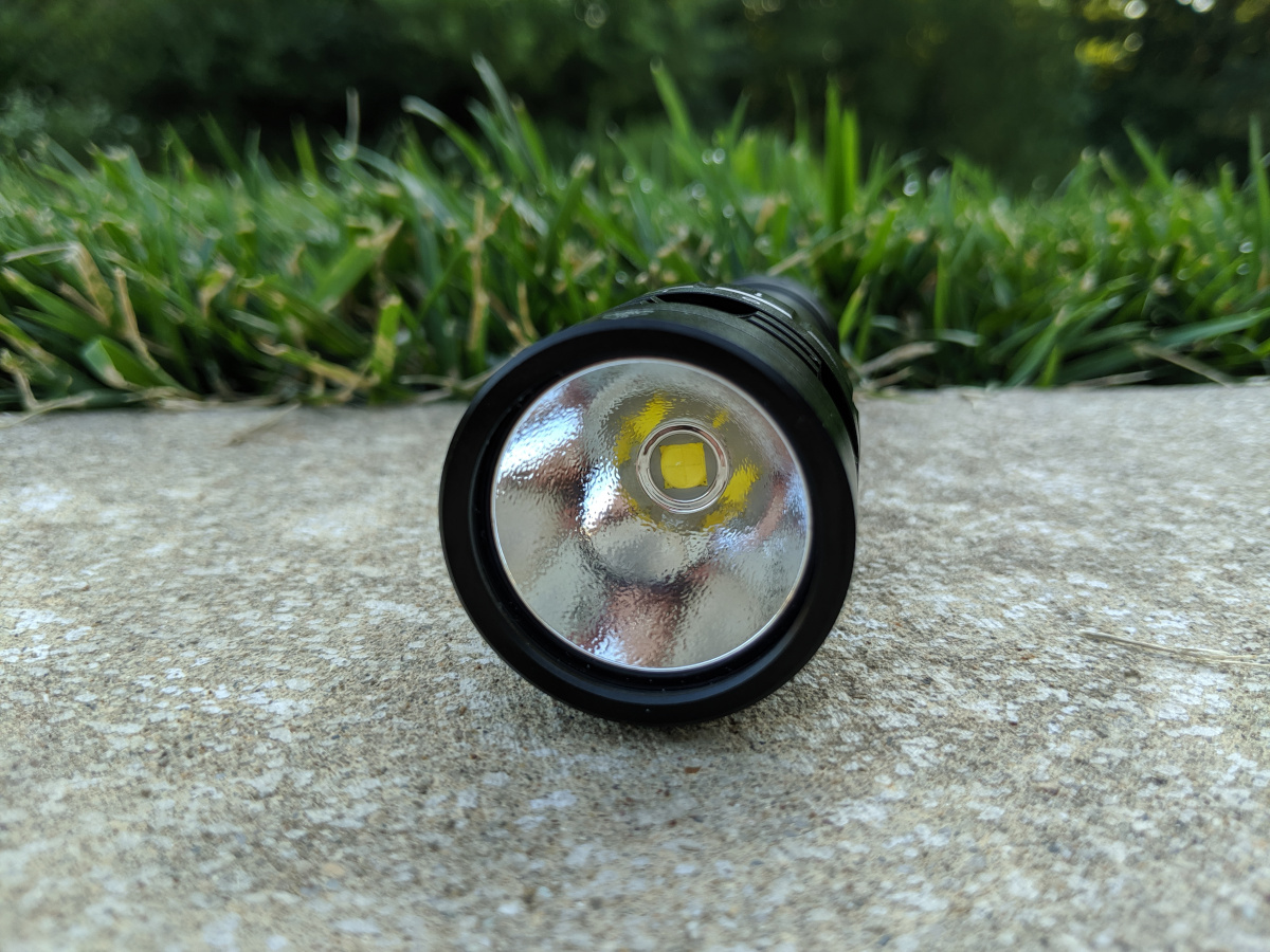

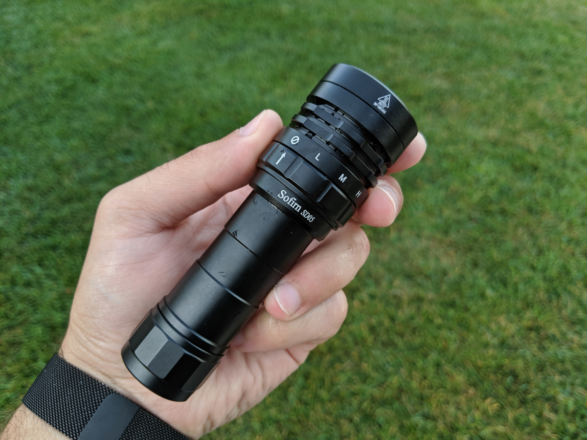

The Sofirn SD05 is a new diving flashlight, powered by a 21700 battery. It uses a neutral-ish Cree XHP50.2 LED. It has 3 brightness levels controlled by a magnetic ring around the head.
Fit & Finish:

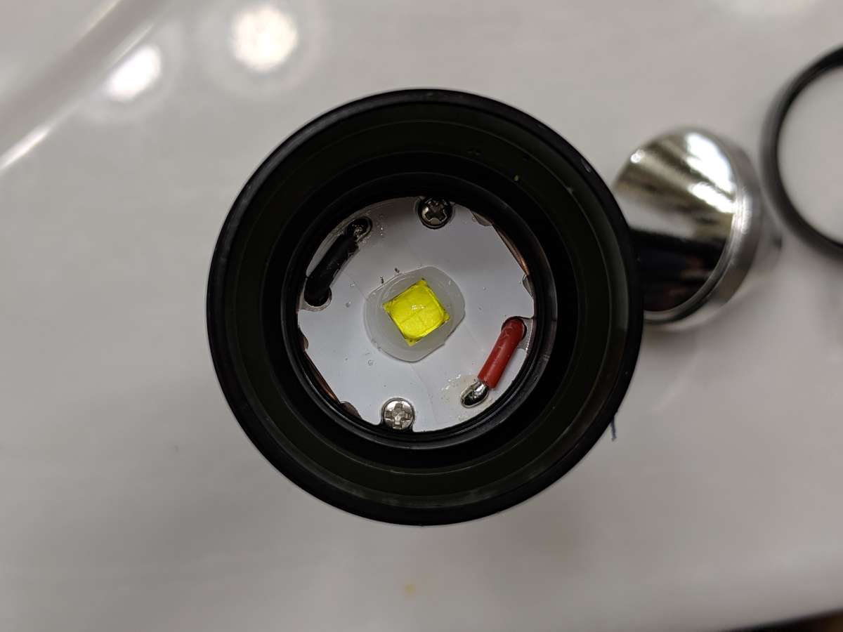

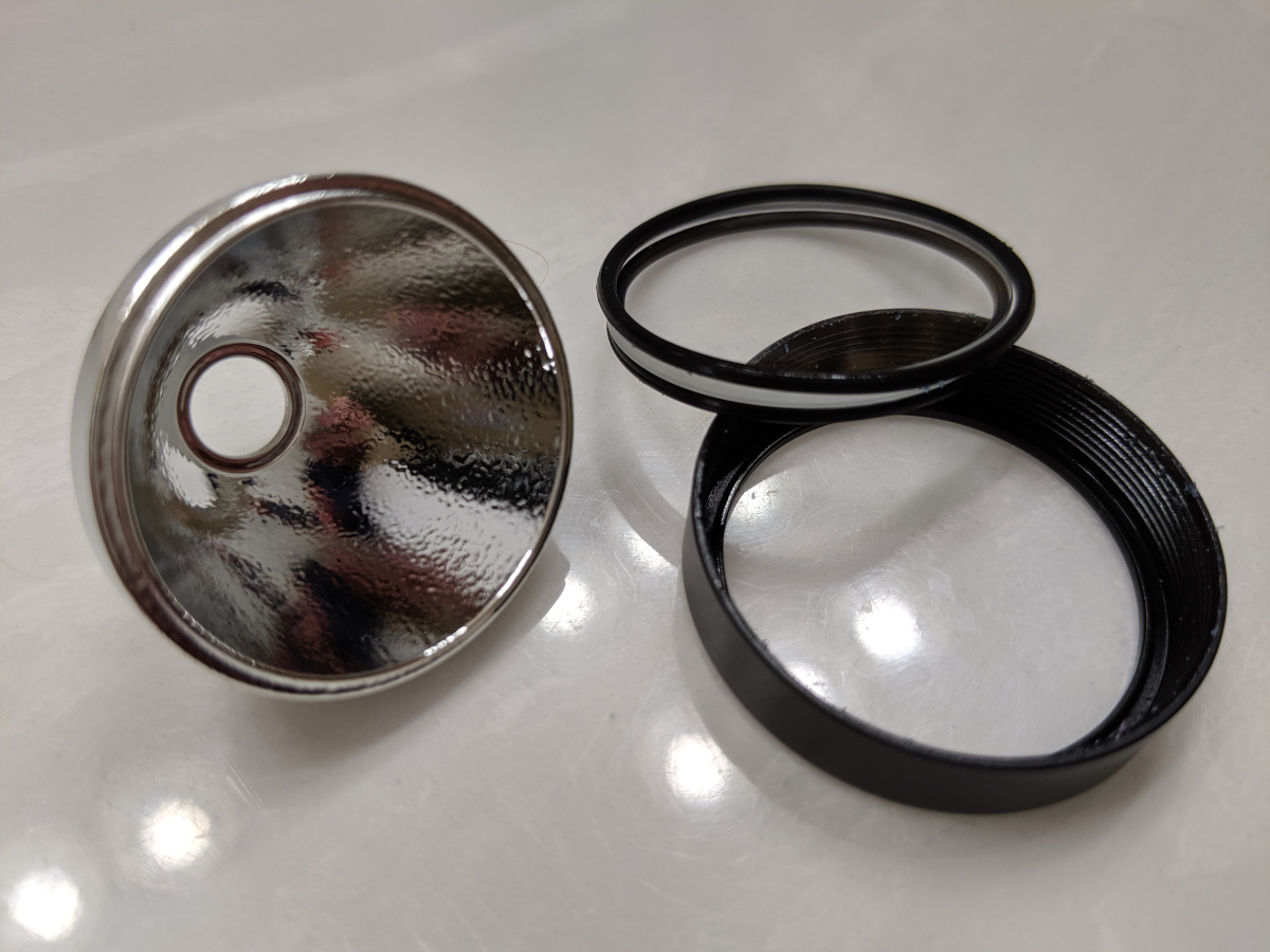

The quality of the SD05 is great. The anodizing is has a nice, satin feel to it. It has a good solid heft to it. The threads are square and smooth. The battery tube appears to be glued to the head. The bezel is glued on, which I removed for the sake of investigation (I warmed it up a bit and twisted hard with a rubber grippy pad). The glass is thick and has o-rings on both sides. The magnetic control ring is easy to use and has very definite “clicks” for each of the three modes (plus off).

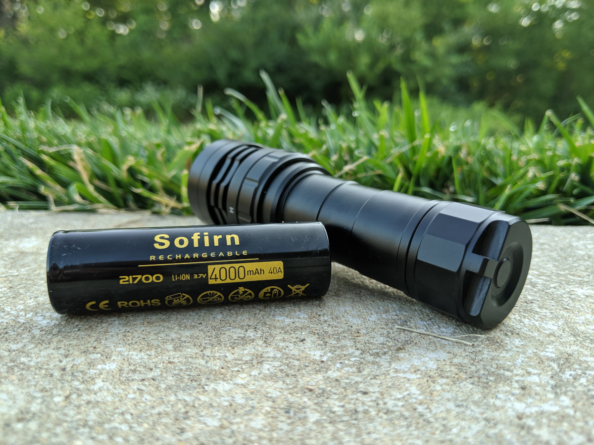

This came packaged in a relatively plain cardboard box, but contained everything you’d need to run it: the flashlight, a Sofirn-branded 4000mAh 21700 battery, and a USB charger and cable. It’s a basic charger, but it works just fine. Overall, a great kit for the price that Sofirn is asking.

And here’s a couple head shots after breaking through the blue threadlocker:
