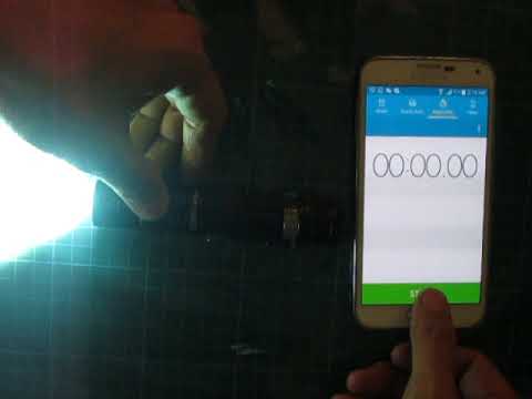

Using my “shine light thru small portable fan blade” method, I do not detect PWM on the SP32A v2.0 (using this method, the SP32A v1 shows PWM on any mode other than Turbo). So no detectable PWM whether in the groups mode or the ramping mode. I wished the lowest brightness would be around 1 (or 2) lumens. As for now, 5 lumens seems a bit bright to qualify as “Moon”. The SP32A v1, in ramping mode, has probably 1-2 lumens in lowest brightness.
Ramping speed: compared to v1 (new batch), it seems the SP32A (newer batch “v1.1”) ramps slightly faster from low to high (about 3.5-4 seconds). The SP32A v2.0 ramp speed seems to be about 4.5-5.0seconds from low-to-high, at least on the unit I got.
Got my lights yesterday…. champagne and silver colour.
my champagne colour had a mark }P
havent play around much but if the ramping is more than 4 seconds then it’s slow for my taste. Im so use to ramping 3 seconds Narsil firmware.
It’s a nice light and i love it for the price.
Does the v1.1 have the pause in the middle?
Yeah, I counted to “5 chimpanzee” for the v2, so that sounds about right.
Yes the v1 old & new batch have the very short pause in the middle.
I made videos before showing the ramping behavior, though I don’t think my camera was able to capture the very short pause in the middle.
SP32A v1 old batch
https://www.youtube.com/watch?v=WBRqPHYRSfA
SP32A v1 new batch
https://www.youtube.com/watch?v=uEXqfiexzrE
