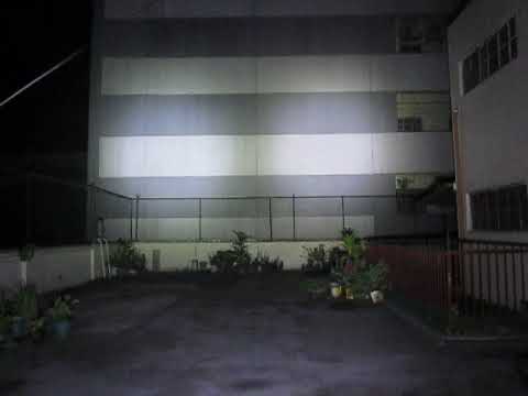

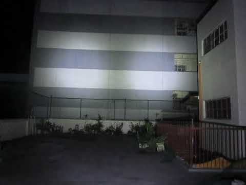

LED and optics:
In focus of an orange peel reflector is a cold white XHP50.2. This LED is known for its colorful beam. A white center sourround with rings from yellow to blue. It doesn’t matter really when used outside.
I own two lights with XHP50.2 and one with a XHP50. Among the former there’s a Convoy C8 equipped with BLF A6 driver and OPR, so all lights are quite copmpareable with the Olight R50 the light with the widest spill and the C8 the light with the most narrow spill.
To measure lumens, the lights are directed towards the walls in my white bathroom while measuring reflections from the ceiling. I think this is a precise enough method to at least compare different flashlights. I take it the Olight R50 realistically emits 2500 lm and so is used as a standard. Range was measured via direct measurment of brightness at 4m distance.
| lumen | range | |
| Sofirn SP33V3.0 | 3578 lm | 339 m |
| Olight R50 | 2500 lm | 306 m |
| Convoy C8 | 2730 lm | 418 m |
While it seems the Olight R50 is aging, it is still a light with an extraordinary wide spill. Excellent seeker light. But this is not really useful for general purpose application and especially it easily blinds oncoming people even when targeted to the floor. That’s where the Sofirn play its cards. It is bright, has a useful spill larger than a C8, but limited enough to not lose control about not blinding other people. Nice for walking the dog as well as for scanning your property. It’s a general purpose light.
