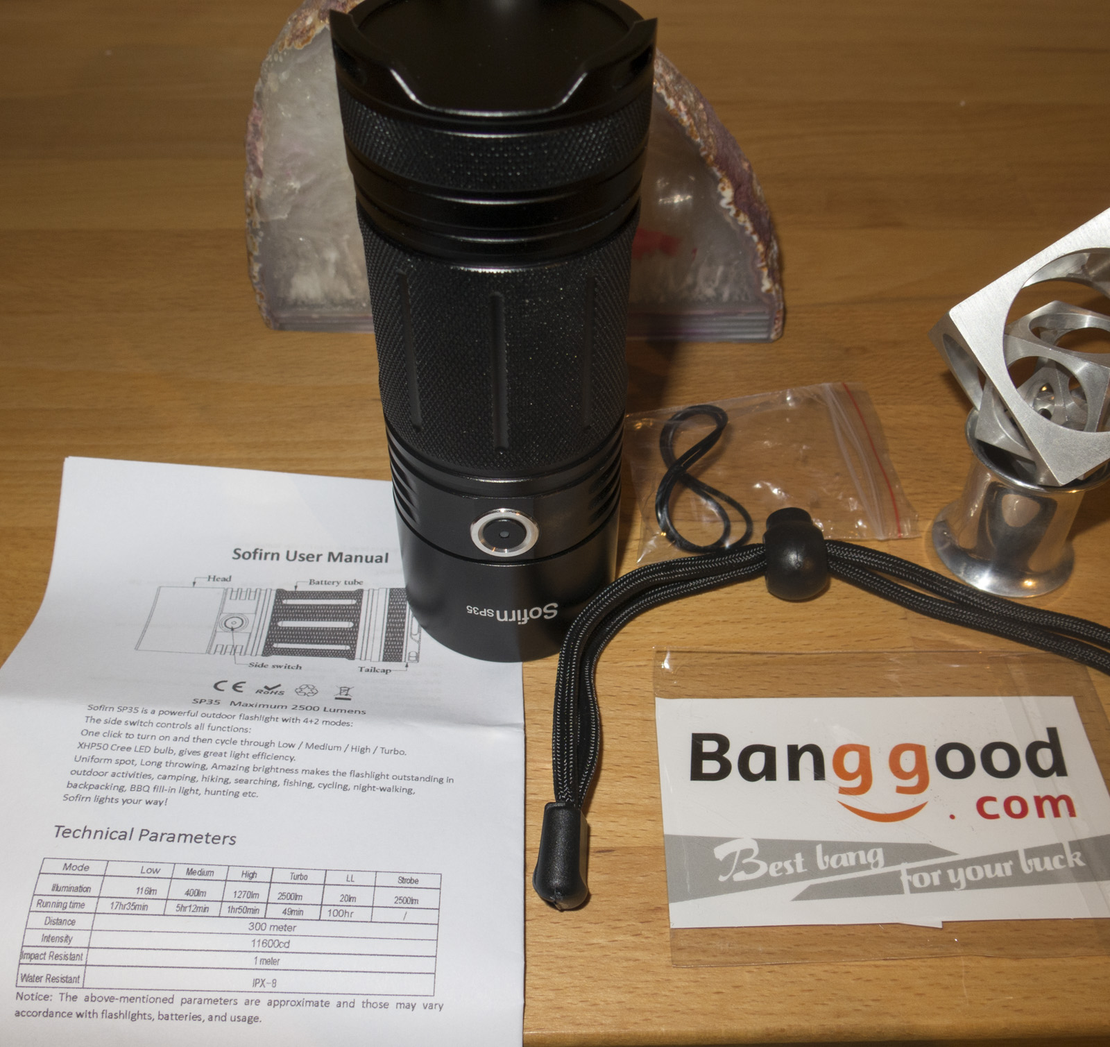

Manufactory specification:
Product name: Sofirn SP35 XHP50 2500Lumens Powerful Outdoor LED Flashlight
Brand: Sofirn
Model: SP35
Emitter Type: XHP50
Light temperature: 5500K-6000K
Light color: NW (Neutral White)
Material: Aircraft 6061 grade-aluminum alloy
Mode: Low, Mid, High, Turbo, Ultralow, Strobe
Lumens: 116LM,400LM,1270LM,2500LM,20LM,2500LM
Runtime: 17h35min,5h12min,1h50min,49min,100h,/
Battery Configurations: 3 x 18650 lithium-ion Battery(not included)
Working voltage: 8.4-12.6 Volts
Switch Type: Clicky
Switch Location: Body side of the flashlight
Peak Beam Intensity: 11600cd
Impact Resistant 1meter
Max Output: 2500lumens
Range: 300meters
Lens: Toughened glass lens with AR coating, anti-crash and wearable
Reflector: Smooth Reflector
Waterproof: IPX-8 waterproof
Color: Black
Weight: 307.6 gram (no batteries included)
Size: 131mm(length)× 48mm(diameter) × 48mm(head)
Package included:
1 x Sofirn SP35 XHP50 2500Lumens Powerful Outdoor LED Flashlight
1 x O-rings
1 x Lanyard
1 x English Manual

Package and content:
The lights box came packed well with a wrap around and in a plastic bag, typical for Banggood
the box took some light damage during transport, but the light itself was well protected
The light comes in a Box, the light itself is in bubble wrap
It comes with 2 spare o-rings, lanyard and manual (german+english),
the german translation is bad from an online translator
Photos of the light

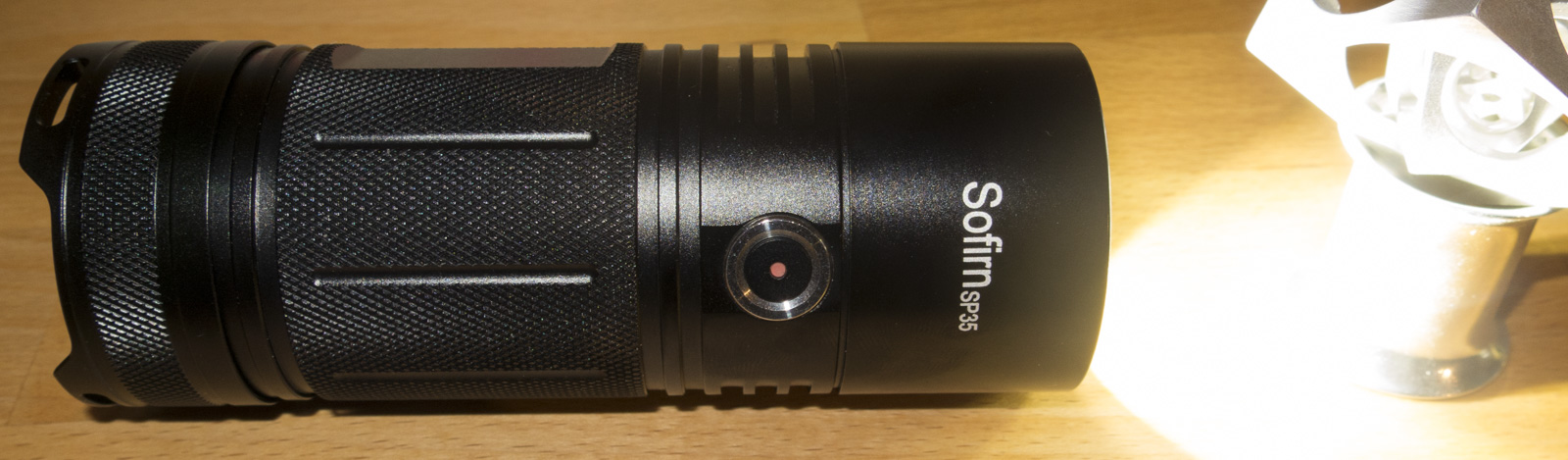

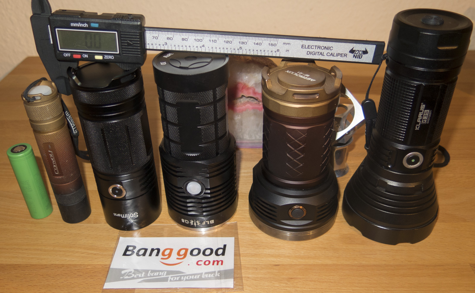

Size compared to other 18650 lights the SP35 the battery tube is quite thick for a 3x18650, 2.5mm thicker than the Klarus G35 and 2mm less than the BLF Q8
Beam color is cold around 6250K with a Cree XHP50, the beam is balanced between throw and spill

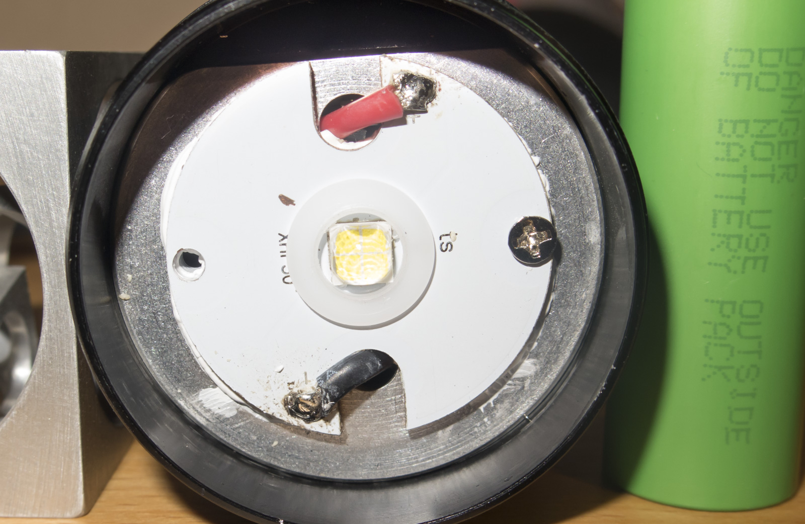

The LED is very good reflowed and the non DTP MCPCB is perfectly flat, but not polished or gold plated
The heat paste is applied in a good amount and squeezed in an uniform thin layer
The LED wires are really thick looks like AWG20

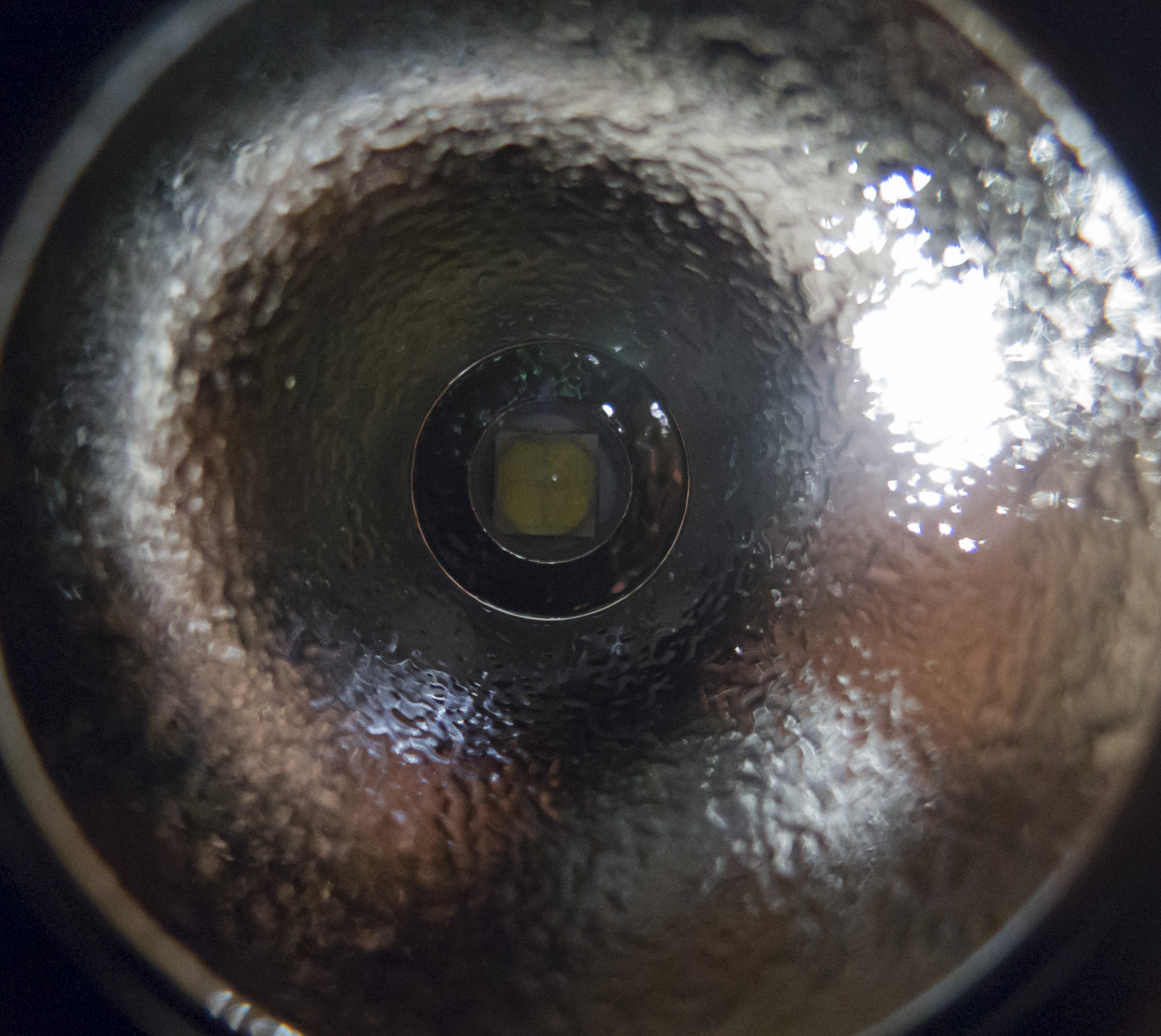

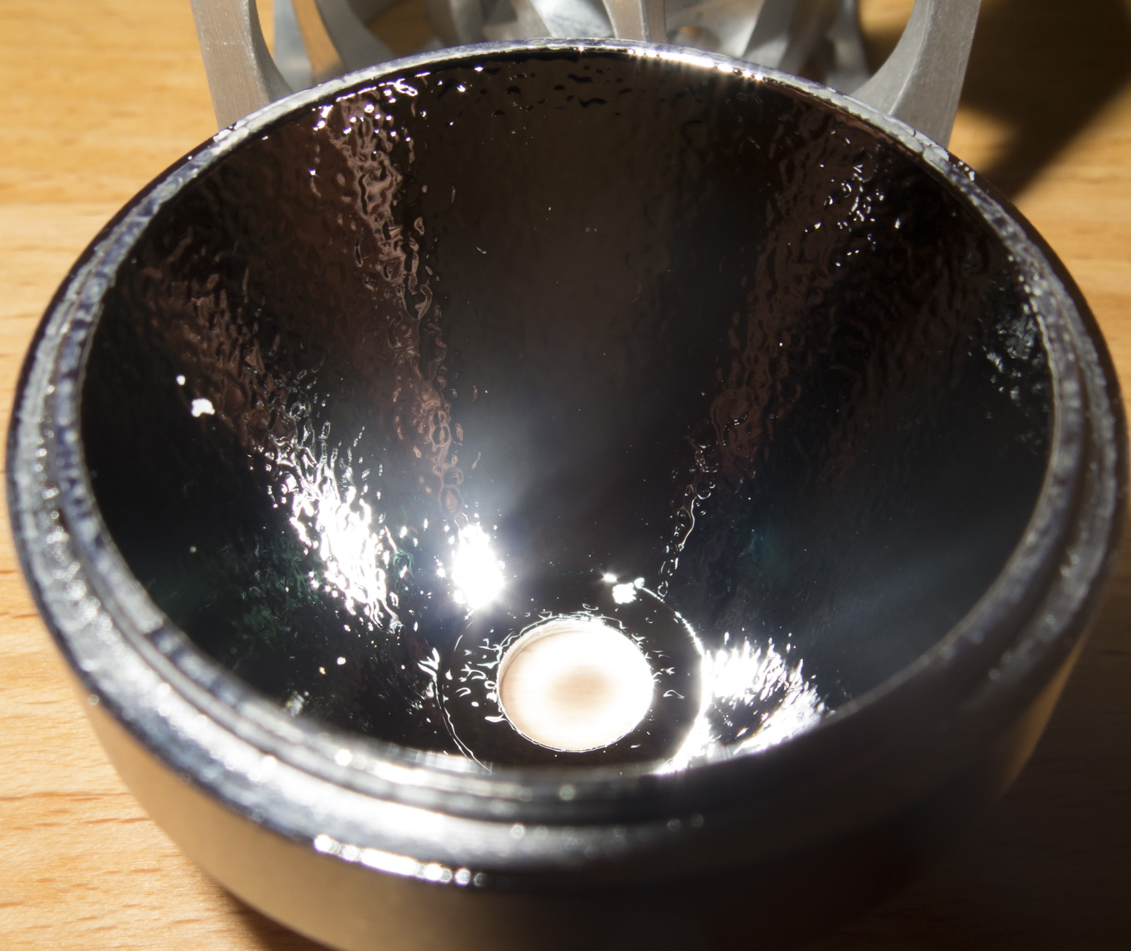

The reflector has a medium orange peel and there are some quite big white dust particles on it
They probably came from the gasket and could be removed with compressed air

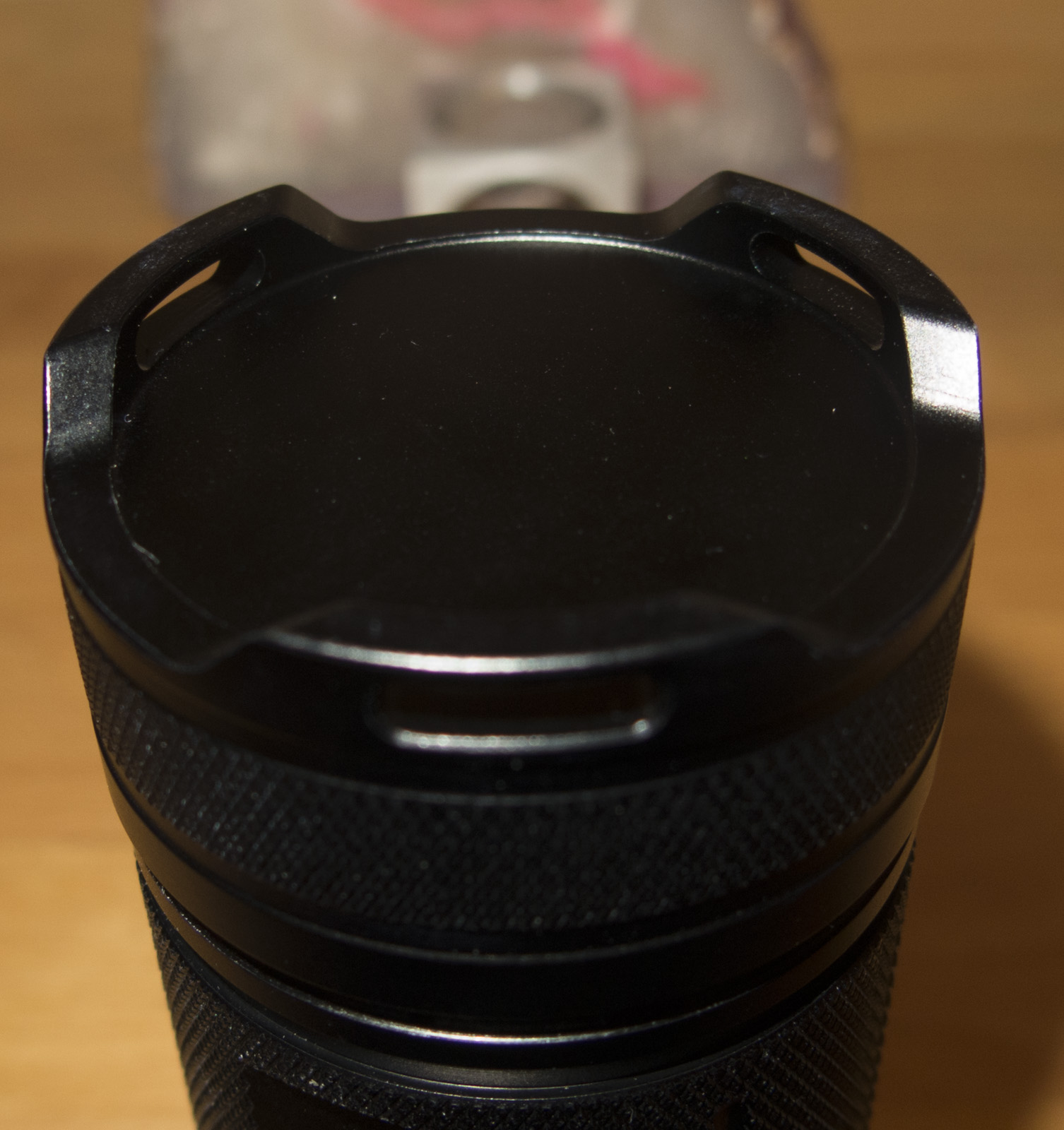

The light has a tail cap with 3 big holes for a lanyard and stands rock-solid
The light stands on the tail

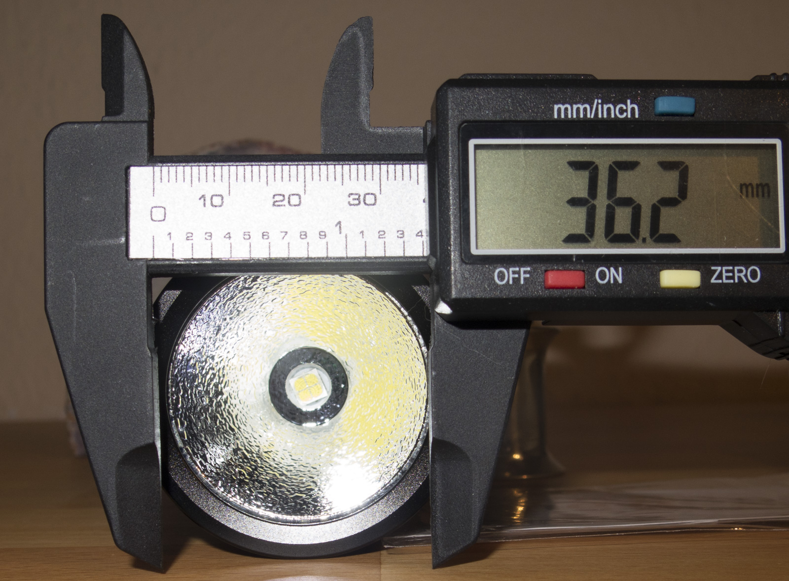

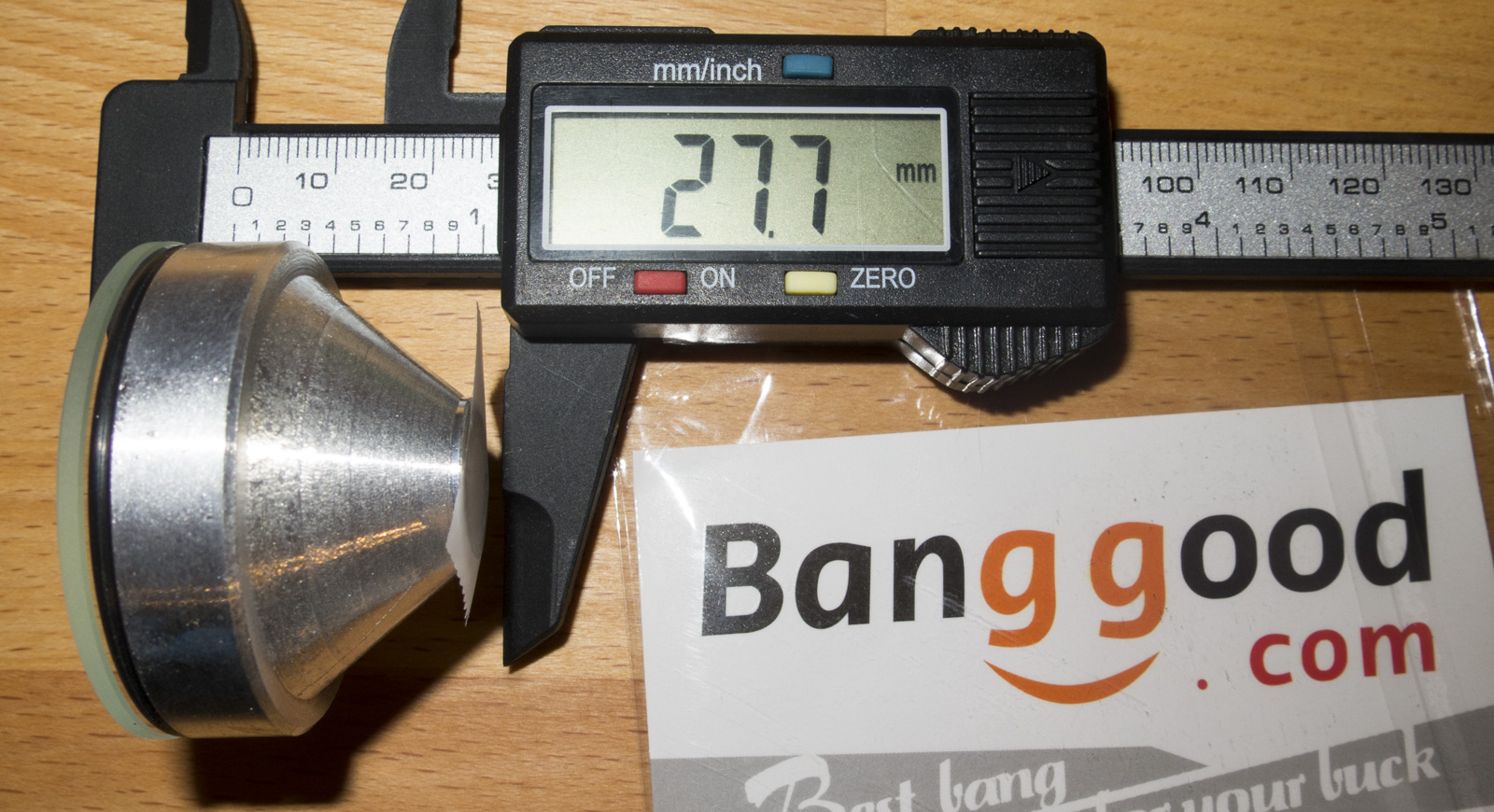

The lens is 43.5mm wide and 2mm thick, and AR coated, the coating is less good than most other lights I had so far, compared to Klarus G35 and uncoated BLF Q8
The head has a diameter of 48mm and 36.2mm visible reflector

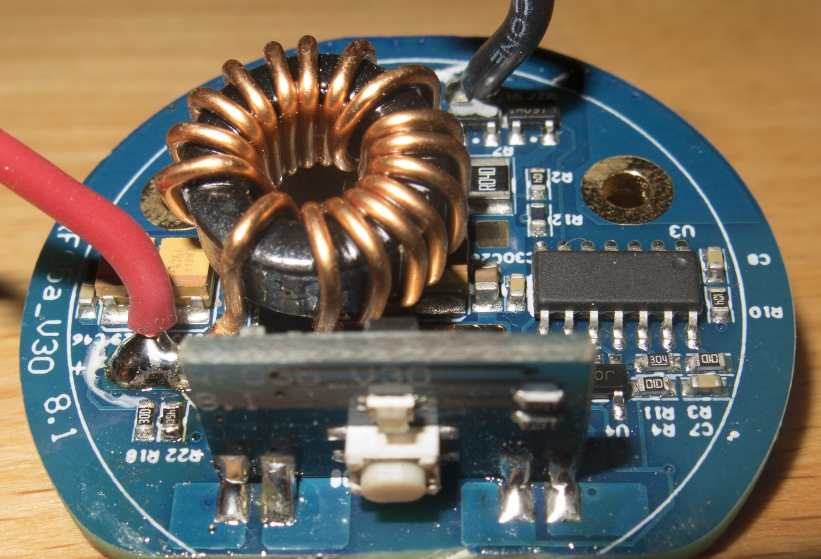

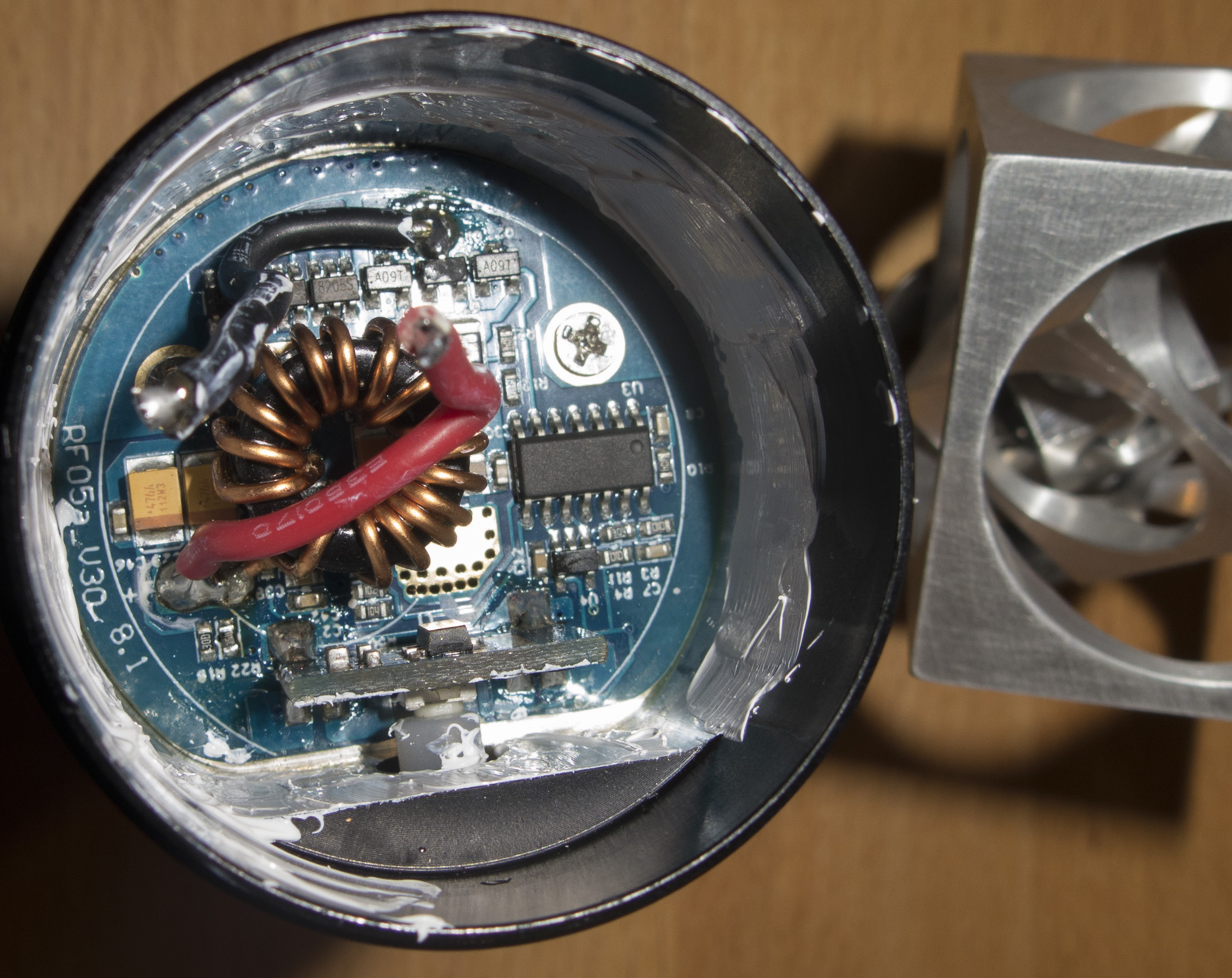

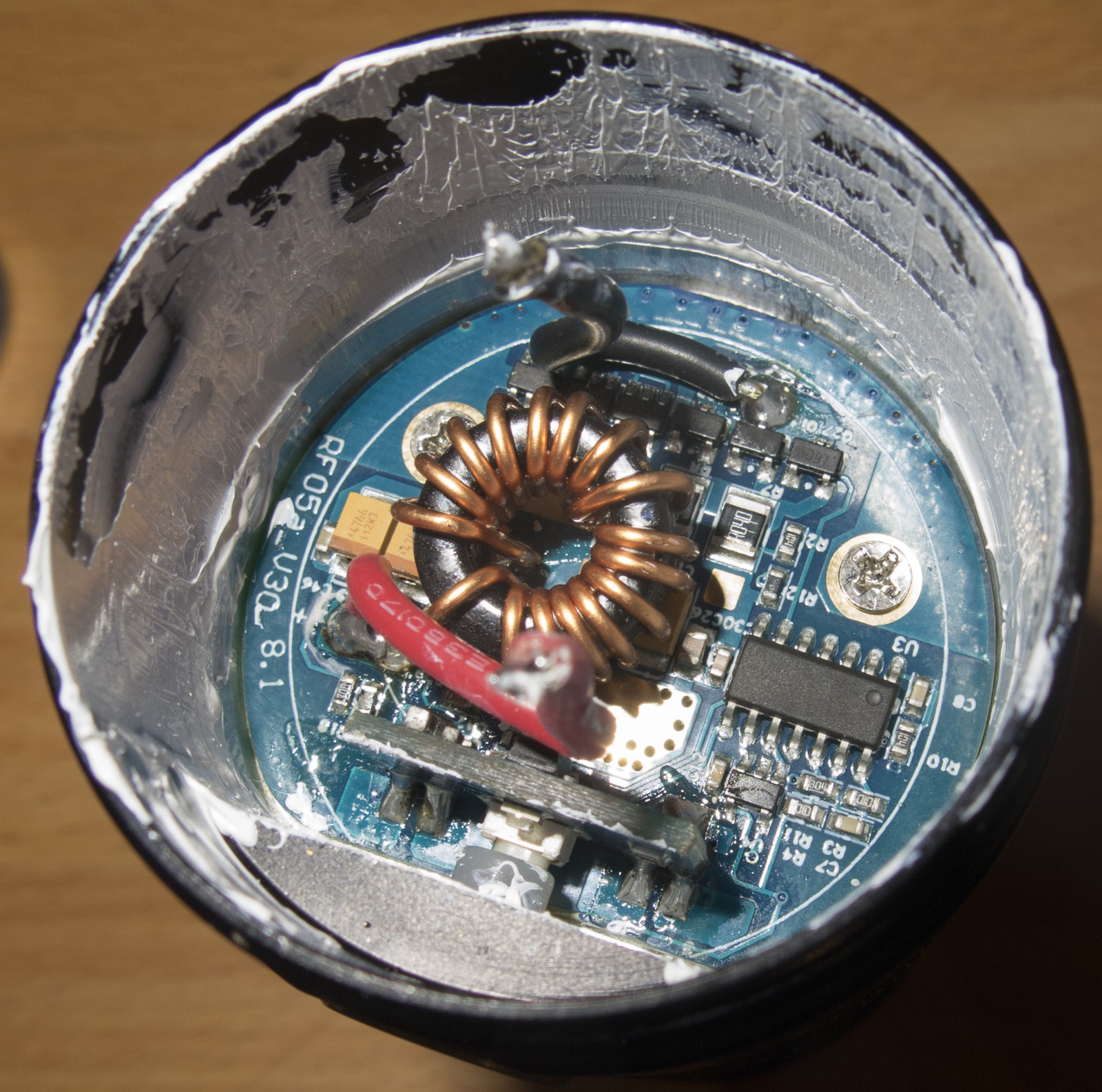

The driver sits below the LED shelf, the lights tube and head is one piece
The driver has a single coil on the driver and is fed by 3x18650 in series as a buck driver

The big reflector with a single LED gives a decent throw with a medium hotspot and enough spill due to the relative shallow reflector with 25.8mm
The lens rests on the reflector, while the O-ring sits in a cut on the reflector rim, this way the pressure on it is always the same

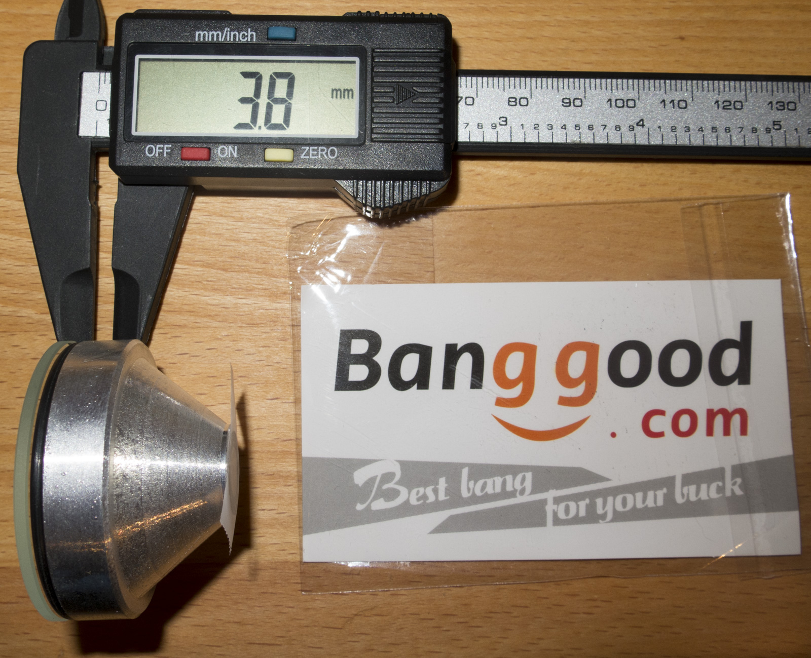

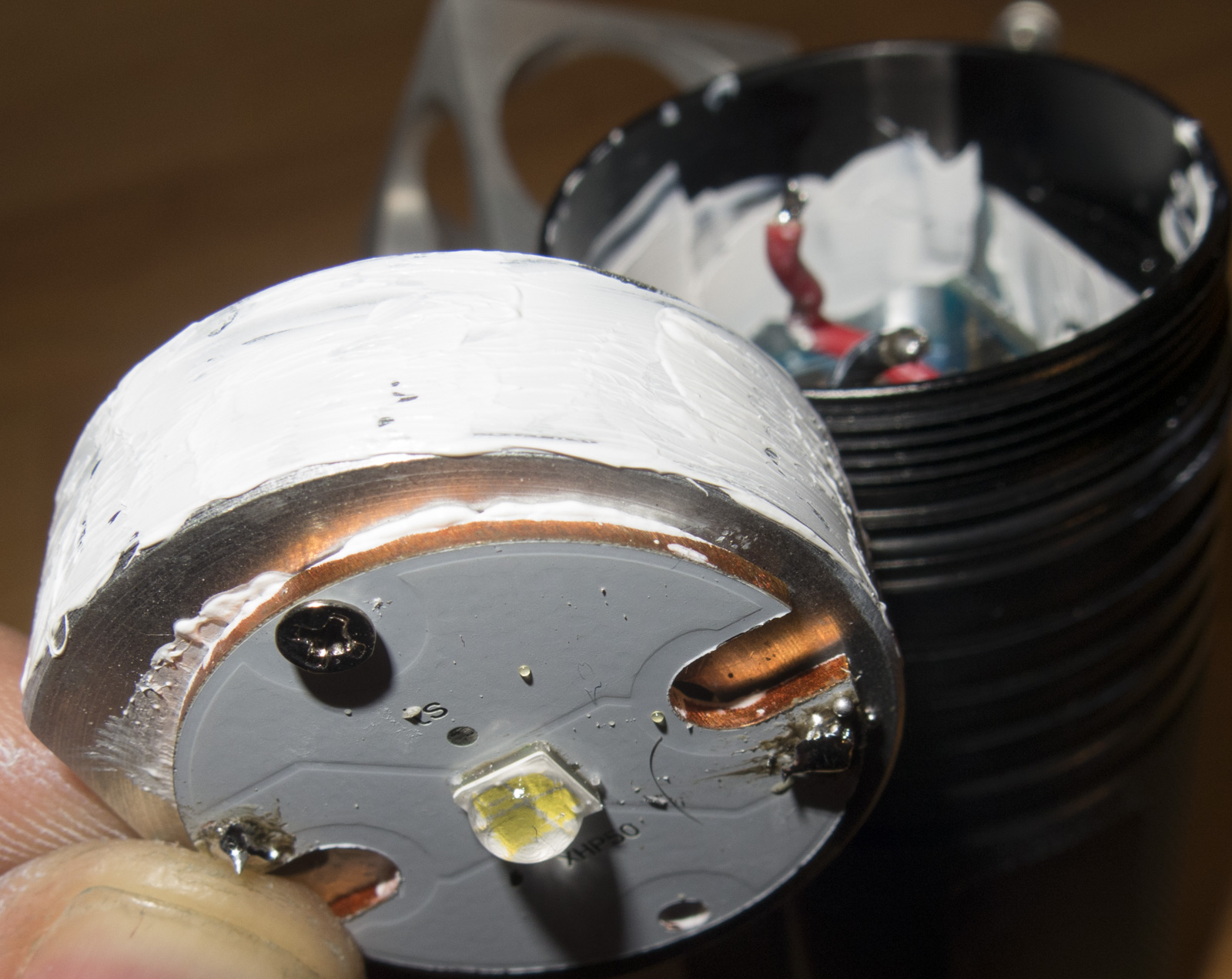

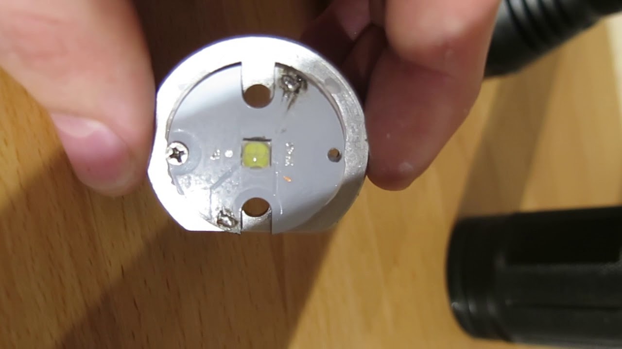

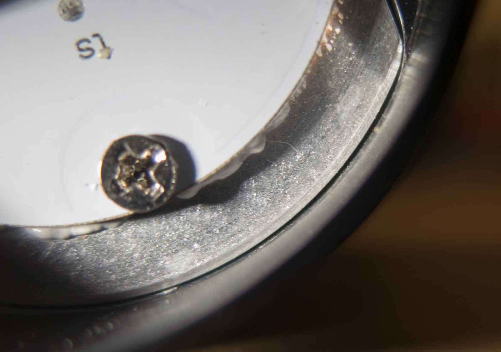

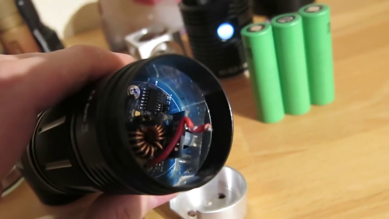

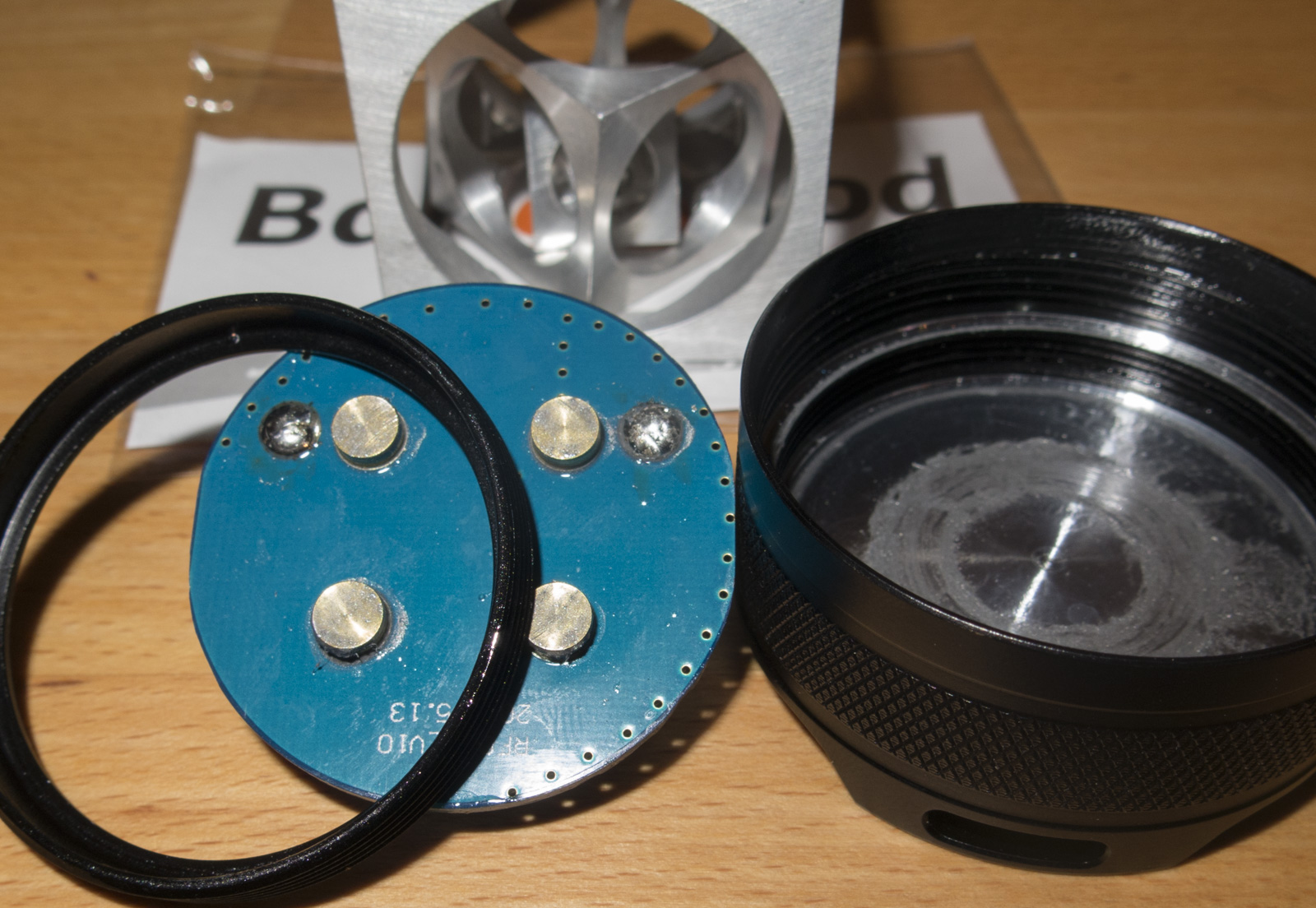

Now to biggest fail in this light, the floating shelf
I could not believe it, but the shelf just fell out of the head after I unsoldered the LED wires
It rests just on the driver board, to the body it has about 0.2mm space and just falls out
The Klarus G35 shelf I had to pull out with force and there were a lot marks where both surfaced had contact
The slave board for the switch has a green and red LED
The light indicates the battery capacity, green for >50, orange for 50-20 and below 20% red
The shelf is 1.5mm thick and a really big 1.5mm thick copper MCPCB does a good job spreading the heat to the shelf
The MCPCB is s not DTP, the back of it is bare copper
The MCPCBs back is perfectly flat

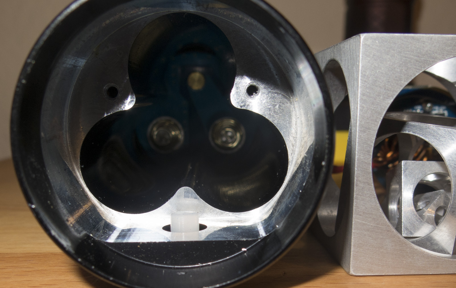

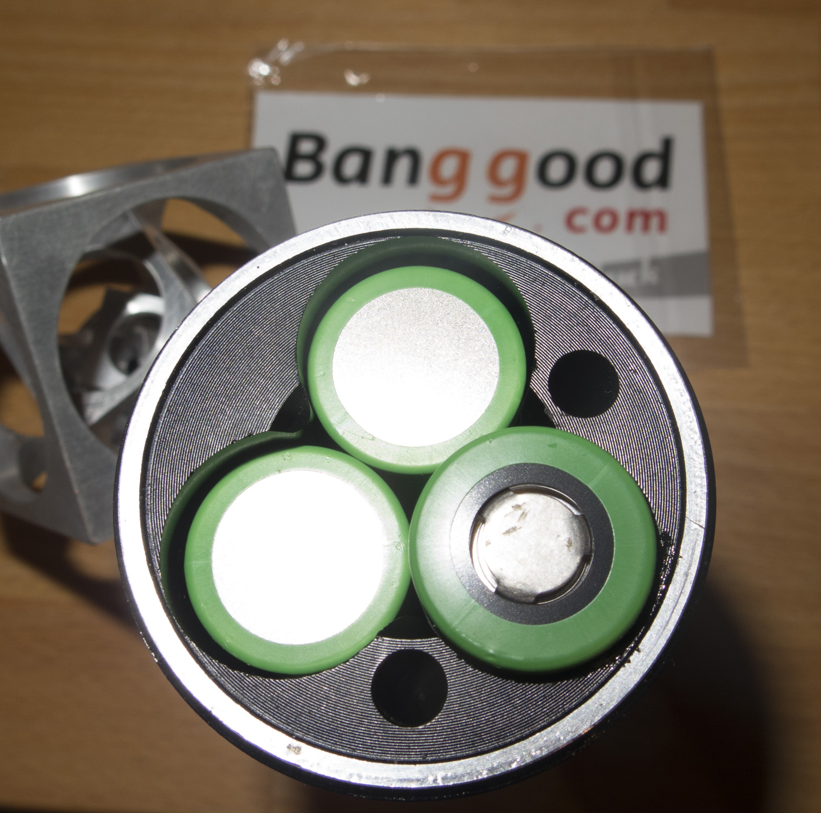

the tube is build for 3 batteries
with unprotected flat tops the spring force is low they easily rattle inside when you shake the light

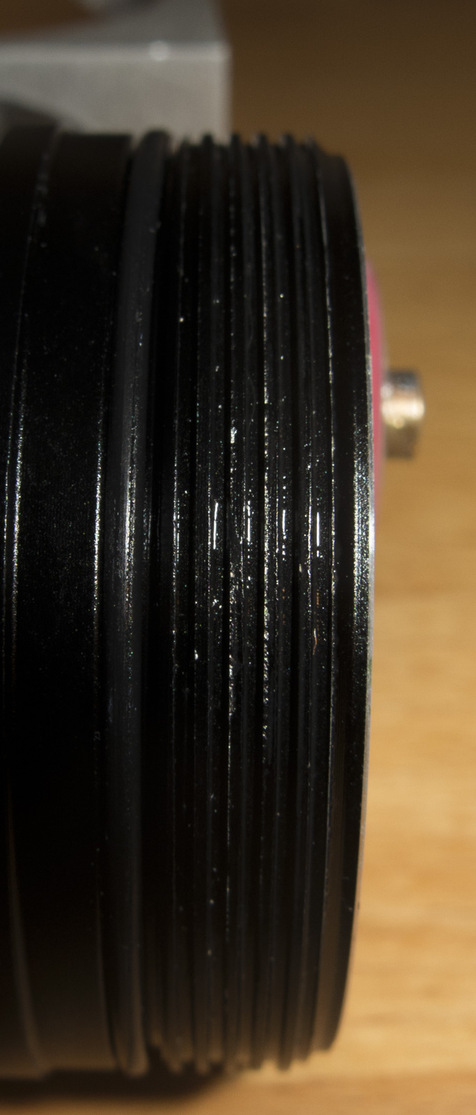

The tube threads are square cut and fit nicely, but they are a bit too small, when you don’t be careful you may damage them, best is to twist the threads with care to make sure they snap in at the right position
The tail cap has 3 big cut outs for the lanyard

The light is build for protected and unprotected batteries, unprotected are very loose and rattle

The light uses a boost driver and has some 0.4 Ohm sense resistors in parallel

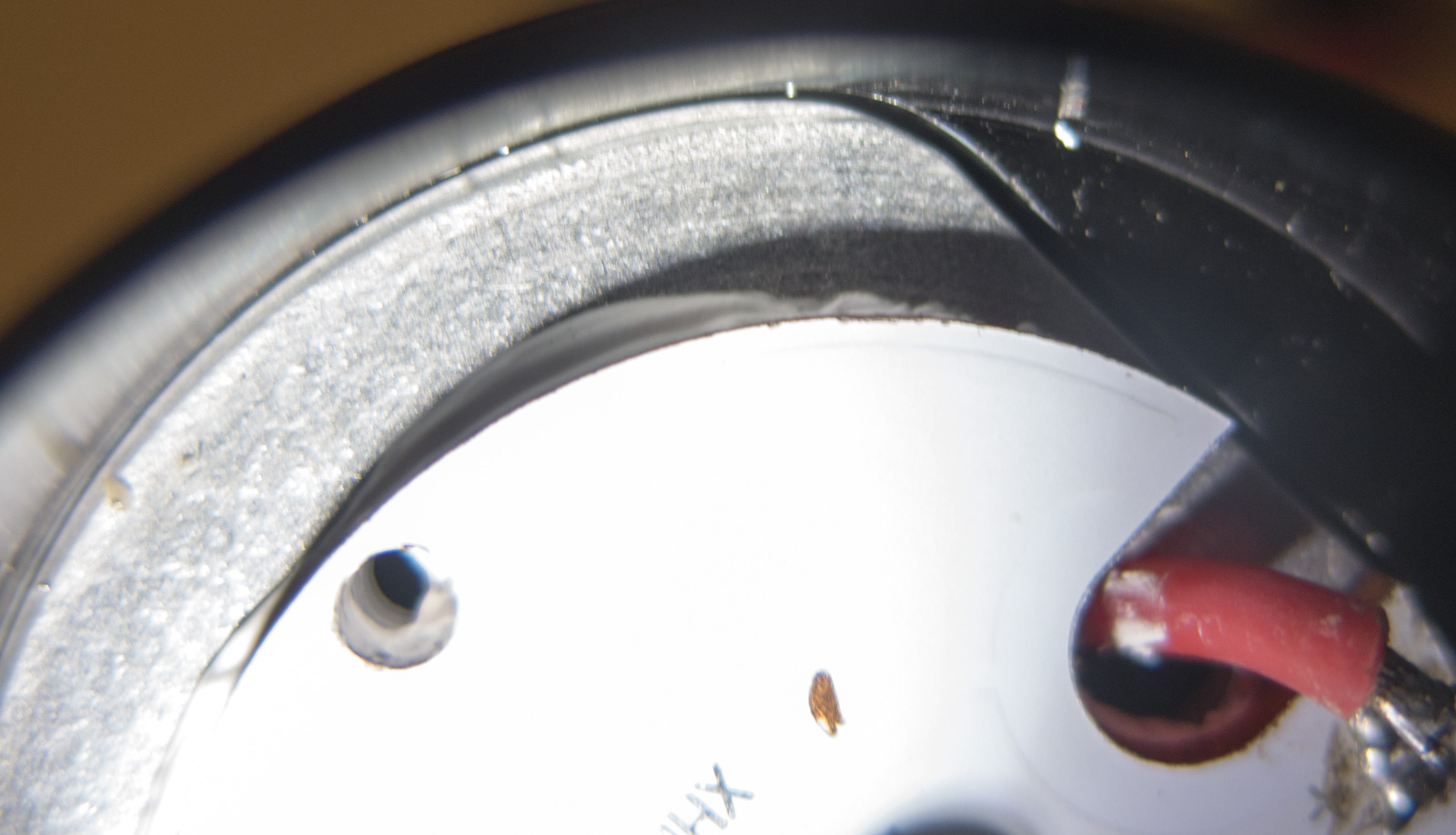

When I was reassembling the light the next bad thing happened, the LED wire came loose on the driver, a cold solder joint with very bad electrical and mechanical properties

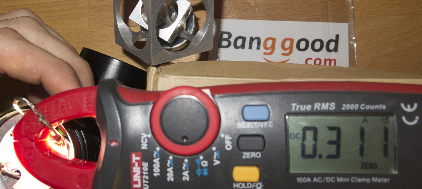

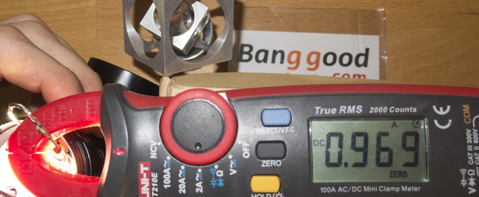

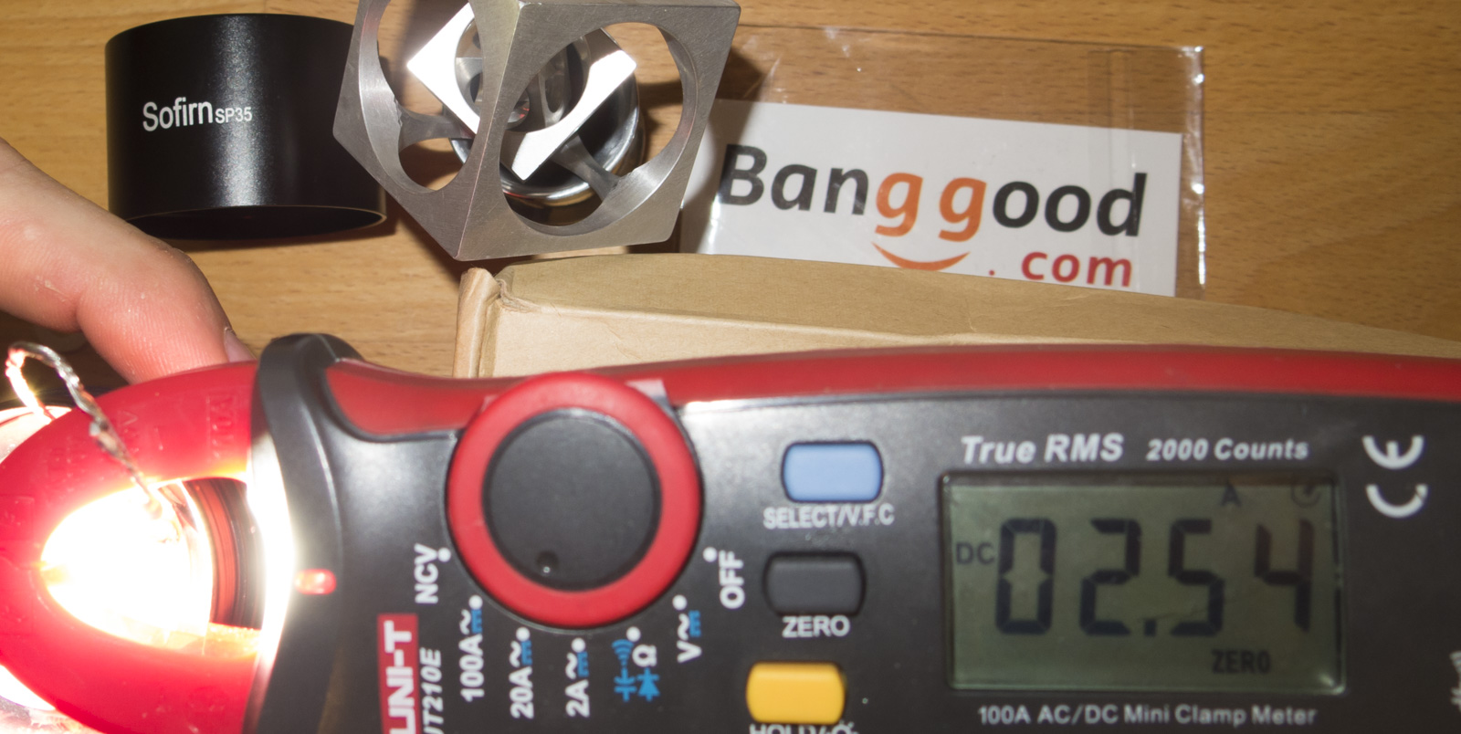

LED current and lux for the modes
The flashlight has a peak beam intensity of 945 lux @5M
so the calculated throw is 23625 this is more than double what is listed in the manual with 11600
theoretical throw distance 307m

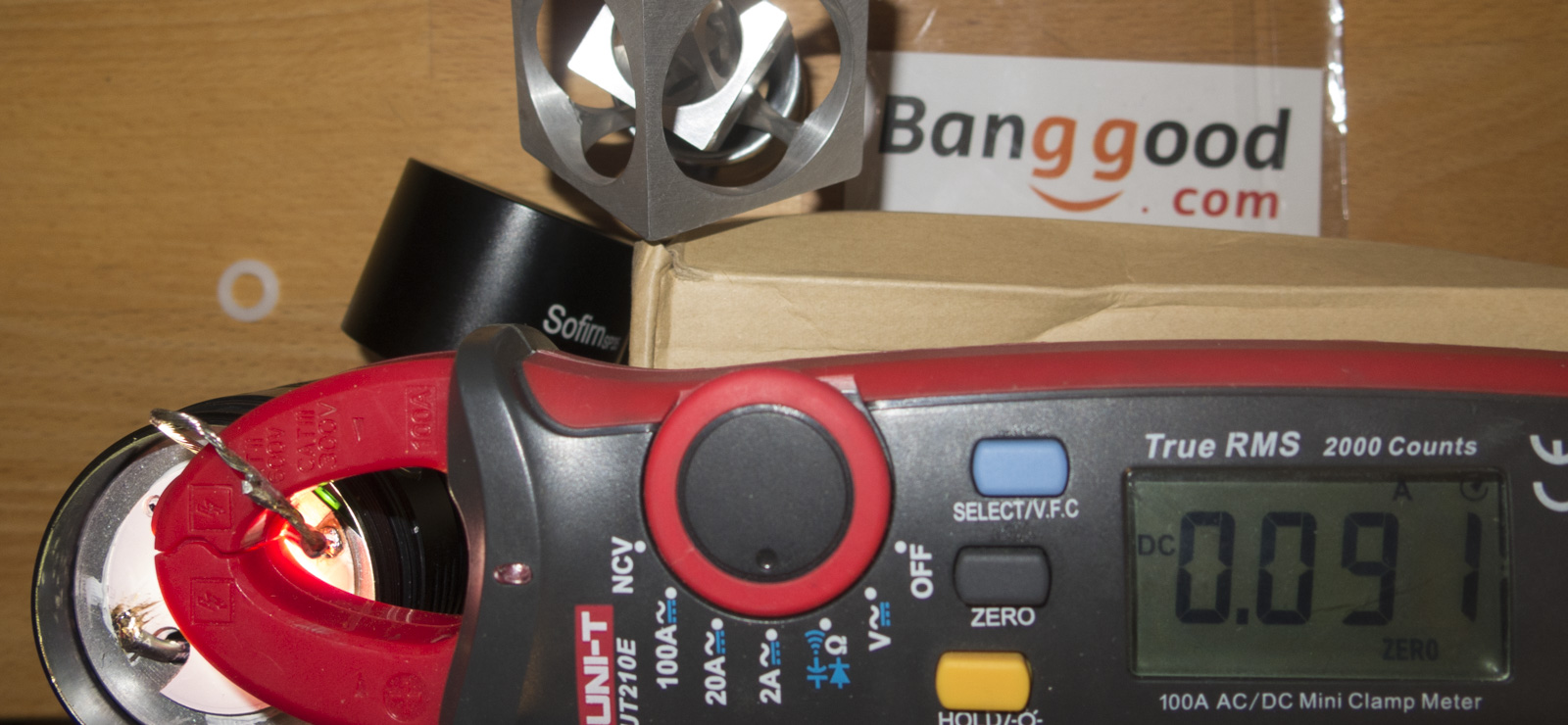

the moonlight about 15 lumens 200lux 0,85%
Low 90mA 825lux 3,5%
Medium 0,31A 3200lux 13,5%
High 0.97A 11400lux 48%
Turbo 2.54A 23625lux

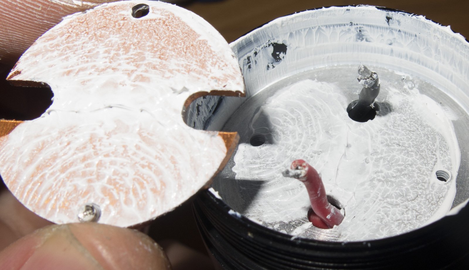

Modding:
First thing was to bypass the springs on the tail cap and driver
added thermal paste to the body so the shelf gets proper heat transfer and the LED stays cool
first apply paste to shelf and Body
Pushed the shelf in half way, realizing the one LED wire stuck, pulling it out again
used flat head screws

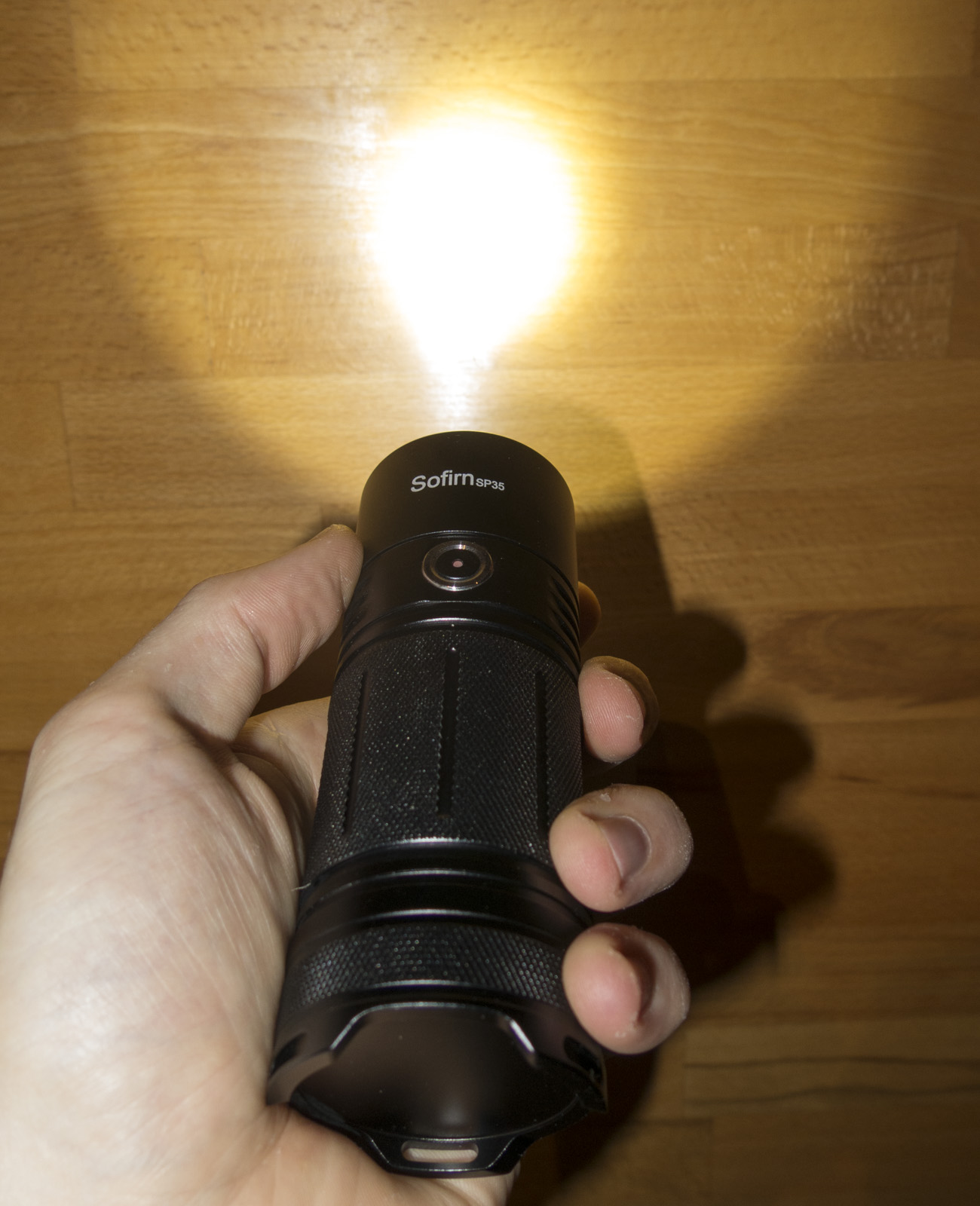

Beam shots
about 2m from Light to ceiling
Sofirn SP35
BLF Q8
Klarus XT12GT
Nitecore P12 XML U3-3D NW

A very bad move was to build in a not fitting shelf, the shelf and body are very nice machined, but they do not fit, maybe a error on the lathe or CNC, the shelf rattles with the bezel loosened and when tightened it again the shelf gets pressed against the driver

The driver is well build, but the current is too low to reach the claimed lumens 2.54A on 6.28V gets to 1900-2000 LED lumens from J4 or J4 flux bin

- I got a Monday light employee was to tired from weekend he forgot how to solder, so finally the LED wire had a cold solder joint that fell off after I disassembled the light
