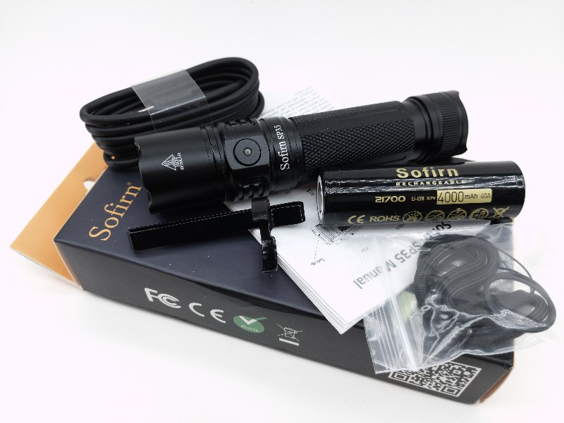

What’s inside the box:
* Sofirn SP35
* 4000 mAh 21700 battery
* Reversible pocket clip
* USB-A to USB-C charging cable
* Lanyard
* User manual
* Spare o-rings

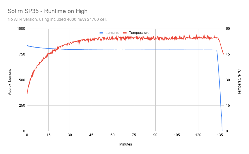

Runtime & Measurements

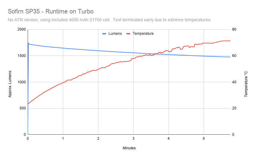

- In Turbo mode, it’s way too hot after 5 minutes
- In High mode, it hovered around 54°C
- Using a maukka calibrated lumen tube…
- Turbo spec is 2000 lumens, I saw 1740 lumens at 0 seconds and 1677 at 30 seconds
- High spec is 950 lumens for 3 hours and 40 minutes, I saw 840 lumens for 2 hours and 16 minutes
- Medium lumens: 357 (spec: 400)
- Low lumens: 114 (spec: 120)
- Eco lumens: 14 (spec: 7)
- Moon lumens: 0.4 (spec: 1)
- Throw spec: 27,520 cd for 332 meters
- Throw measured: 24,250 cd for 311 meters (pretty close to spec)
