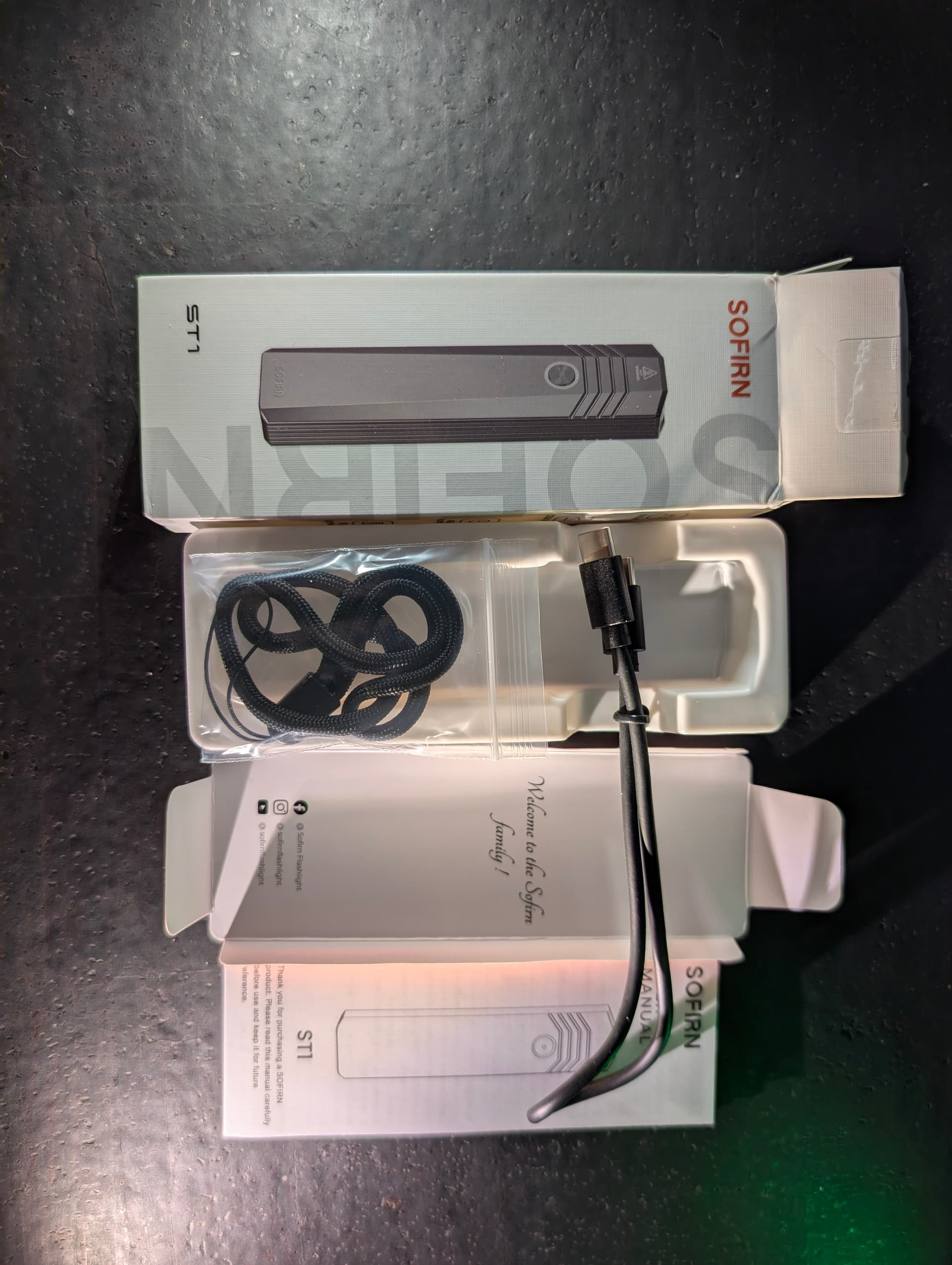

As always with Sofirn, the light comes in a small, white box, containing a lanyard and a USB-C cable in addition to the light.

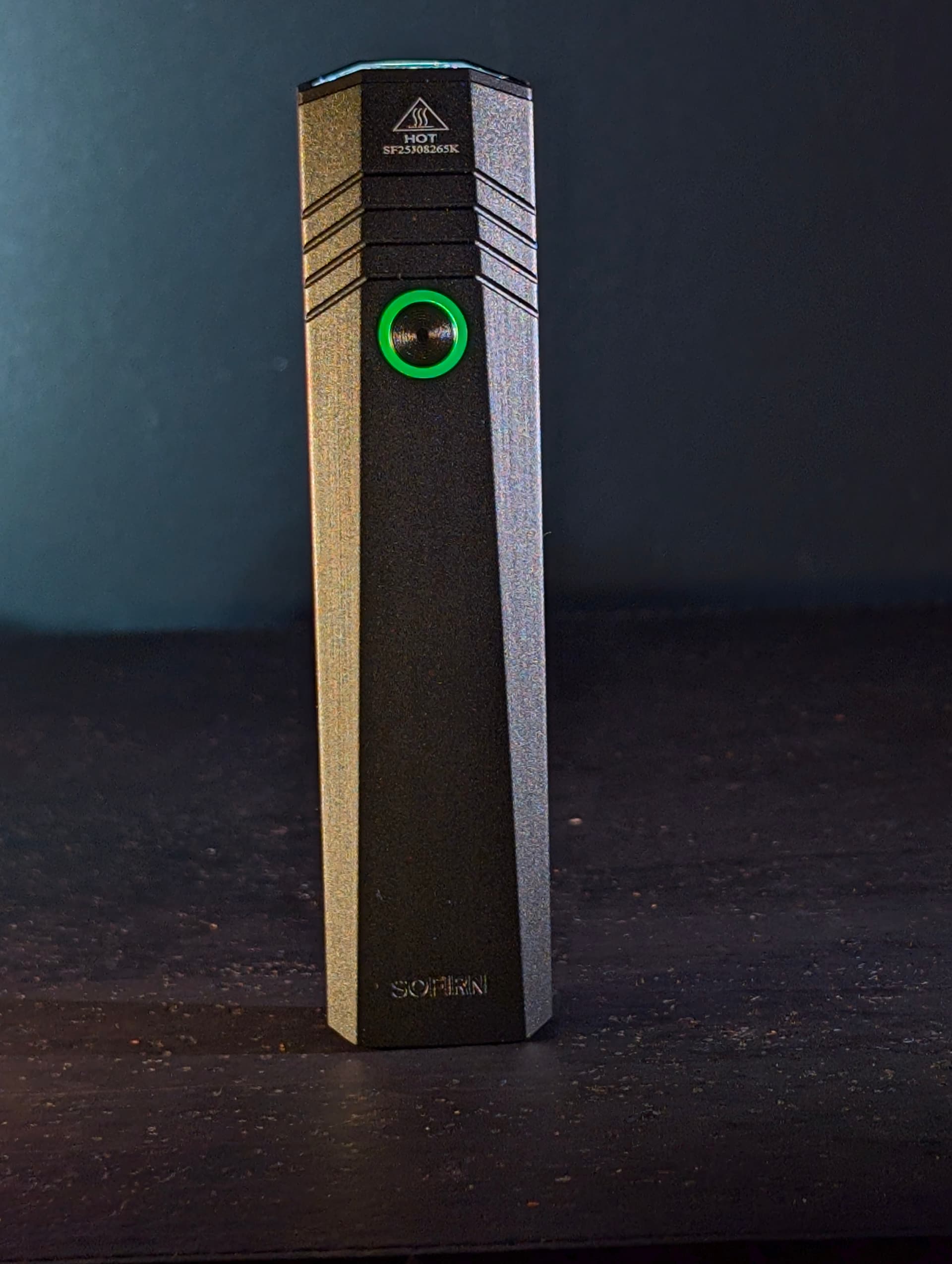

It’s sleek and a bit slippery, but fits my hand very well.

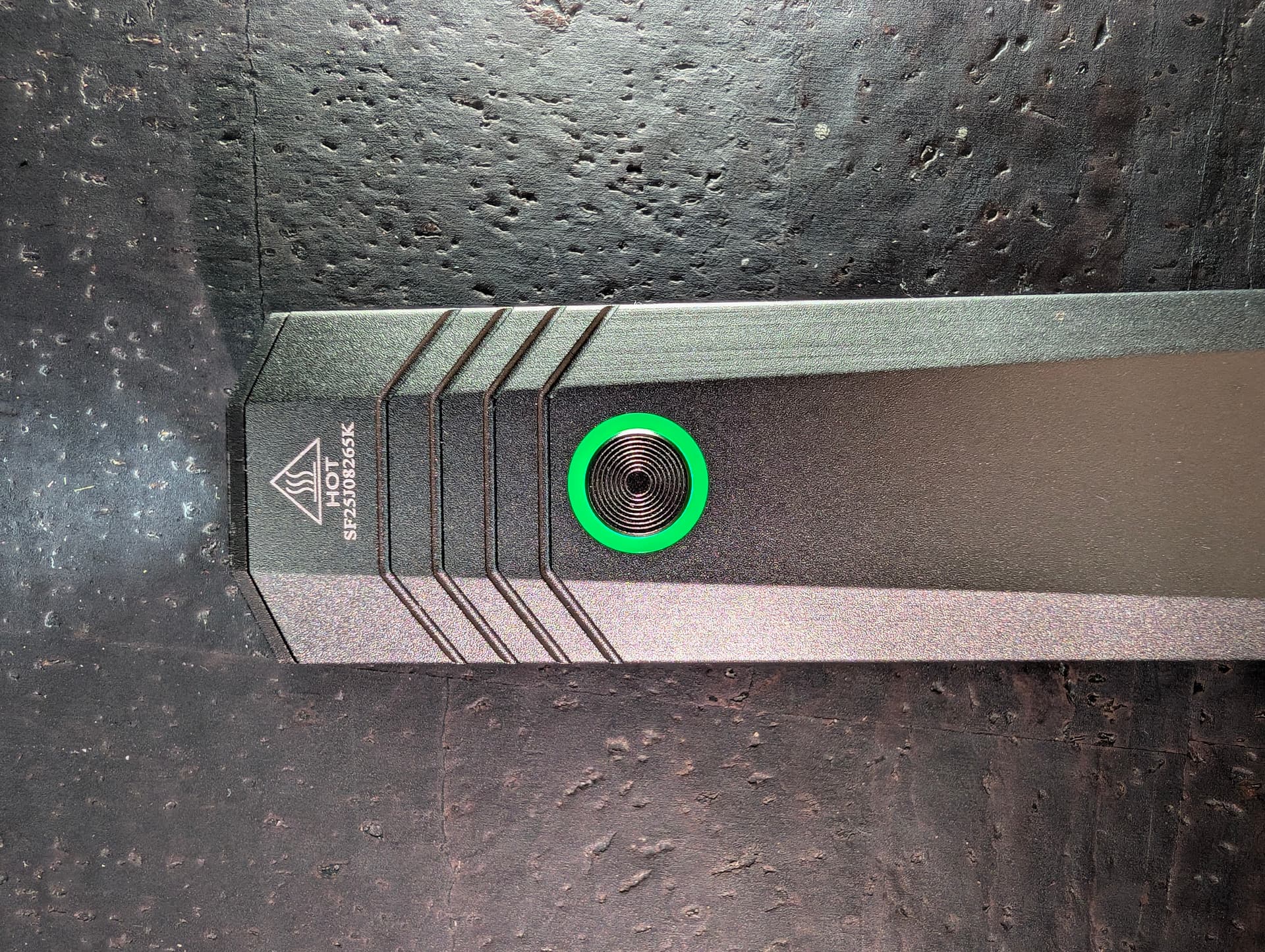

The button placement is good. The button itself is slightly protruding, but not too much. It’s nearly silent and has a good feel to it.
Around the button is a ring which works as battery and charging indicator
While charging, it is solid red and turn solid green when fully charged.
While discharging, green signals 100%-50%, orange 50%-10%, red 20%-20% and red breathing 10% and below.

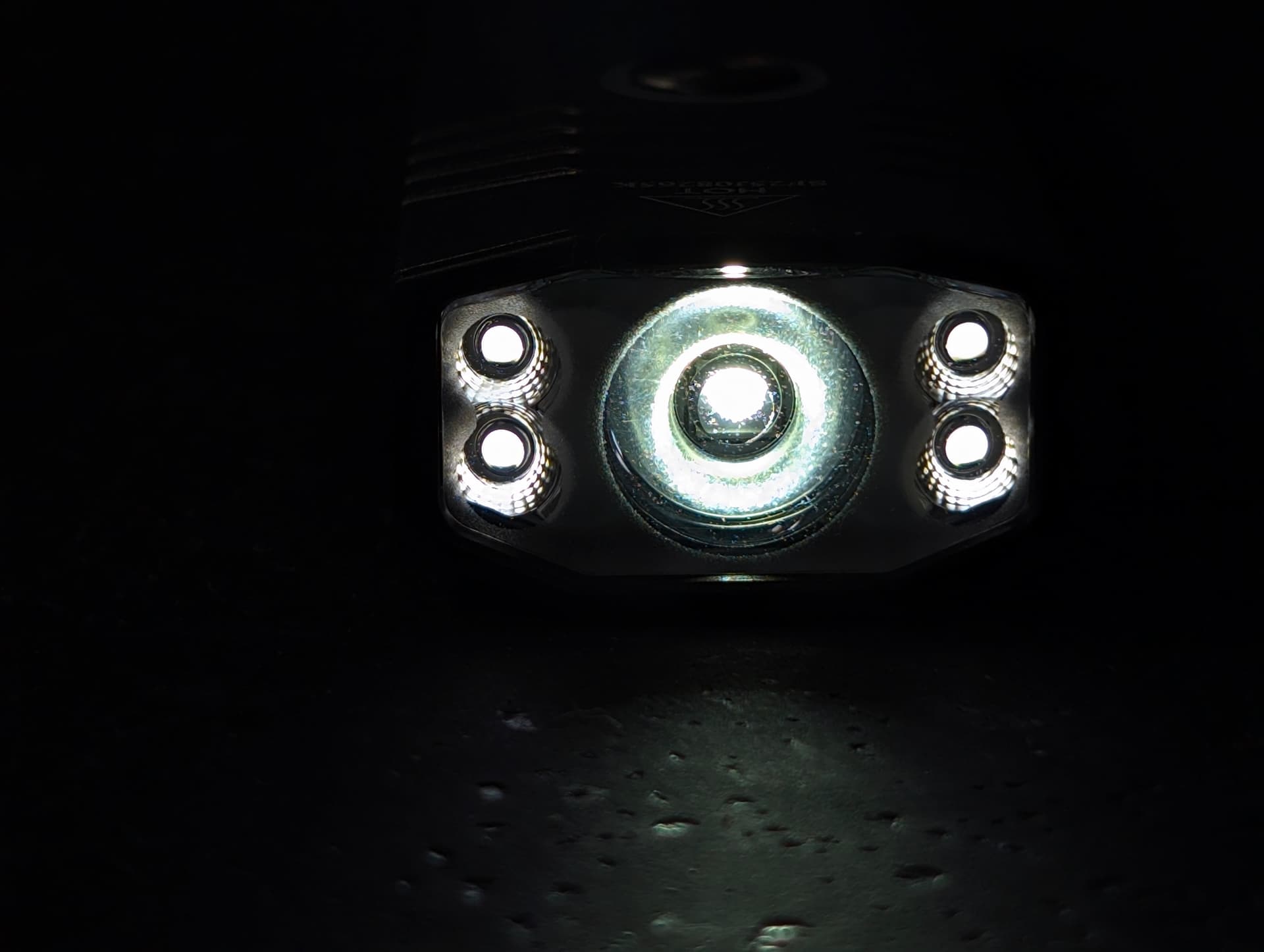

The TIR is not protected by glass and spans over all five LEDs. It’s flat over the center SFT-25R and angled over the tiny side LEDs.

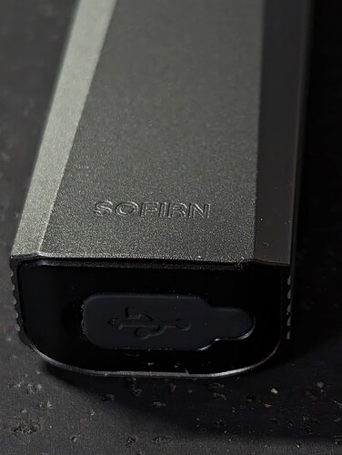

USB-C is integrated in the tail of the light and protected by a very good integrated rubber flap, surrounded by black plastic.

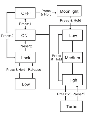

The UI is a basic e-switch UI. I would have preferred triple click for lock and double click for turbo and i don’t see a reason why Sofirn chose double click for lock. While carrying it as my edc for the review, i got used to it and can say if this is your only light, it might be fine.

I can’t tell how much the side LEDs really add to the beam, but at least they look kind of cool.
The beam consists of a large spot with a big corona and wide, very soft spill. I found it very useful while walking my dog and for everyday tasks. It reaches far enough while providing good light at your feet, even lights up the area of peripheral vision.
As you can see in the above image, the light exits more than 90° to the flashlight body!

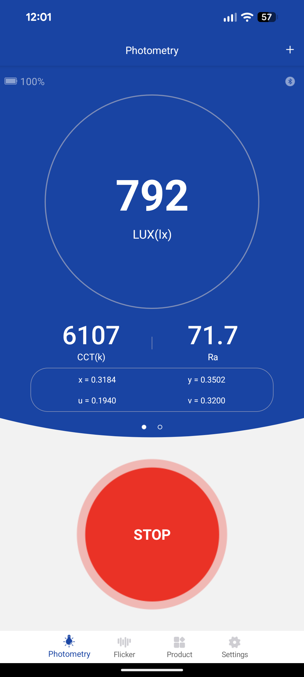

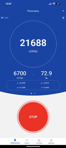

CCT ranges from ~6100k on low to ~6700k on Turbo. It’s a bit hard to measure as the side LEDs are warmer than the main LED.

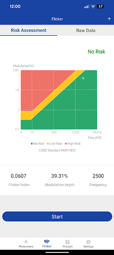

Flicker Index shows no Risk on all Modes, although close to the yellow area on LM III.
CRI shows 72 ±1 on the LM III

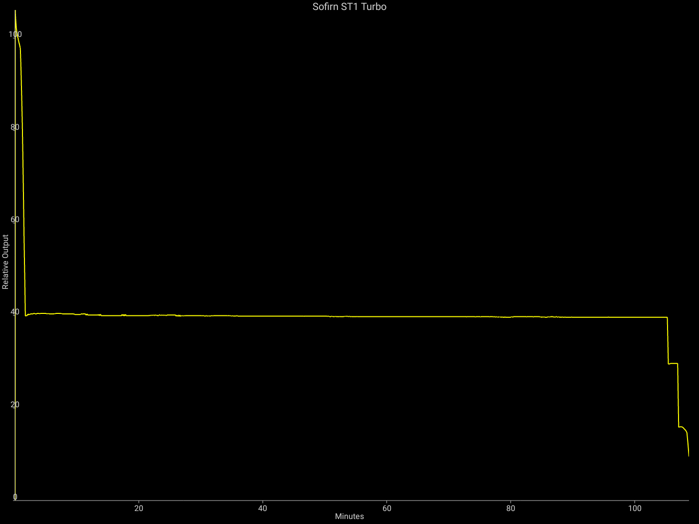

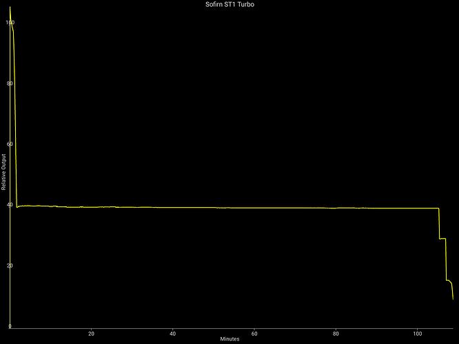

My (not calibrated, but not too bad compared to other reviewers) Lumenbox shows 1450lm on turbo, around 600lm sustain.
Regulation is perfect after the turbo drop. Nothing to complain here, nearly exactly what is specified.

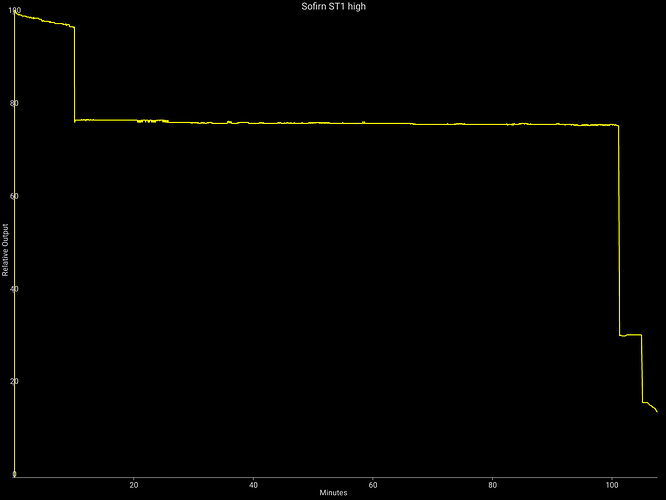

High also looks flawless.
Sofirn claims 2+100minutes for the highest mode, my sample exceeds that slightly.
