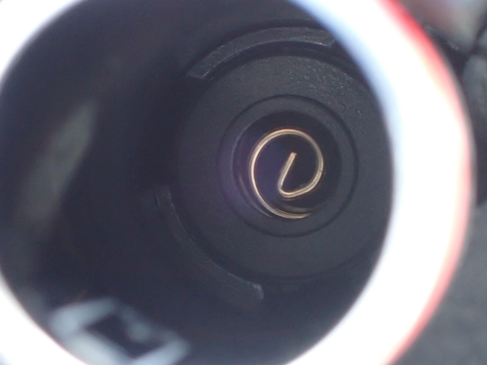

I wasn't able to unscrew the head from the body by hand, but peering in to the cell tube you can see the interesting mechanism that lets this light handle both cell types so well. There's a small shelf around the outer edge of the tube that catches the end of wider CR123A cells. Narrower AA cells center in and rest on the inner portion, which is spring loaded and depresses.
Before it is depressed, a good chunk of the AA cell is left protruding from the light, so you won't make the mistake of trying to put the tailcap on without lining things up first. Thanks to this mechanism, there's almost no rattle to the light with either cell size.
