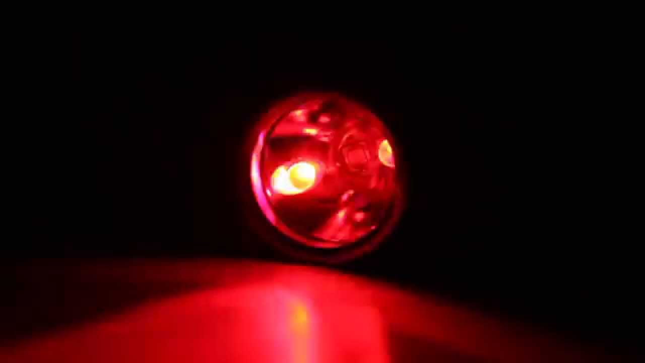

The smooth reflector of this F10R , even when drilled to let pass the optics from bicolor LEDs, provides a fairly clean and free of any aberration beam, although some light reaches the optical two small LEDs and is bounced off the usual limits. This effect is only noticeable indoors, since that bounced light is really dim and you’ll only appreciate in close proximity to the walls. The XM-L2 with relatively large and deep reflector creates a fairly definite and small hotspot so you get extra throw compared to the same flashlights segment that use smaller reflectors. The transition between the hotspot and the spill is quite gradual , without too marked boundary between the two. The XM-L2 cold tint is within usual with a yellow halo in the transition between the hotspot and spill, as is customary nowadays in many XM-L2.
The colored light beam of the two 5mm LEDs shows the usual concentration of typical aberrations of such LEDs. Also the Red color is markedly weaker and fainter than the blue.
