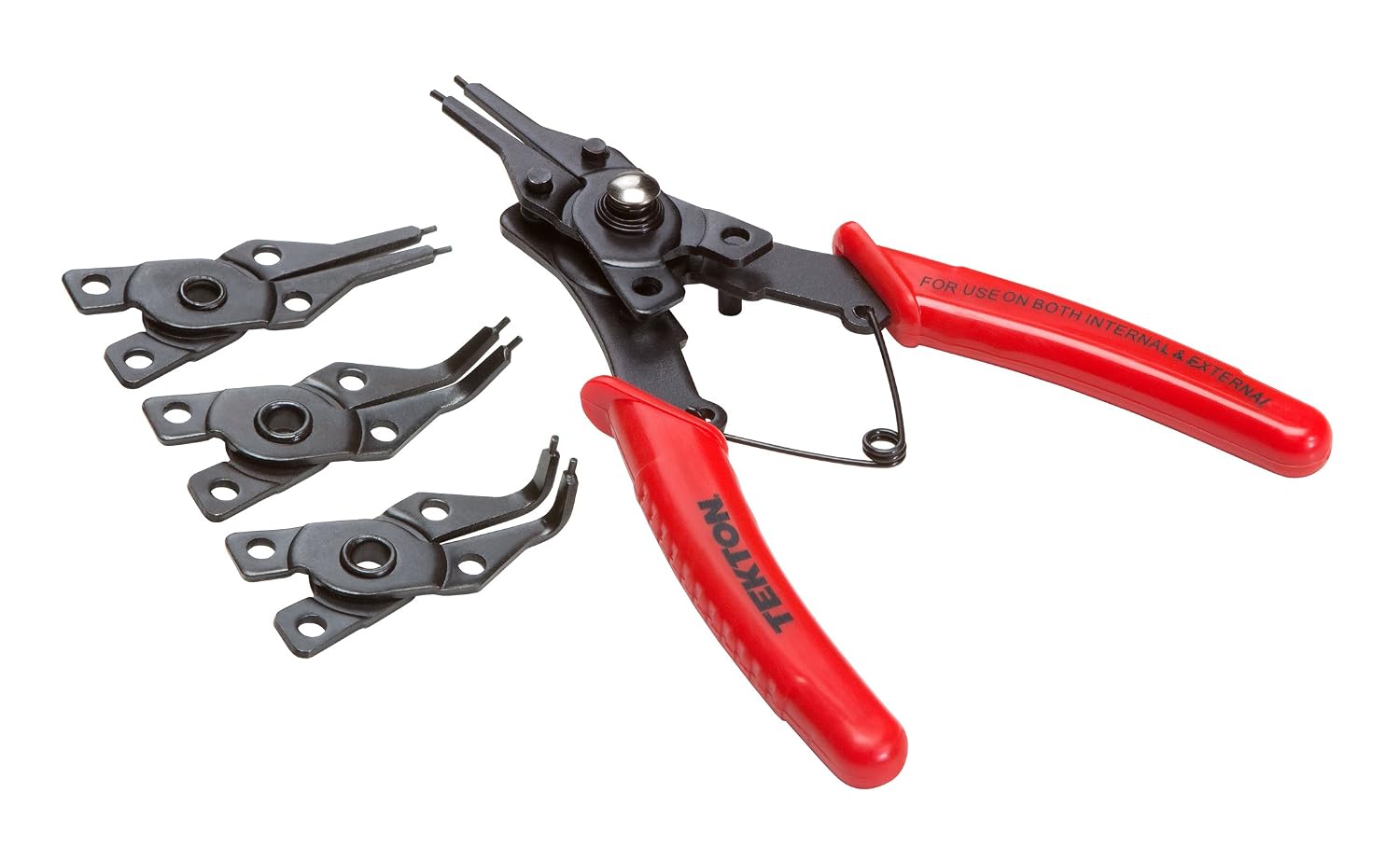

Quick question for the OP, how were you able to disassemble the side switch? The side switch on my rocks laterally forward and backward and it’s a bit annoying. Thanks.
Hi uuelle and welcome to the forum. The switch cover is held in place by a threaded retaining ring. There are notches that you can use to tighten it by turning the ring clockwise. You could use some needle nose pliers (applying opening force to get the jaw ends tight in the notches). If you neeedle nose pliers are too large, you could use small scissors, large tweezers, or anything that will fit and allow opening pressure to be excerted against the notches. The ideal tool would be snap ring pliers (see example in second picture below). Best of luck.
Thank you very much for the info and the welcome.
Took it apart just now with a set of tweezers. Despite adding a bit of silicone grease, the switch still has quite a bit of play and toggles fore and aft upon reassembly. It is what it is.
Thanks again for the info and taking the time to answer my question.
