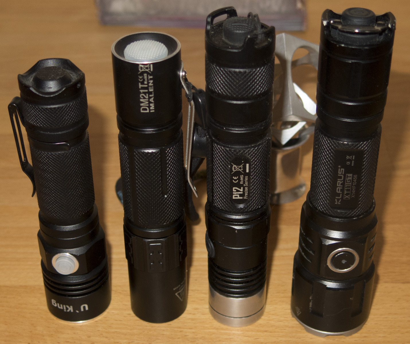

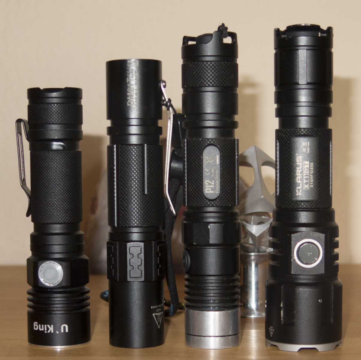

Size compared to other 18650 lights the UT20 is shorter than other tail or side switch lights
UKing, Imalent DM21TW, Nitecore P12, Klarus XT11GT

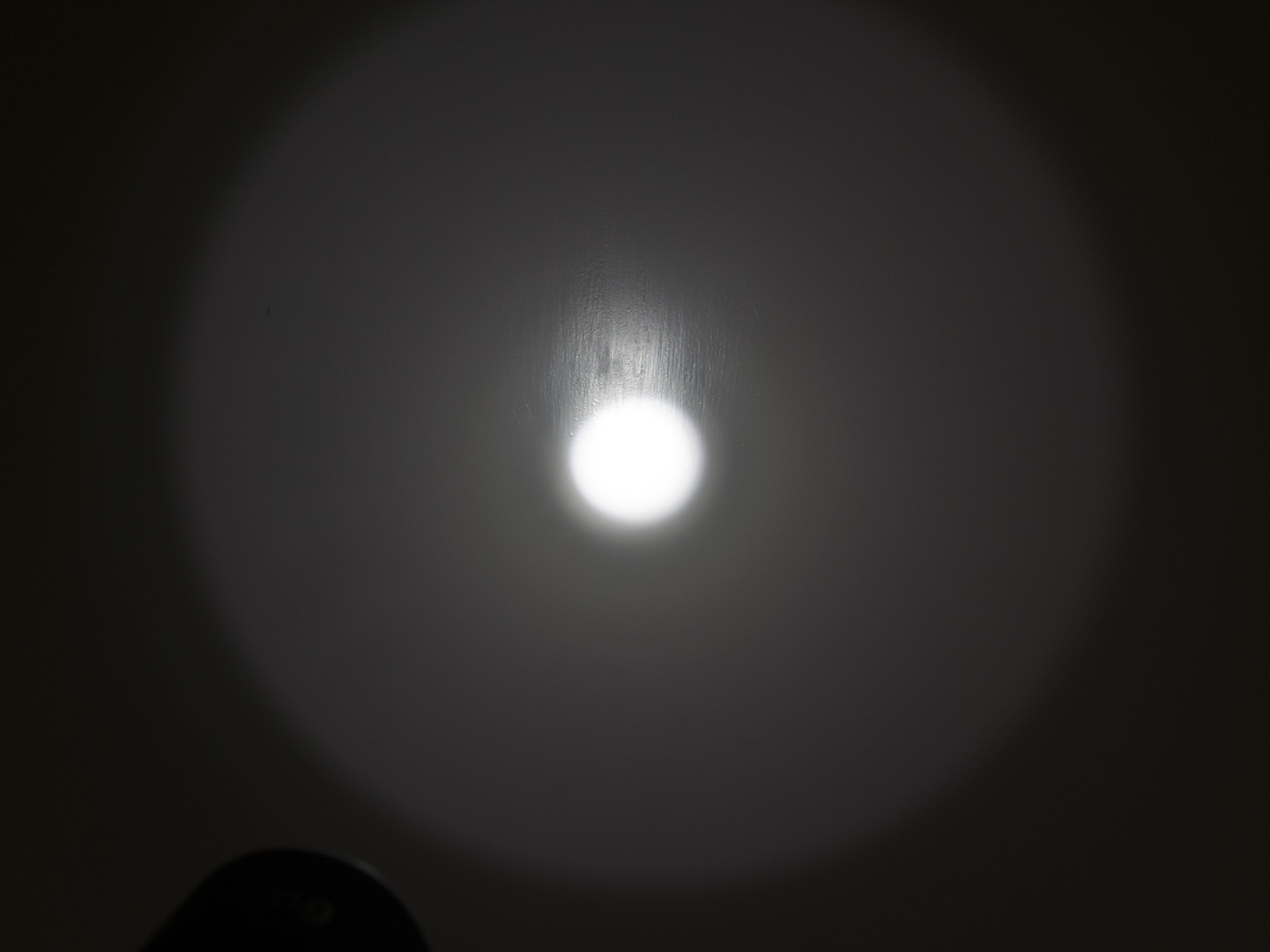

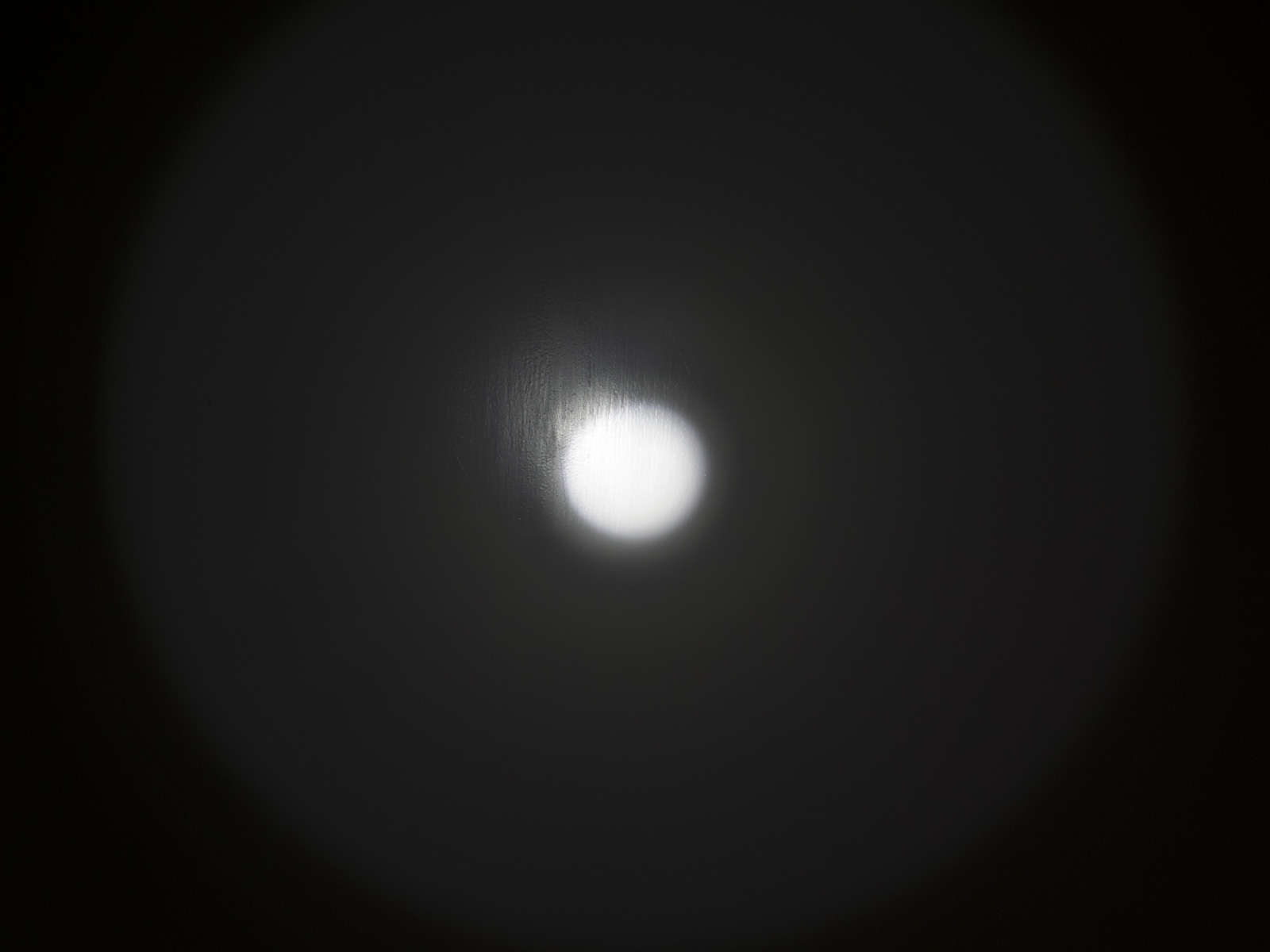

Beam color is cool around 7000K with a Cree XPE sized LED, the beam has some artifacts from not equal shaped plastic reflector, around the hotspot is a darker area

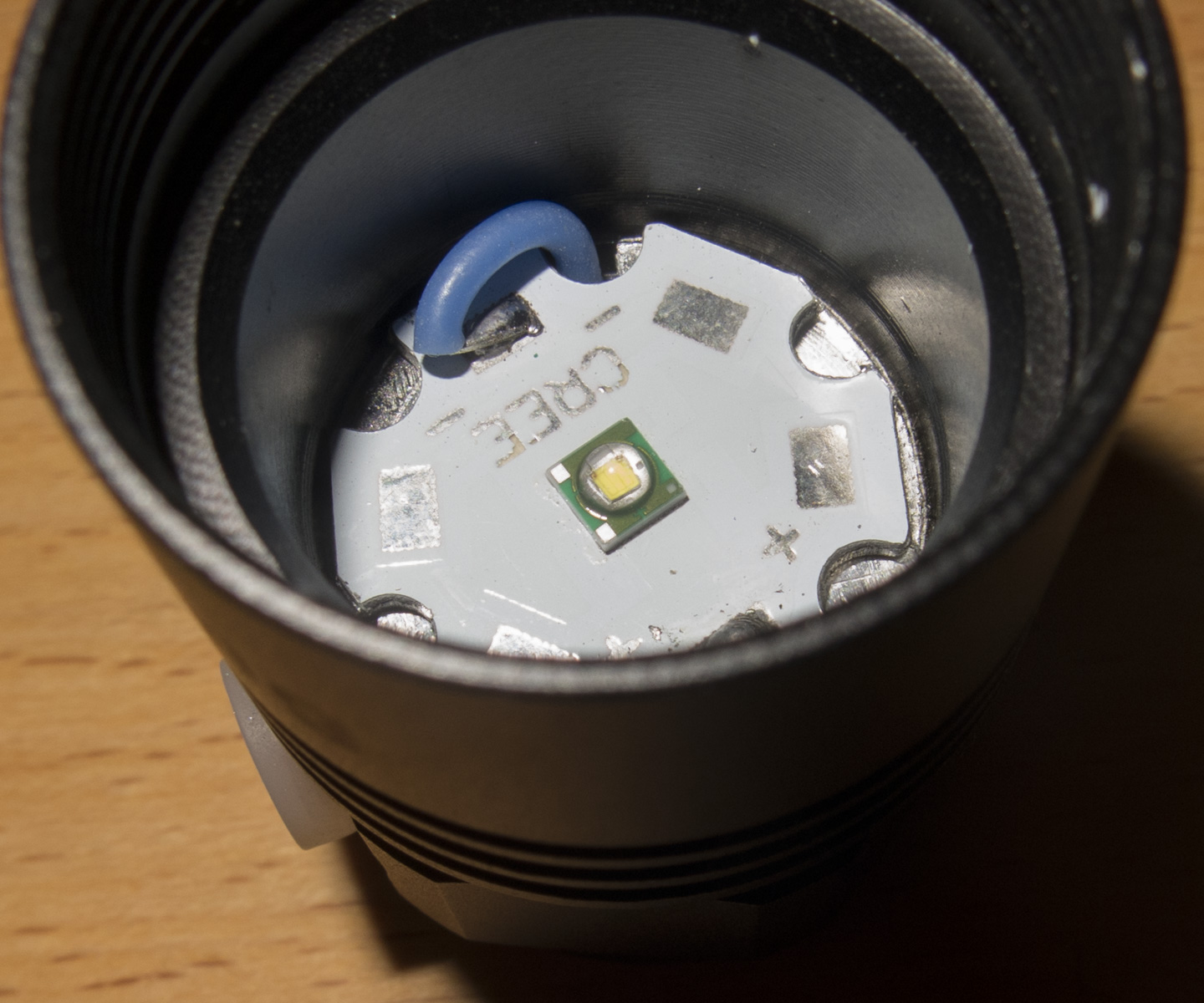

The LED is reflowed on a aluminum star

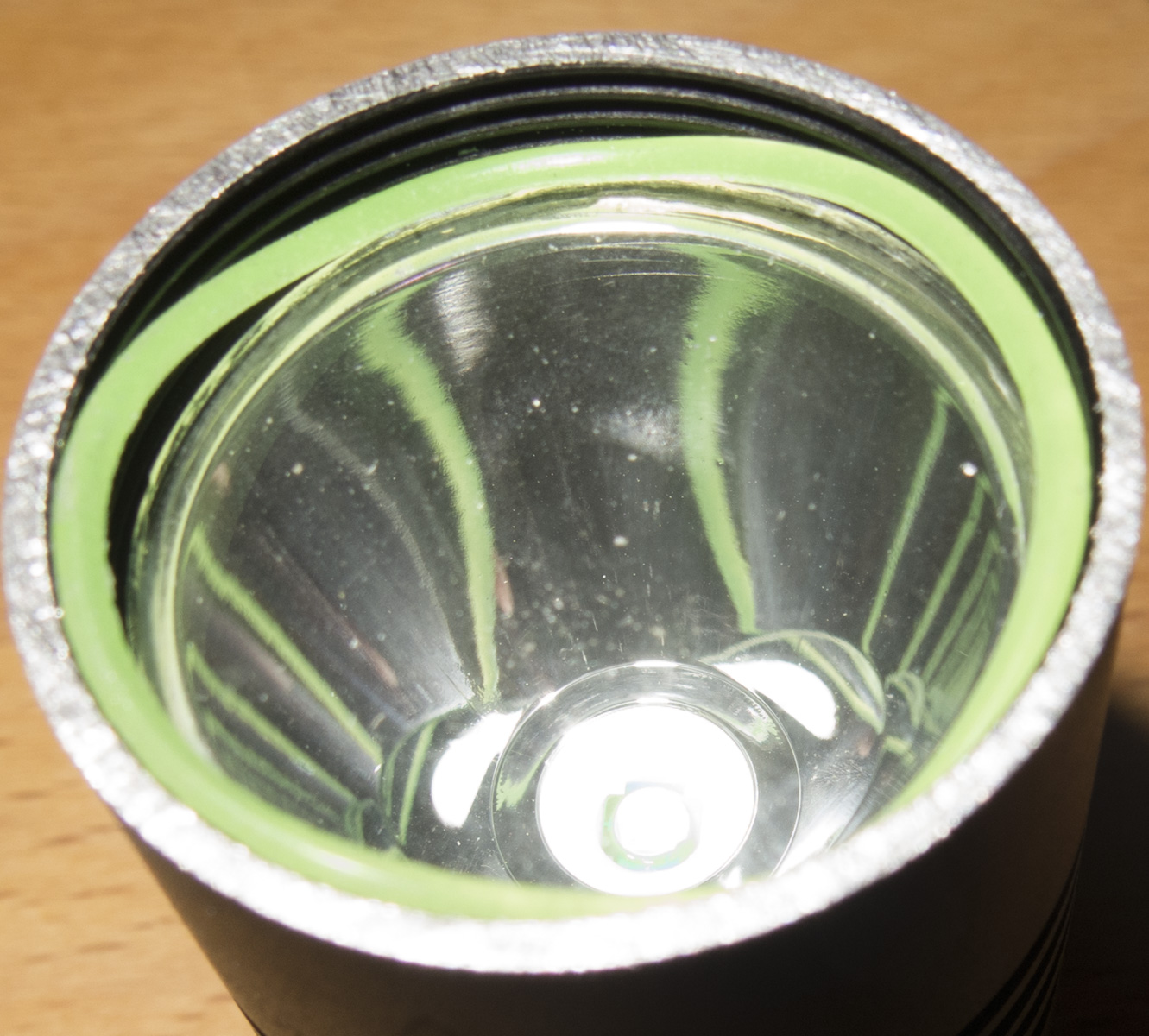

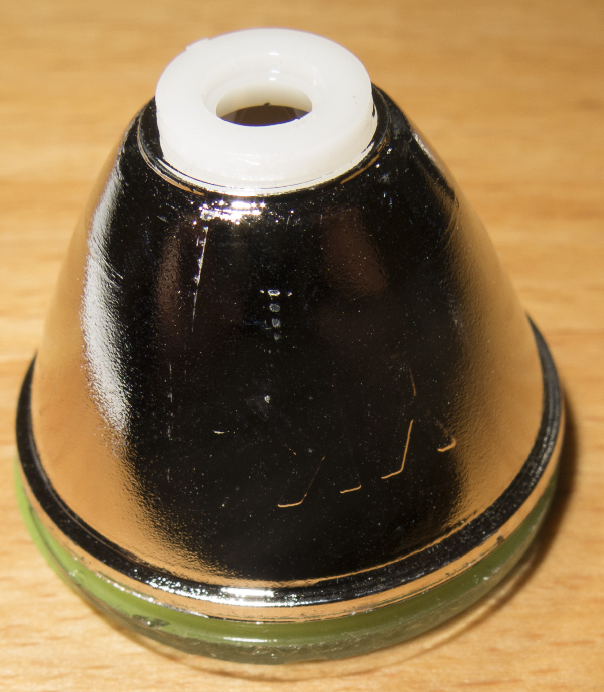

The reflector is made from plastic with imperfections and not well shaped
compared to another Cree XML2 6500K light at medium mode, blame my kitten they dropped those lights like 10 times before I could make a picture
The hotspot is pretty narrow, almost no tint shift between spill and hotspot

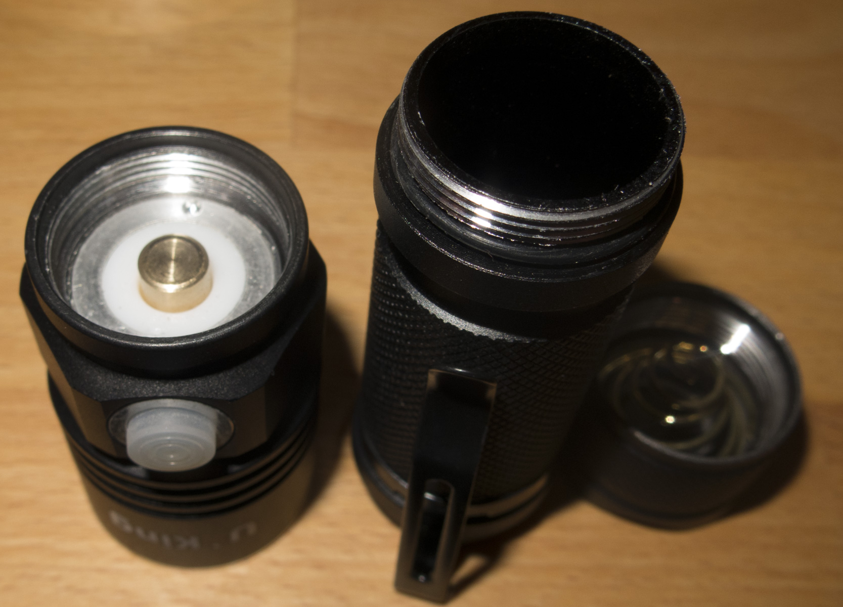

The light can be taken apart easily nothing is glued or press fit, the driver can be lifted without disassembling the switch cover
The light has a tail cap with one hole for a thin lanyard
The light stands on the tail rock solid
The head has a diameter of 28.9mm and 20.8mm visible reflector
The lens is from cheap glass without any coating the edges are sharp
The light can be run with one unprotected flat top 18650 batteries, or you have to remove the button on the switch side for protected

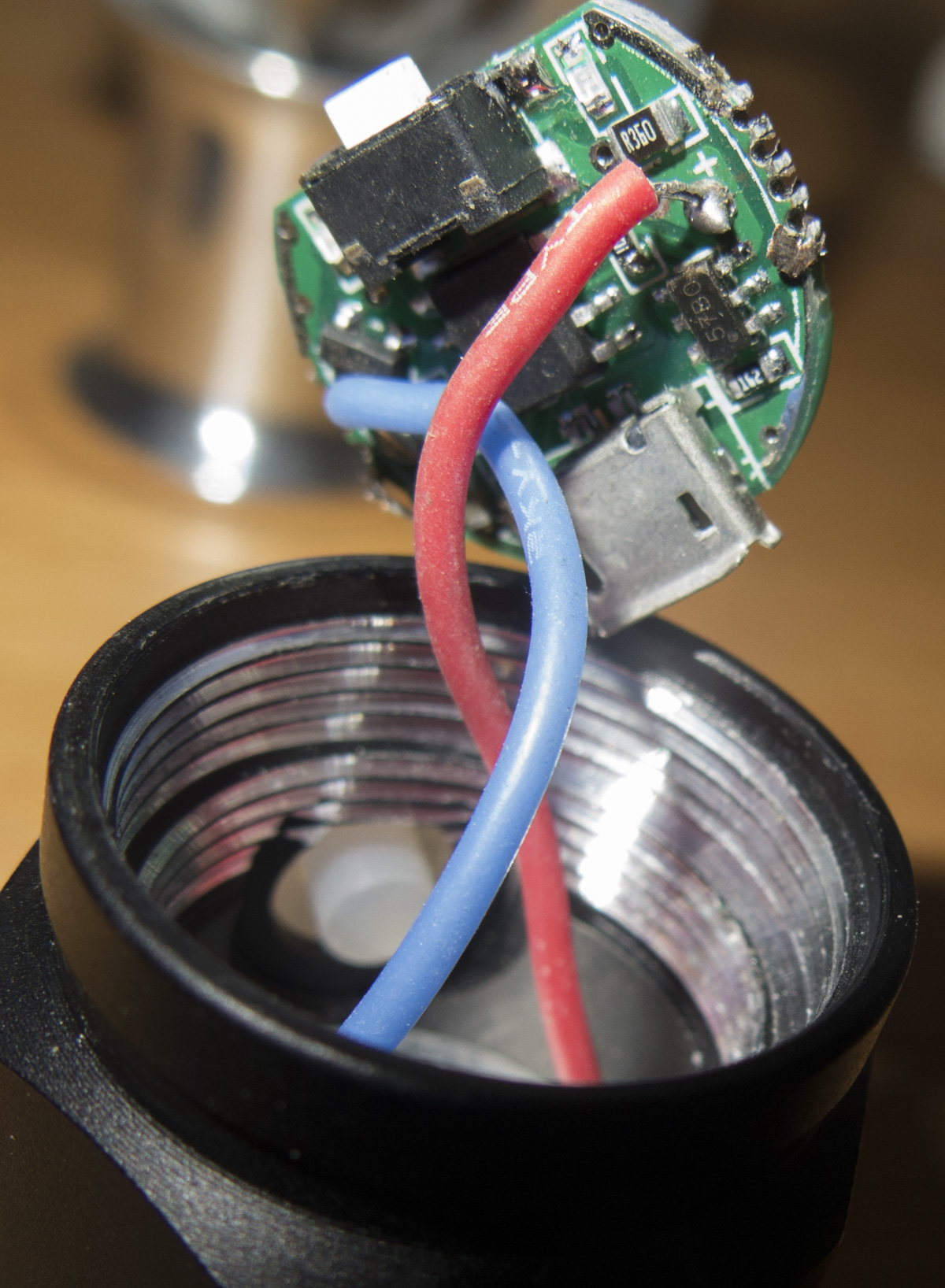

The driver is cheap Chinese crap
The driver has a charge circuit and 2 LEDs

The shelf is 1.5mm thick, but its pressed in not one piece of the head
The MCPCB is cheap aluminum without DTP
The LED is perfectly centered
The glass lens rattles and is not
The light is not waterproof, the tail cap, head, tail and bezel have o-rings, but the lens one is not tight enough
Only thing is they could have added some lubricant to the threads
The USB cover sits tight and seals the light
The switch has a good feeling
Tube and Tail

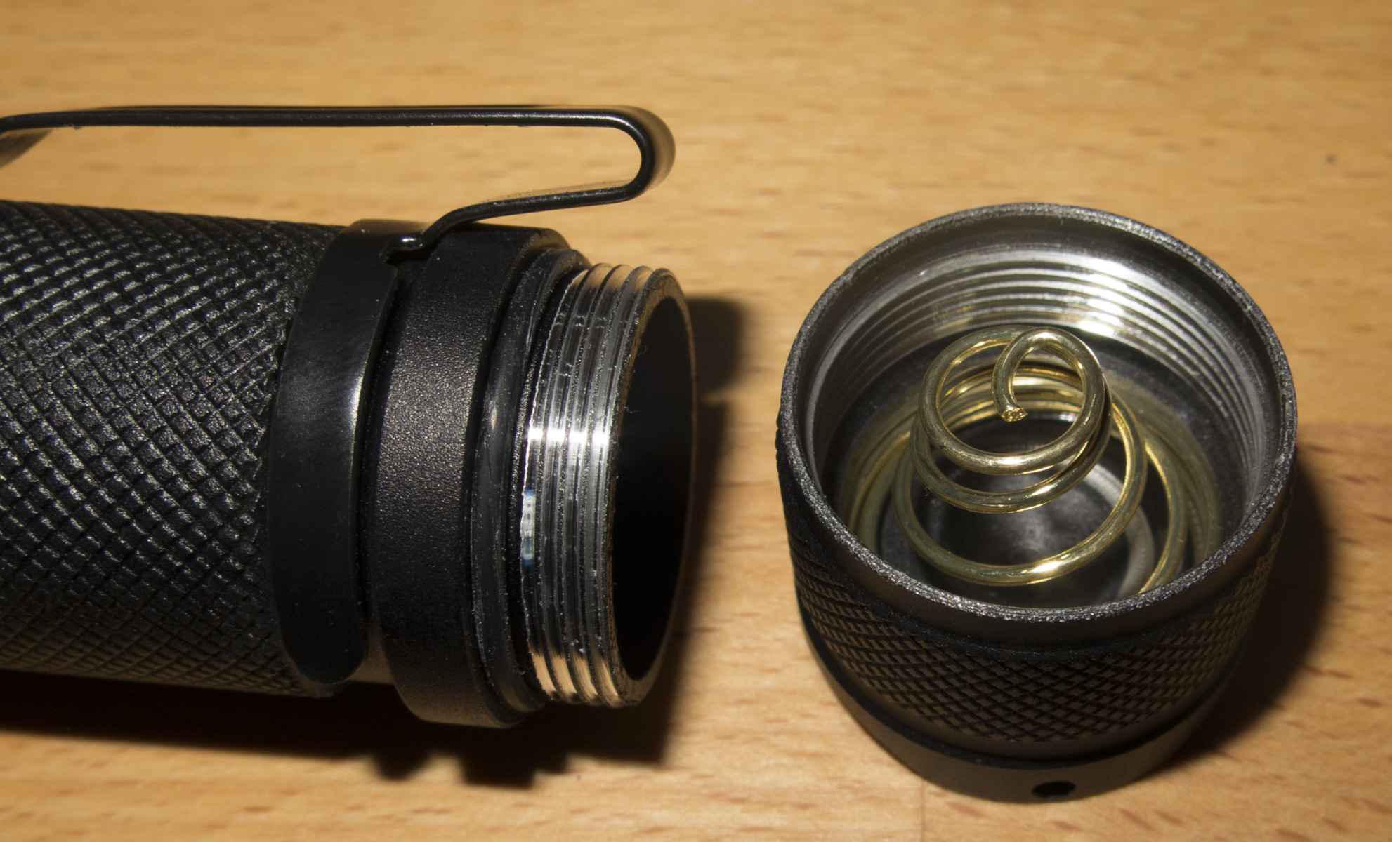

The tail cap is anodized and the inner section is machined, the tail PBC contains a stiff thick steel spring
The threads are triangular cut and not anodized, so not very sturdy
Both ends have a spring made from steel and gold plated
the light uses a short soft spring on the driver and a long stiff in the tail cap
Driver and Battery
contains MCU, charge regulator, a 0.36Ohms resistor, tiny FET, switch and green+blue LEDs
The mode spacing is not good

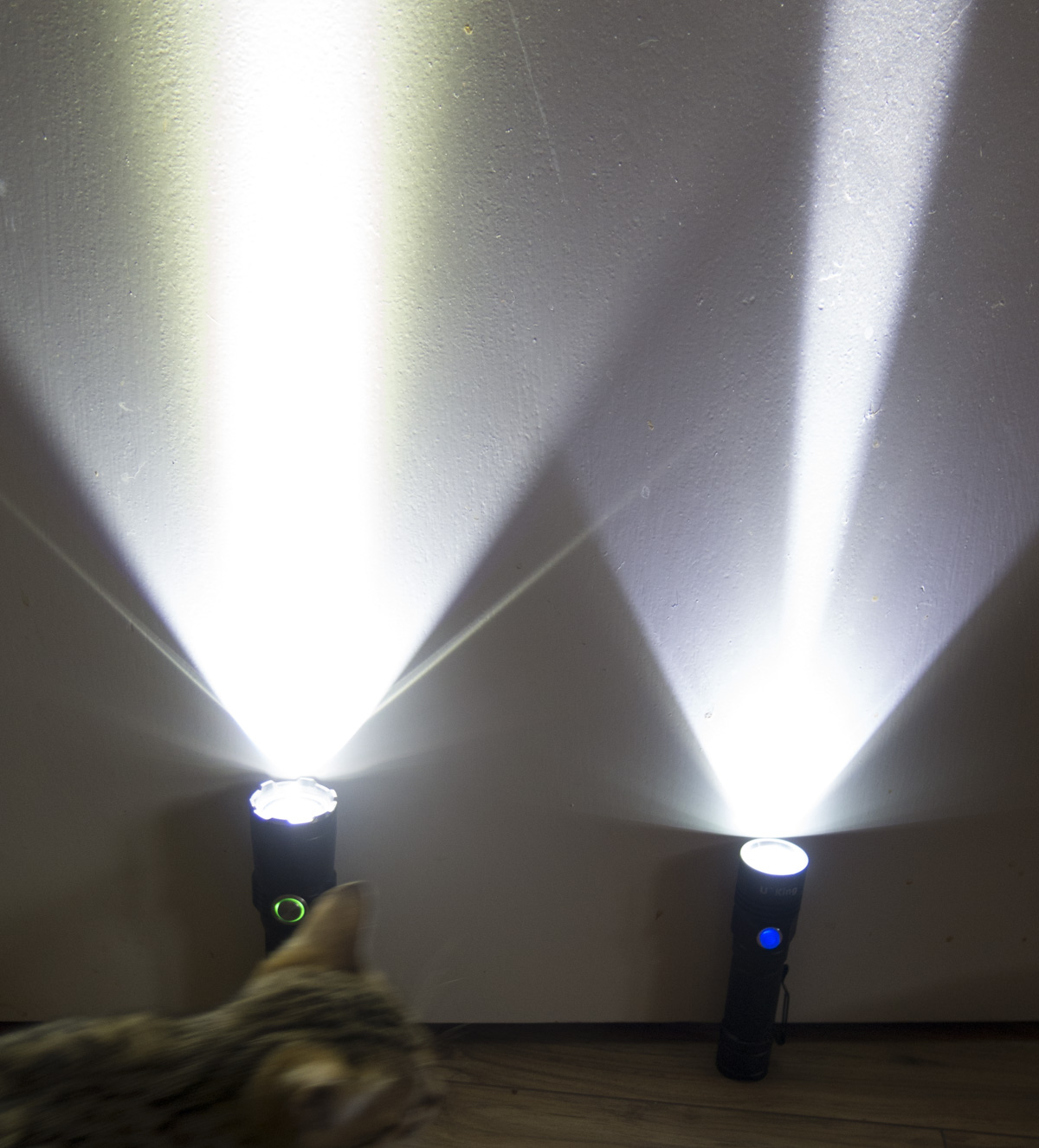

Compared with Jetbeam Jet-1 MK running with NiMh at 150 lumens
compared to a 6500K XML2 around 1000 lumens

I sanded down 0.5mm of the head, so the bezel does some pressure on the o-ring and seals the light
