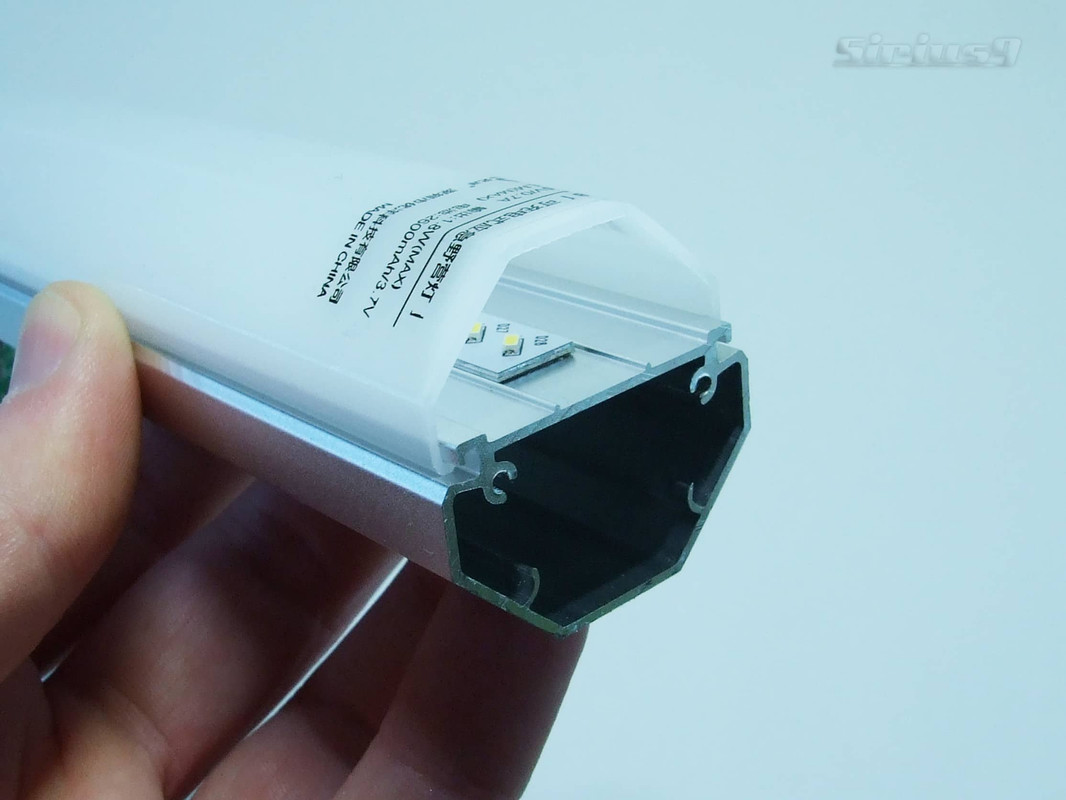

Couple images of housing profile, as you can see there is no much of a meat under the led strip but that is not a problem since this lantern hardly gets even mildly warm after prolonged time in highest mode. I should also mention that milky diffuser plastic on top of the led compartment does a good job in scattering the light in 180+ degrees.

But the biggest objection from my side is that manufacturer did not pay attention to overall design because if they extended the aluminium profile for only about 5mm they could fit two 18650 cells inside and increase runtime significantly. Even redesigning the circuit board, making it wider but shorter or using 2 board design would free up just enough space to cram in the second cell. I was thinking to just cut the PCB in 2 pieces, connect them with wires and make some more room but that PCB is complicated, to many traces and would not be easy to reconnect them. Manufacturer does have some waterproof models but this is not one of them, there are places where moisture/water would enter easily and that would not do good, also this is not super rugged model, it can brake.
