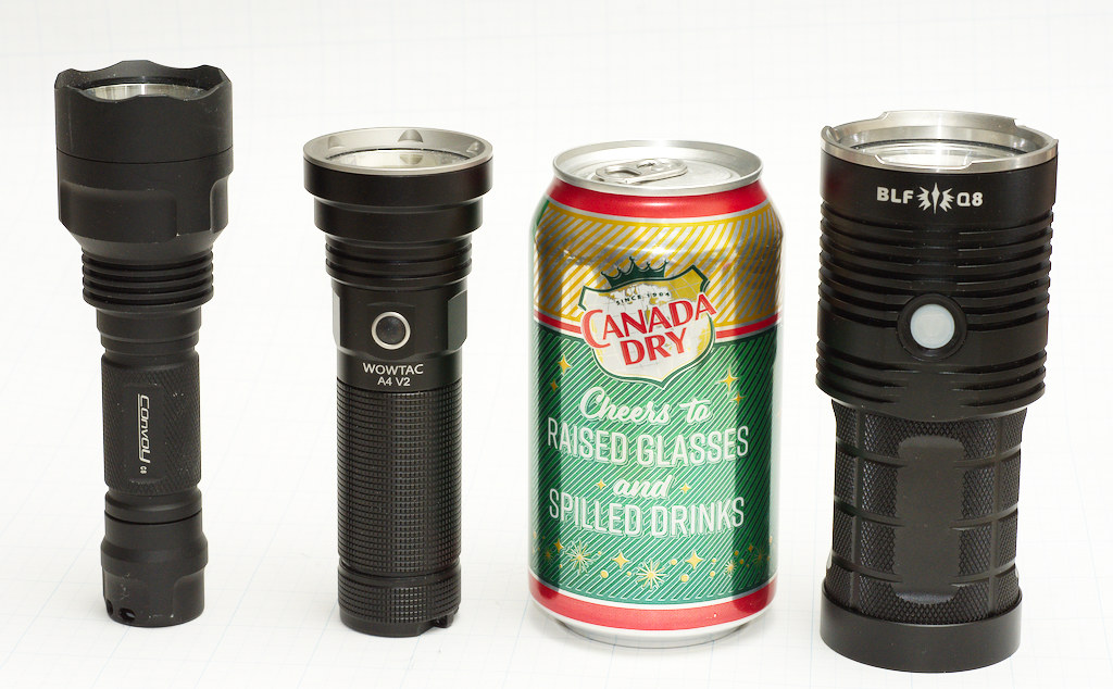

More usual suspects.
C8, A4 V2, Refreshing beverage, BLF Q8

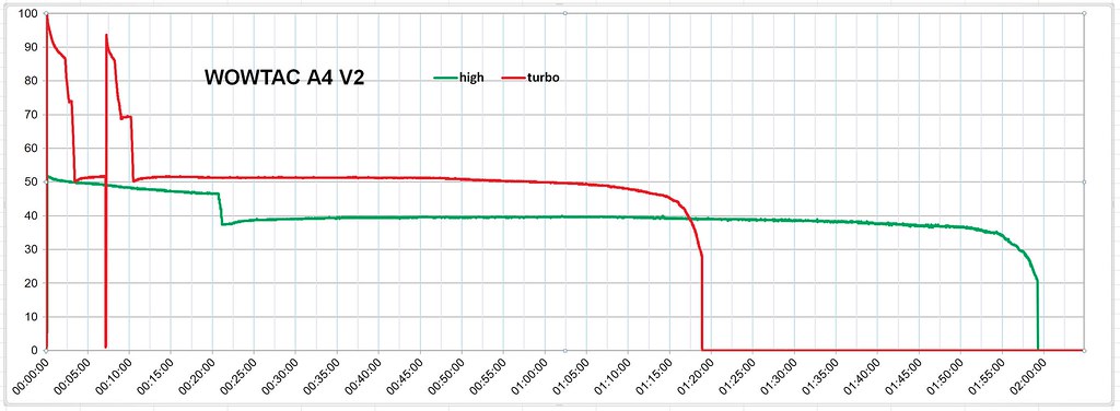

Runtimes
On Turbo (cooled with a fan) in RED, High in GREEN
The light holds Turbo well and only dims a bit.
It starts dropping out of turbo at 2m 15s and fully steps down to around a 1000Lm at about 3m 30s
The light quit at: 1H 19m
I gave it a double click after the first stepdown just to see what happens.
It returns to Turbo and then steps down again.
Notice after the stepdown the light gets a bit brighter. I wonder if this is some temperature related function.
The light was close to the 3m stepdown as listed by WOWTAC.
I only got 79m of total run time. WOWTAC lists 143m. I don’t know how much the extra kick into Turbo altered the outcome.
On High (fan started after stepdown (I forgot to turn it on at the start)).
Stepdown starts at 20m 45s and fully steps down at 21m 10s or so
The light starts to dim quickly at about 1h 56m
It turns off just short of 2H.
Once again the light seems well regulated holding high then stepping down. Once again there is the small increase in brightness after the stepdown.
It’s interesting that the specs think high will last 8m before stepdown. That’s not what I observed.
Total run time was not close to the 8m + 150m listed in the specs.
But mine stayed brighter for far longer than the 8m.

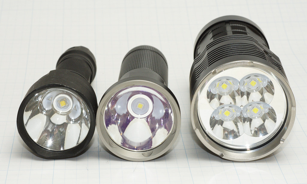

Setting it next to a C8 with the SST40 gives a slightly larger hot spot.
The greater output of the WOWTAC might help it out, but to me the cold C8 looks more “throwy”.
The color temp differences are not as dramatic using mere eyeballs.
Beam Spread
Taking a look at the beam profile
On the rug next to a C8 with SST40. Sofirn SP36S with a wider softer cutoff for comparison.
Not as tight a hotspot as the C8 but has a wider Spill.
