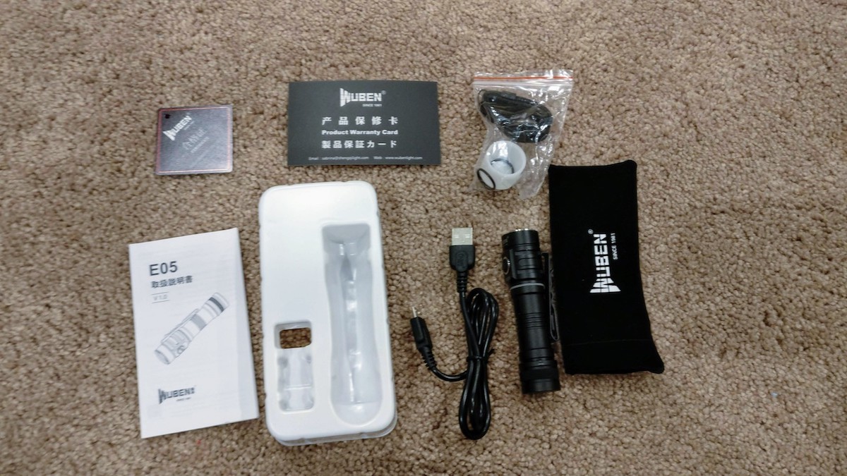

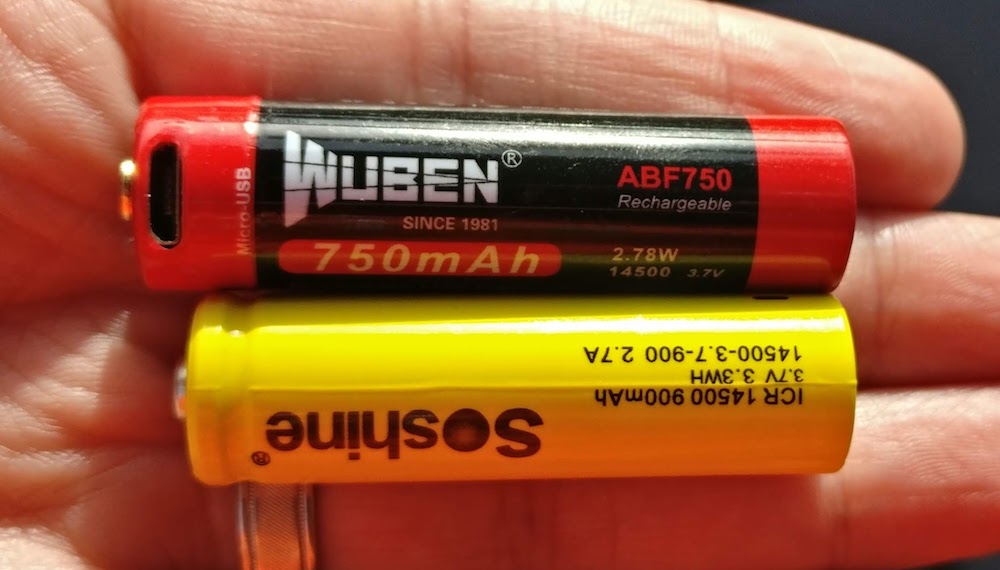

Packaging: the E05 arrived in a nicely presentable box with a bunch of goodies: 750 mAh 14500 with built-in micro-USB charging, a micro-USB cable, fabric pouch, silicone diffuser, lanyard, spare o-rings, intro cards, and instructions.

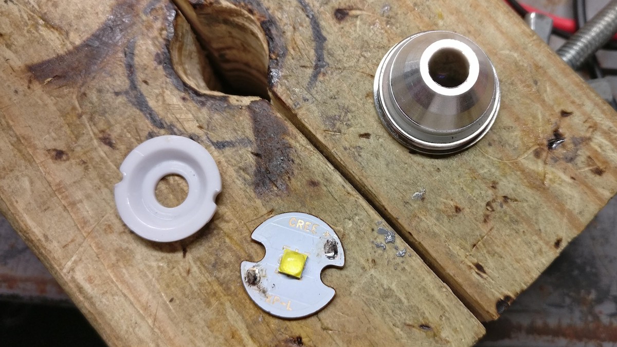

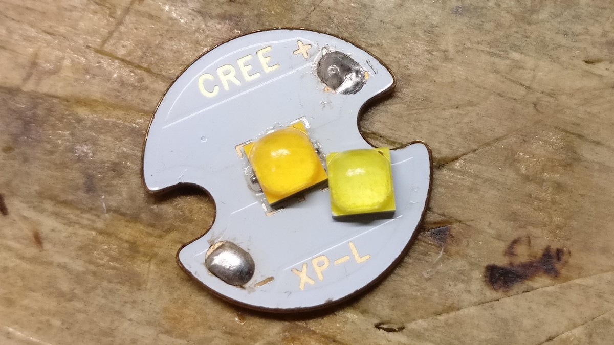

LED Tint: I’ll just start with my least favorite part of this flashlight. The LED is a cold white (think 1A-ish) XP-L2. Some people like cold white. I’m not a fan. So I’ve got a 4000K 80-CRI XP-L2 being delivered today that’ll be swapped in (see post #2).

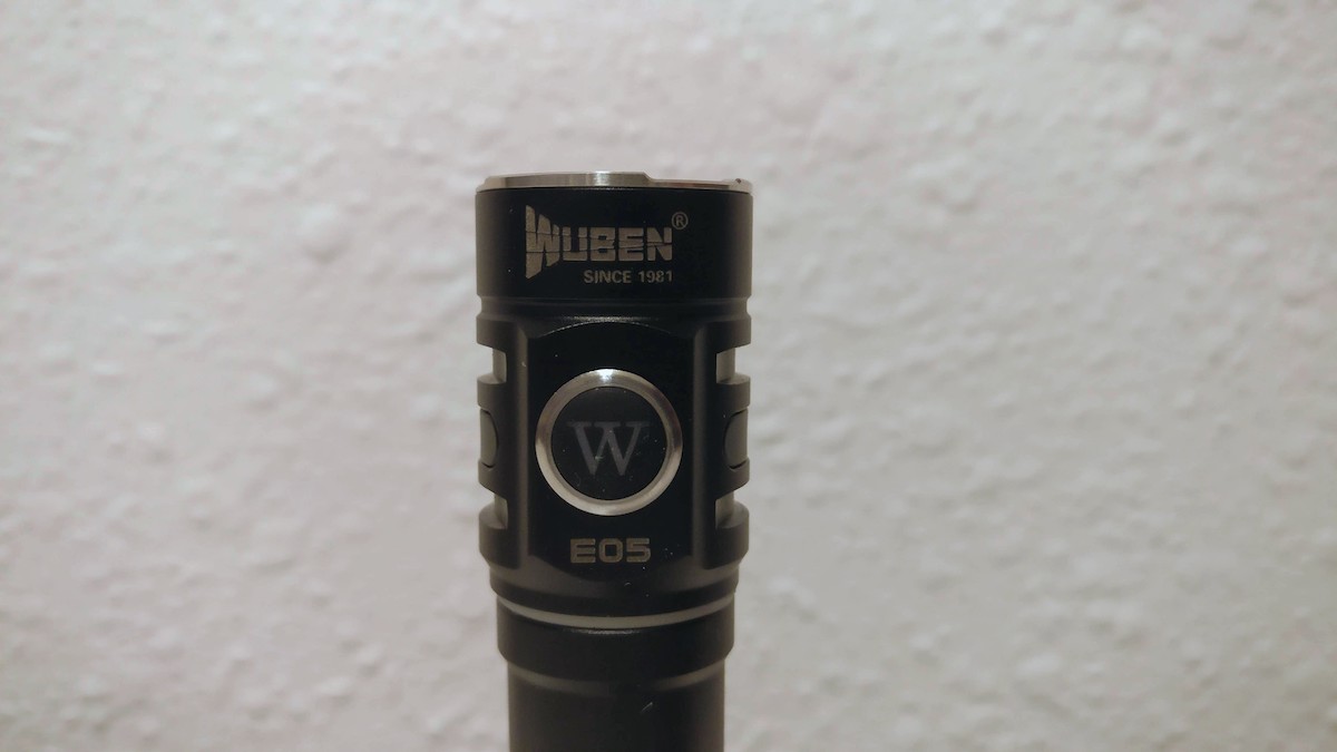

Styling & Build Quality: The E05 has a nice, elegant style to it. No aggressive knurling or crazy designs. Even the stainless crenelated bezel is pleasantly understated - the crenelations are only ~0.3mm tall. The glass is AR coated and the LED is perfectly centered. Due to how the (removable) clip mounts, it’s always perfectly opposite the switch. Speaking of the clip, it’s of the rare S-shape (double loop) style that can be used either direction. The signature Wuben “W” switch is set into a stainless surround and covers a blue LED that is used as a battery indicator. There’s also a subtle GITD (glow in the dark) ring at the base of the head. The tailcap houses a strong magnet that easily supports the weight of the light.

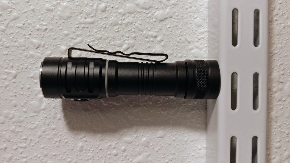

With the included battery; square-cut smooth lubed threads

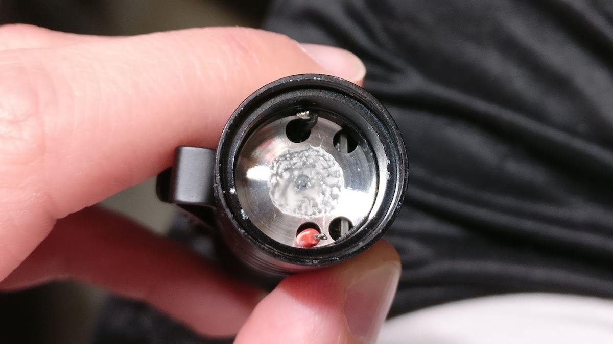

The head… looking good, non-aggressive crenelations on stainless bezel
The blue indicator light used for monitoring battery levels
Just hanging around with the tail magnet (and showing off that double-loop clip!)
