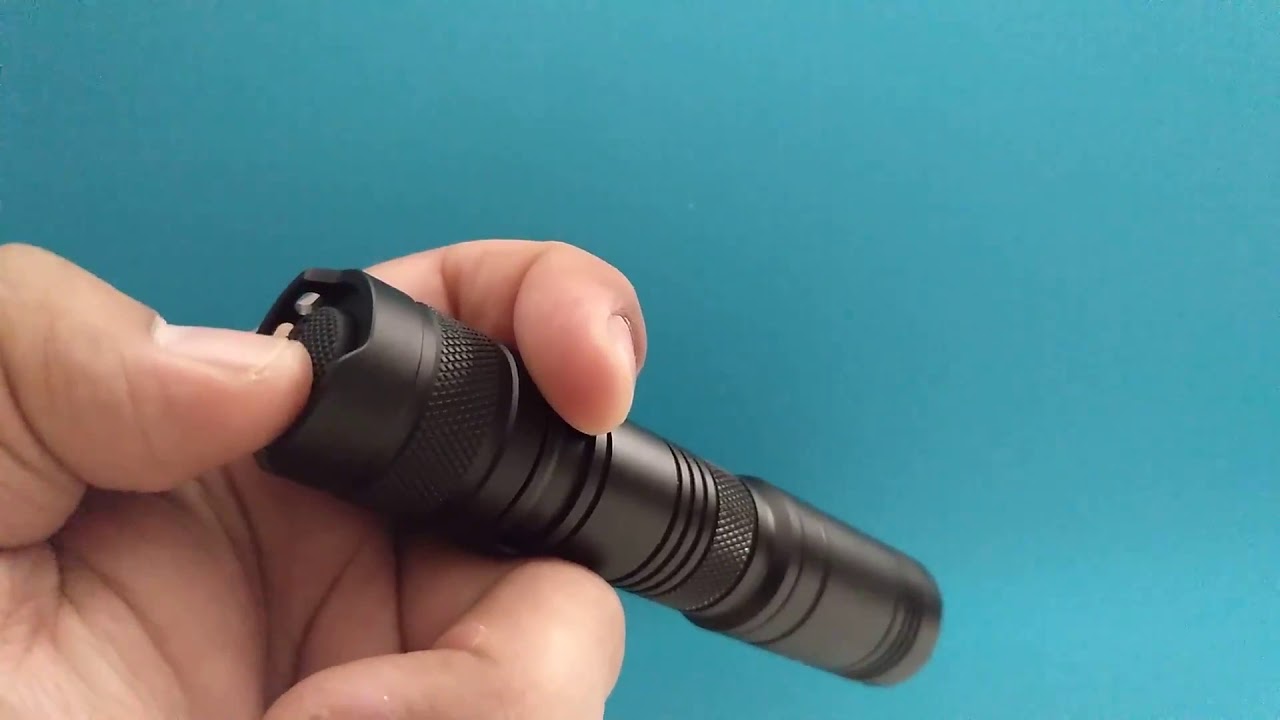

The Wuben E10 is being presented as a “suitable for one hand operation flashlight”! And I guess they are right! The flashlight can be used in a simple way and it’s shape even allows using it in “cigar” style if needed.
Not being the smallest 18650 light we will find, it has a medium size that is a compromise between EDC and back-up light.
Out of the box we find a very well built flashlight, with excellent anodizing, being this a Wuben characteristic, at least in the lights I have.
It has soft and matte anodizing, even the knurling in the tube and tailcap is not aggressive. It has some slight machined grooves in the head and tube.
The flashlight is sort of tube light, with lines that resemble a “bigger” Lumintop Tool AA/AAA flashlight!

The tailcap, itself, has 2 lanyard holes, a Wuben branded silicone button, and inside we find a somewhat “different” reverse clicky switch with gold plated tough springs.

4 – Indeed, this is a light that can be easily used with just one hand, and the shape of it allows a cigar grip, that can be useful in many situations to get a sharper orientation of the beam. It also allows a comfortable grip when holding it “tactically”.
