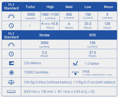

Specs by Wuben
You can find all information on the manufacturers site:

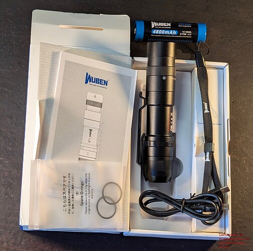

What you get in the box and build quality
The light comes in a typical white Wuben box with blue accents.
It’s a classic sleeved box, not the flip style the X4 comes with, but still makes a very nice fist impression.. Included is a multilingual manual, a USB-C cable and a lanyard. The battery was already in the light, protected with an insulation sheet.
Wuben sent me the black version, which seems to be the only color existing. The anodization is perfect, the light overall flawless.

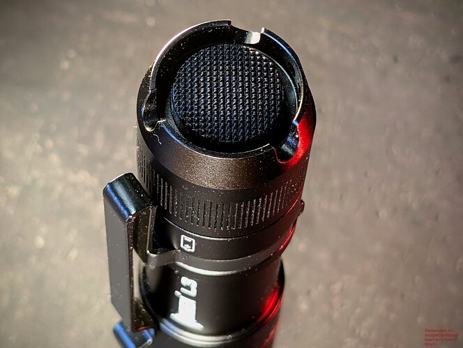

The rubber covered button is special: It has a click and if you press deeper, another click. Different to e.g. Olight, not only to stages, but two definite clicks. Very interesting concept, never experienced something like that before.
The button is a bit recessed, it won’t be easy to press it by accident. The light easily tailstands. That makes especially the second stage of the button a bit hard to click, though.

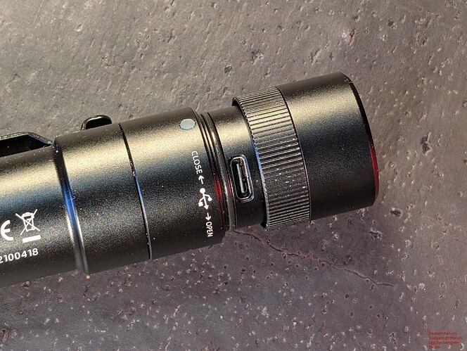

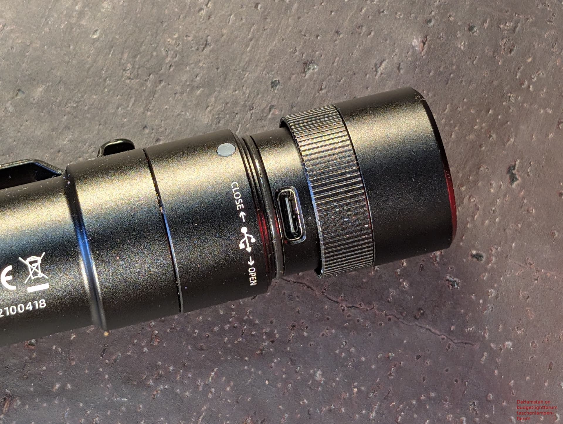

Next to the bezel there is a collar, which can be loosened to reveal the USB-C-Port. Interesting design there: It’s not only the knurled Ring, that slides up, the recessed, smooth area between the knurled ring and the bezel slides under the bezel.
There is also a battery/charging indicator next to it on the body of the light. Charging works perfectly fine, but the light refused to communicate with one of my 100W-cables and kept blinking red. All other cables worked fine though. Seems to be exactly this combination, but I never experienced this before, so i wanted to mention it.

The clip is a one of those that clip to the body. It comes premounted and is hard to remove, so it won’t come loose on its own. It’s a good clip. The sweep up at the opening side is just the right angle, the contact area to the tube is flat and wide. There is enough to fit belts or thick webbing.

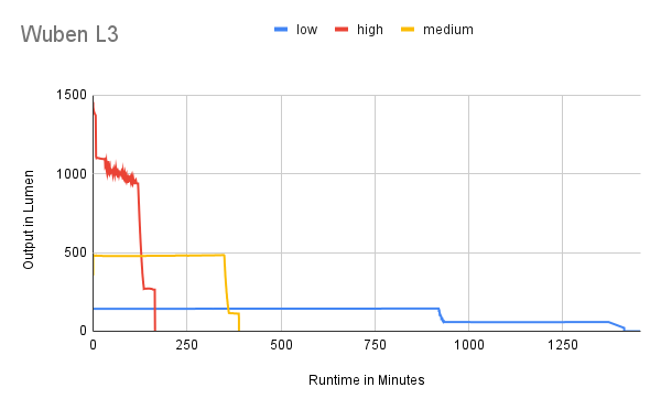

Turbo is only momentary, so no full runtime diagram for this, but turbo steps down to the sustained level quite fast anyways. In the following diagram, I let run down the first activation of turbo, then repeatedly activated it after a short time. The light gets very hot doing this, my temperature sensor saw 60° and i am sure it wasn’t on the hottest spot. For a momentary turbo, i like this behaviour, but your opinion might be different.
On high, the light gives you about 7 minutes of 1500 Lumen, then going down to 1200 for over half an hour. After that, it slowly drops below 1000 lumen - a very good sustain for a light that size in my opinion. After around 2 hours, the light goes down to around 270 lumen for half an hour before shutting down.
On all other levels, the light is regulated flat - I didn’t test the lowest mode though.
Runtimes look good.
