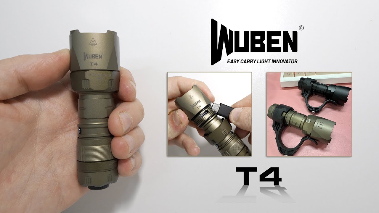

My review of the extremely hyped WUBEN T4 & attack grip
There’s been a lot of anticipation regarding this light, so does it deliver?

From the specs and the beam and emitter, it’s a larger Wuben E6 with USB-C rechargeability, tail switch, and better ability to smash things and people. Used as a flashlight, it’s practically the same, just bigger with ~20% more mAhs.
The E6 gets Strobe quickly with a double-click, so the T4’s Tac mode doesn’t really get you much over what you get with the E6, especially considering that the E6 is quicker to Strobe if your T4 is in normal mode.

HML vs LMH would be a partial dealbreaker. Poorly implemented UI (as usual) would cinch it.
The flash is the light thinking it’s being hit with momentary-high until it clicks through then goes into low or medium. Really need dual tailswitches to do that correctly, like the ED20-T or TM-03.
