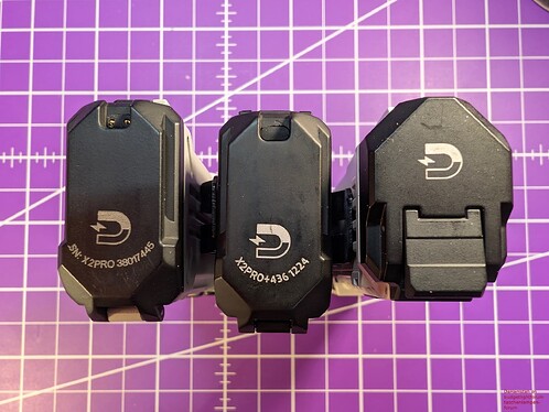

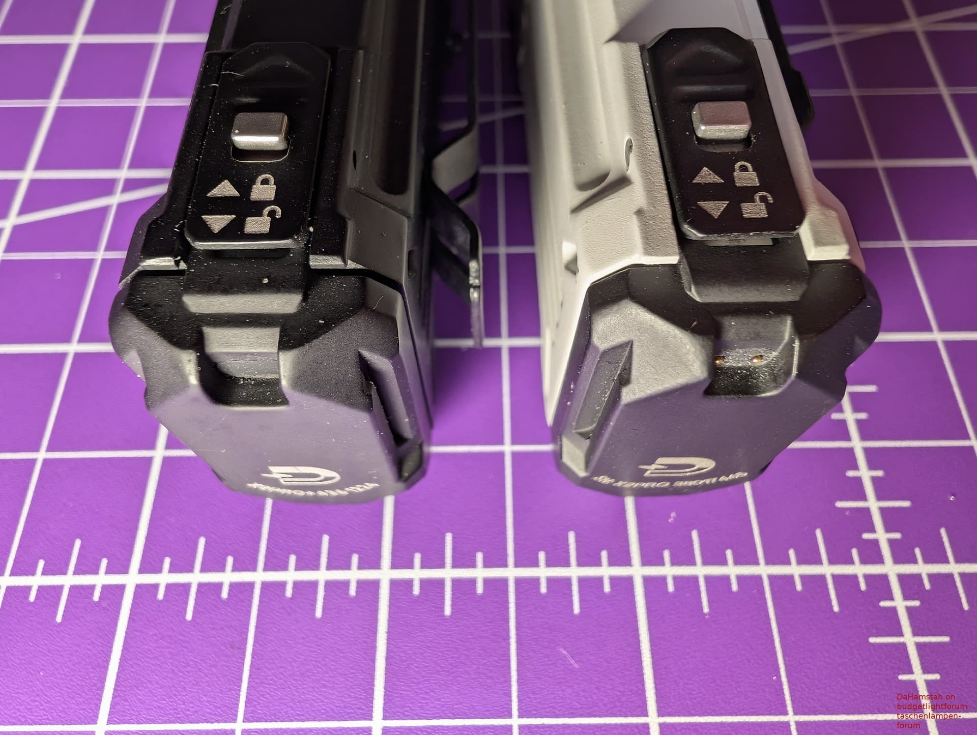

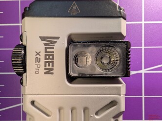

The quality is at a similarly high level as the X4, significantly better than my copy of the original X2 Pro. On my X2 Pro, the side light can only be adjusted with a lot of force, the thumbwheel is very scratchy, and the integrated button does not react well. All of this has been fixed with the X2 Pro+. The wheel runs smoothly, the button responds great to pressure, and the side light pivots with gentle pressure.
Externally, the light is almost unchanged, only the two contacts for the tail switch are missing with the hole being cleanly sealed.

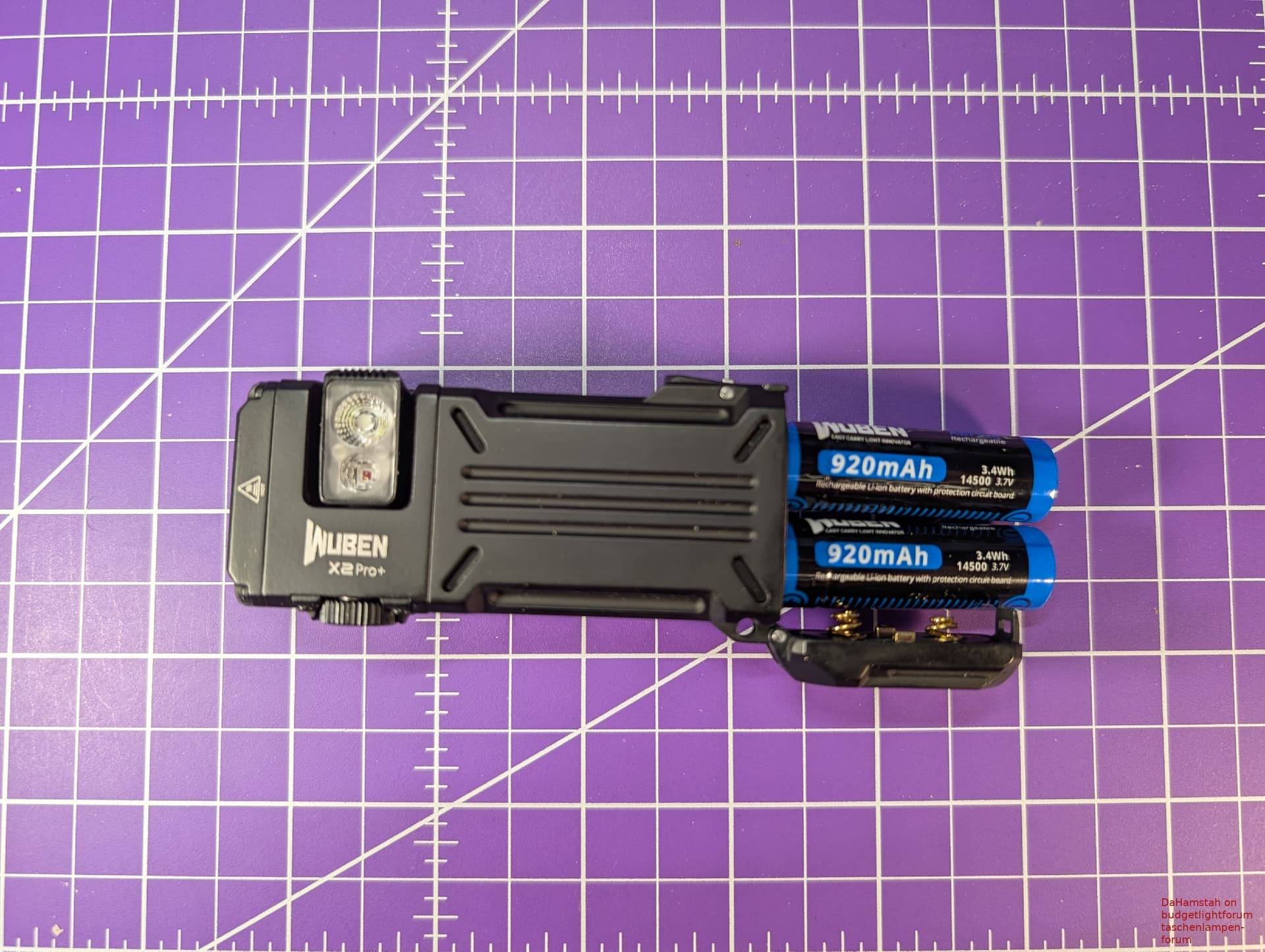

The battery indicator was adopted from the UV version and sits below the side light, near the USB port. Blue indicates full, red indicates charging. When you turn the light on, the indicator lights up briefly. It features constant blue, blue flashing, constant red and red flashing - I would guess each indicating 25% remainíng charge, but I couldn’t find anything about this in the manual. Of course the indicator works for the side light as well.
The light has no Low voltage protection, if I read the manual correctly, but the included cells are protected. That wouldn’t be very surprising, at least given the possibility of also using 1.2/1.5V cells.

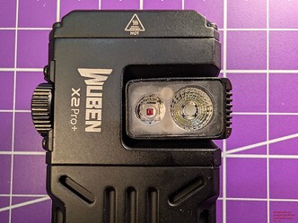

Speaking of the side light: there is no more RGB, no UV. Now there is only red. If you ask me, this is a good decision. I never had the UV version in my hand but read many timesabout the UV light beeing weak. The RGB version is okay, but the colors are not very bright. The new red is bright. Really bright.

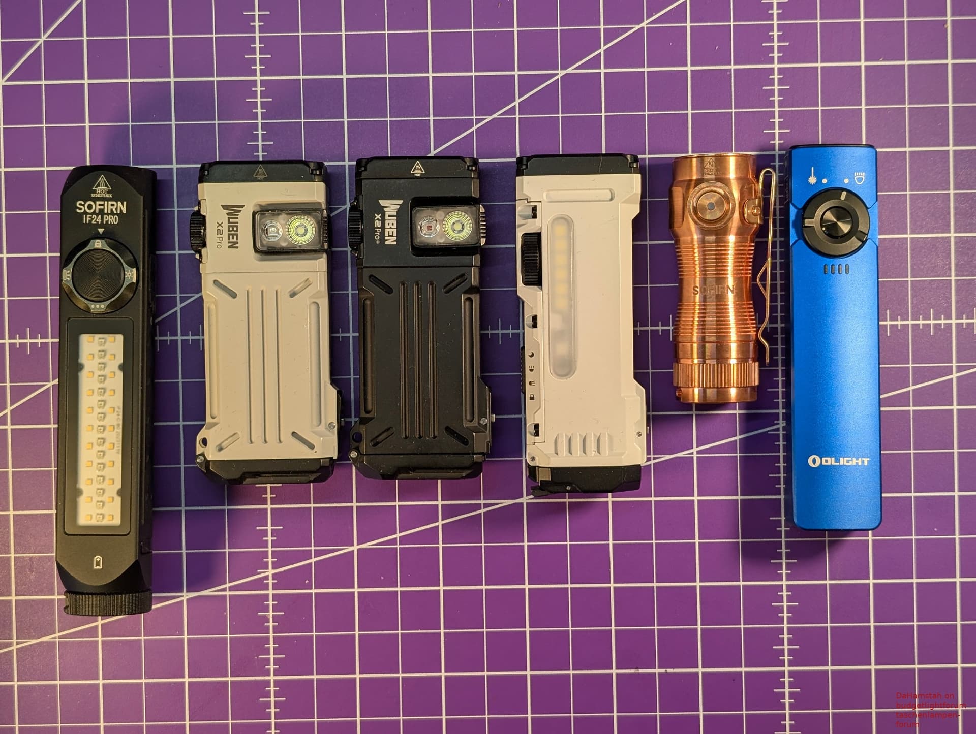

Sofirn IF24 Pro, X2 Pro, X2 Pro+, X4, Sofirn SC13 copper, Olight Arcfeld.
The size is unchanged from the original X2 Pro. The light weighs 136g, and I measured 92x41x25/20mm (incl./excl. clip).

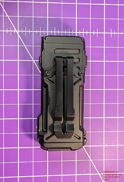

  • Clip: The clip is unchanged and therefore equally good. Stable, good tension, good attachment with screws that don’t block the path into the clip, enough space even for thick pocket hems.

Slide switch on Lock: Button and thumbwheel deactivated.
Slide switch on Sidelight:
  • No shortcuts from off, only single-click with memory for on and off.
  • From on: Hold to switch between white and red.
  • Turning changes brightness (both white and red).
  • Double-click in red leads to a beacon, which can be adjusted in brightness.

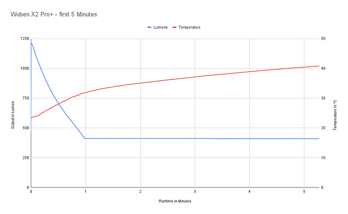

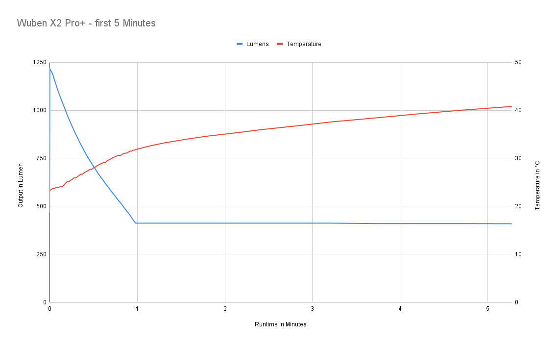

The beam profile of the main LEDs is the same as the X2 Pro (and X4) when all LEDs are on. No crazy throw, but a balanced beam with good spill and a soft spot. Good for most everyday tasks, if you ask me. If you need it floodier, there is the side light. This results in a slightly narrower light cone, which is, however, beautifully uniform. The two white light sources complement each other well, I could also imagine a version of the light with high CRI side light.

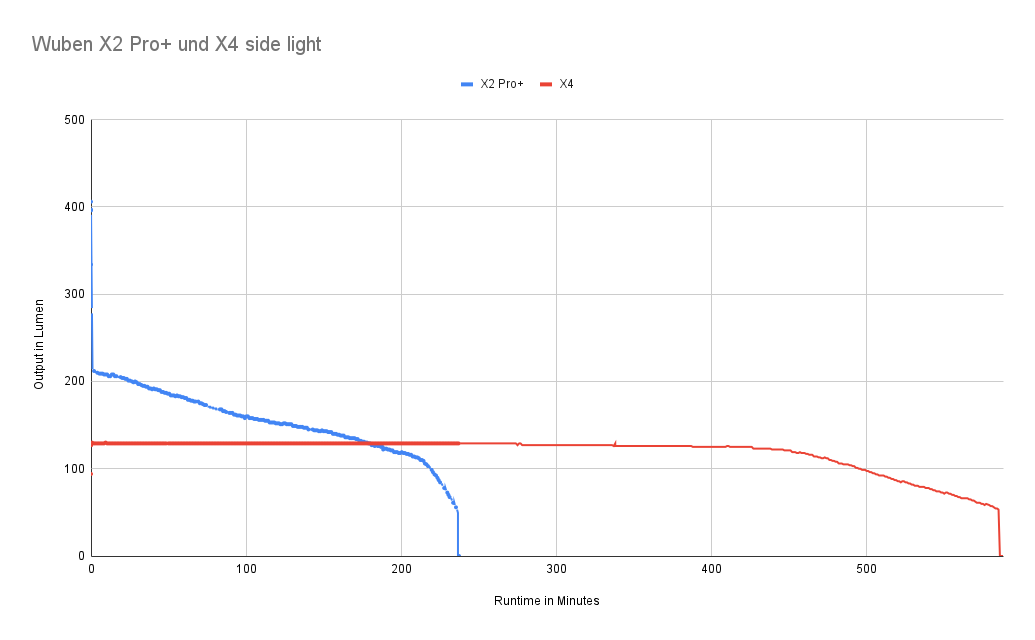

The light lands at almost exactly the same values as my X2 Pro. Just under 1500 lumens, the brightness follows the battery voltage. I have followed many discussions about regulation; there are certainly fans of this declining brightness, but in this point, I prefer the characteristic of the X4, which holds its brightness constant.
On the other hand, the X2Pro + can be operated with 1.5V cells. The X2 Pro+ does nothing magic and I did not conduct a full runtime test since the differences between 1.5V batteries and 1.2V rechargeables can be quite large. With (older) Eneloops, the light reached 160 lumens for the front light and 120 lumens for the side light.

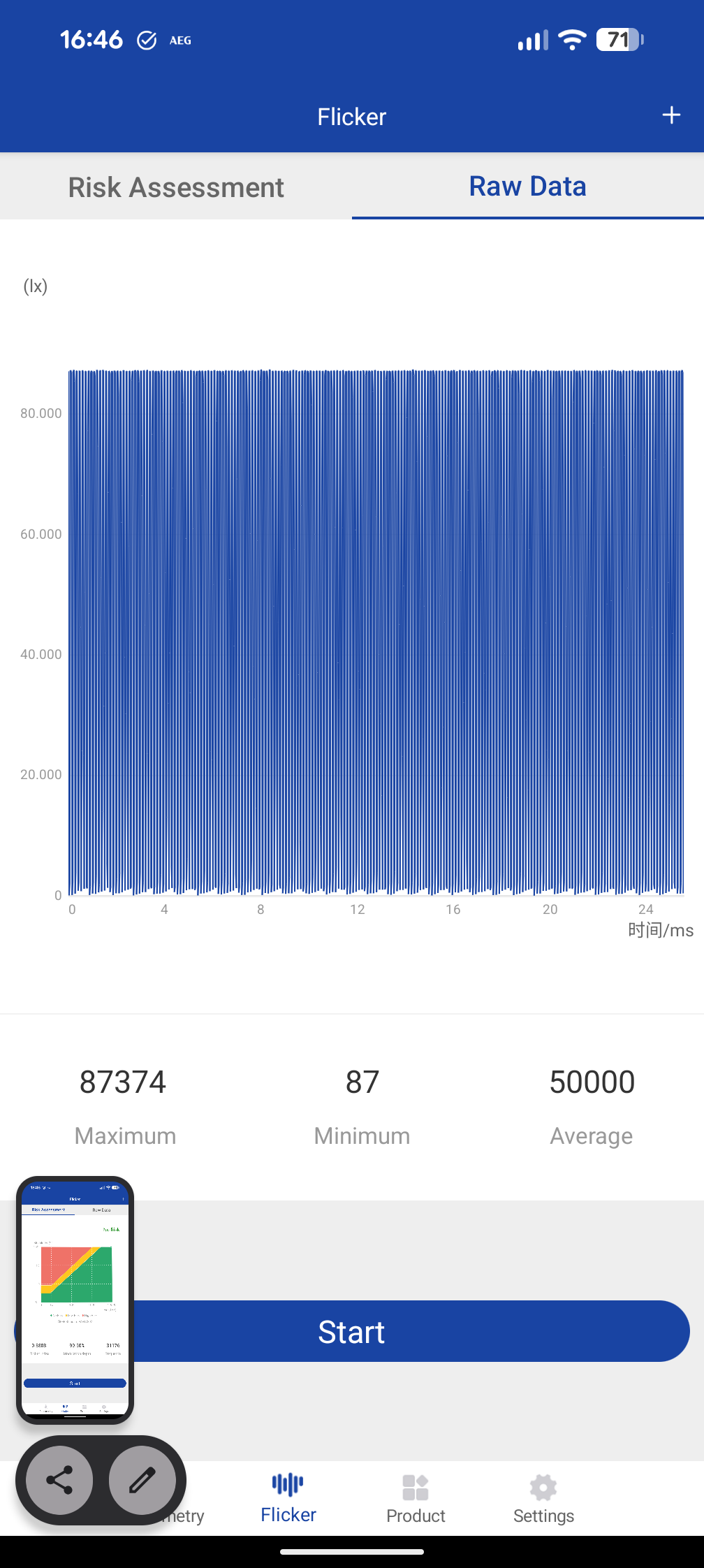

PWM: I could not detect PWM with my eyes or a camera.
Flicker is in the same range on all (white) output modes:
