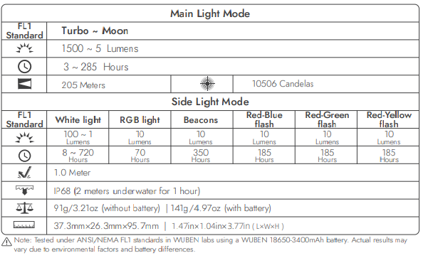

Specs by Wuben
You can find all information on the manufacturers site:

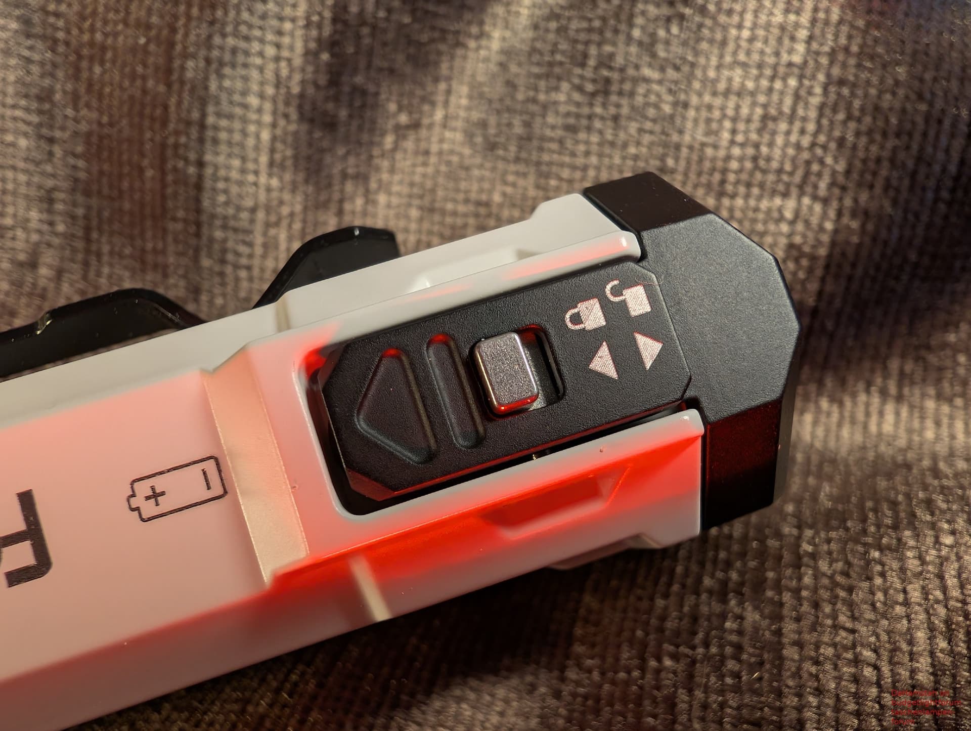

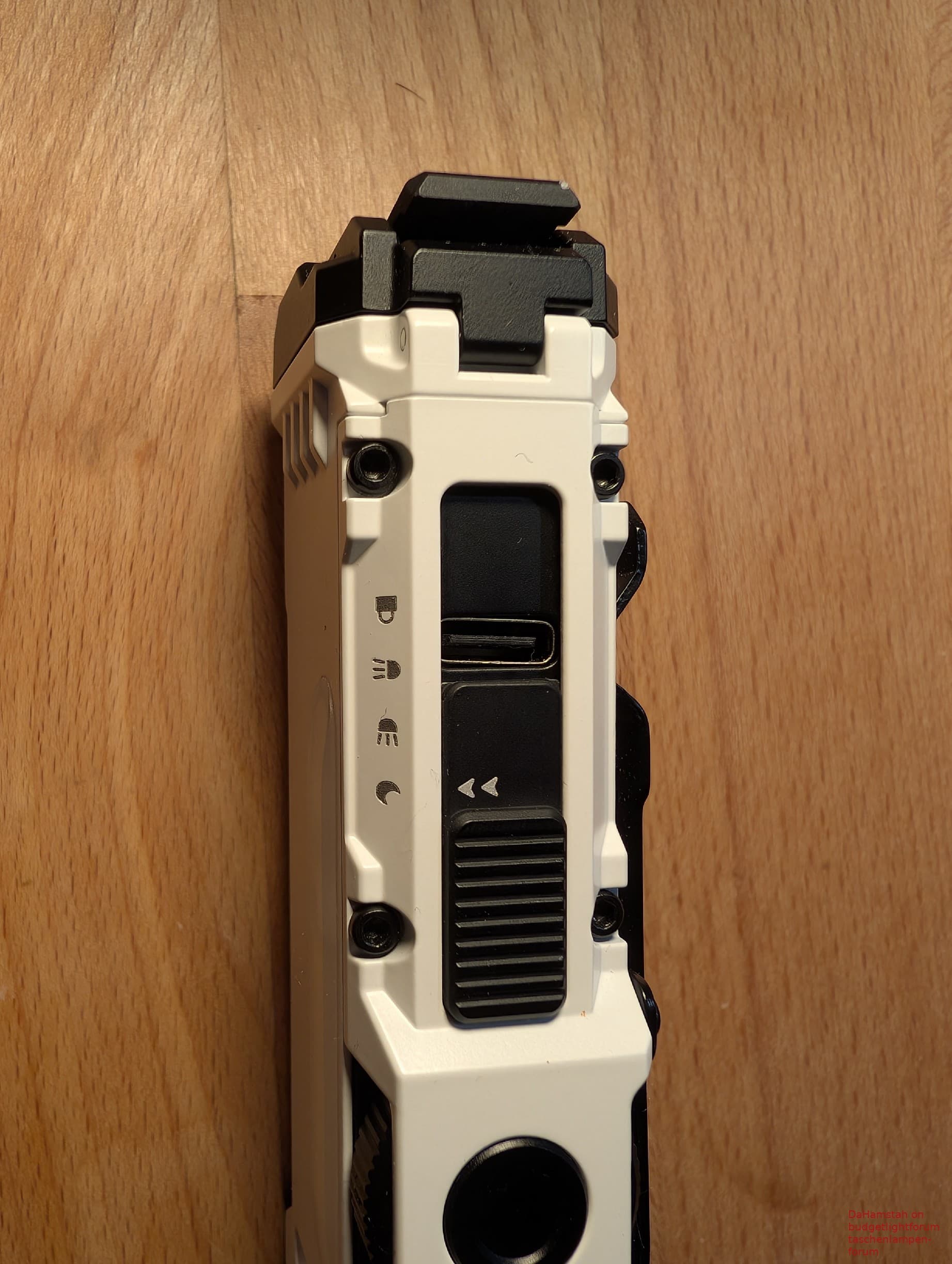

The side slider has enough resistance to not get dislocated in my pocket, every position is easy to find. It’s nicely sized, better than the mini slider on the X2 Pro. I was suspicious if it would work while using the side switch. Before holding the X4 in my hands, I thought that the X2 Pro slider would be better in EDC use, but surprisingly I found the X4 slider to be easier and more comfortable to use.

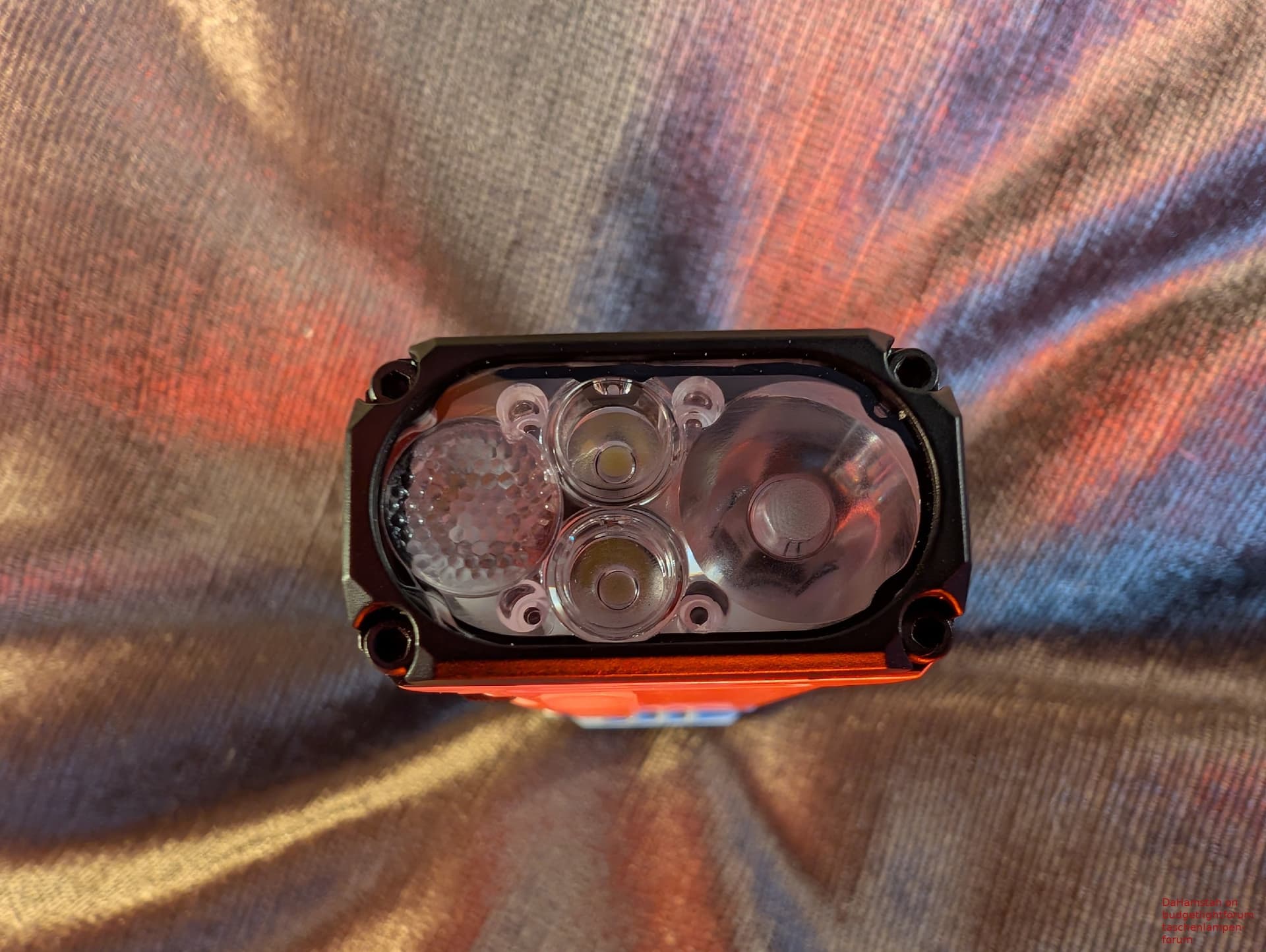

The optics are the same as the X2 pro, also not covered by glas. Fine for me, no glass that can break and some scratches wont hurt the performance.
The USB-Port is hidden under the side slider. I like ports that are waterproofed internally, that’s way safer than a rubber flap and the slider protects it against dirt. Very good solution.

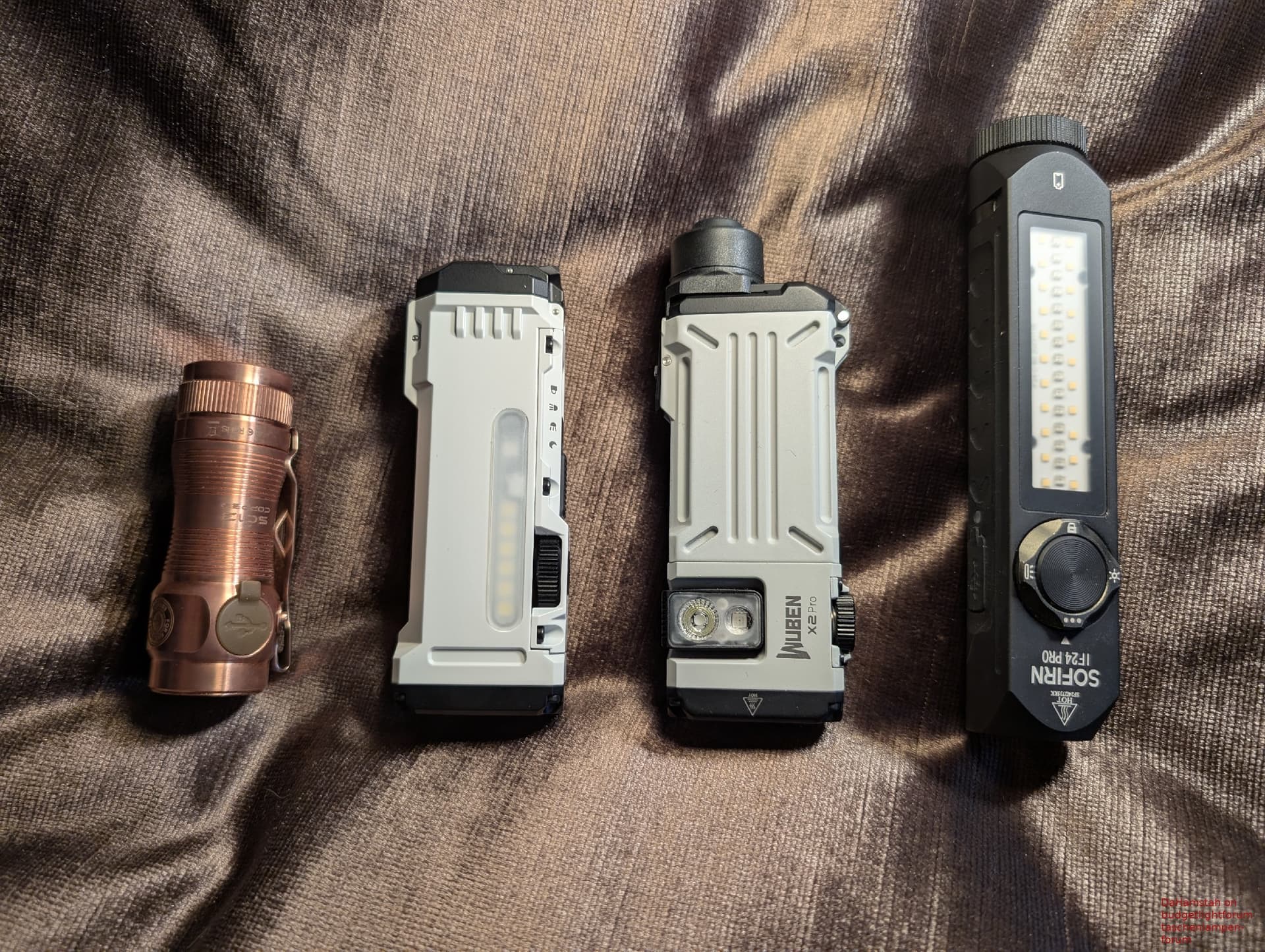

I measured the light on it’s thickest parts including the clip and battery to 143g and 96 3 35,3 x 26mm
left to right: Sofirn SC13 Copper, Wuben X4, Wuben X2 Pro, Sofirn IF24 PRO

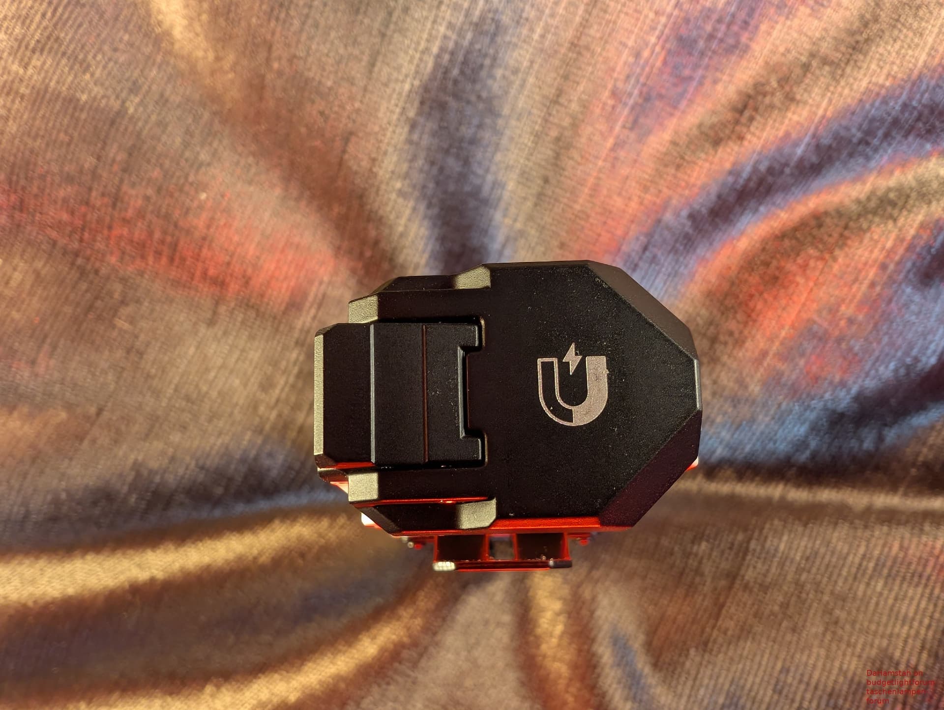

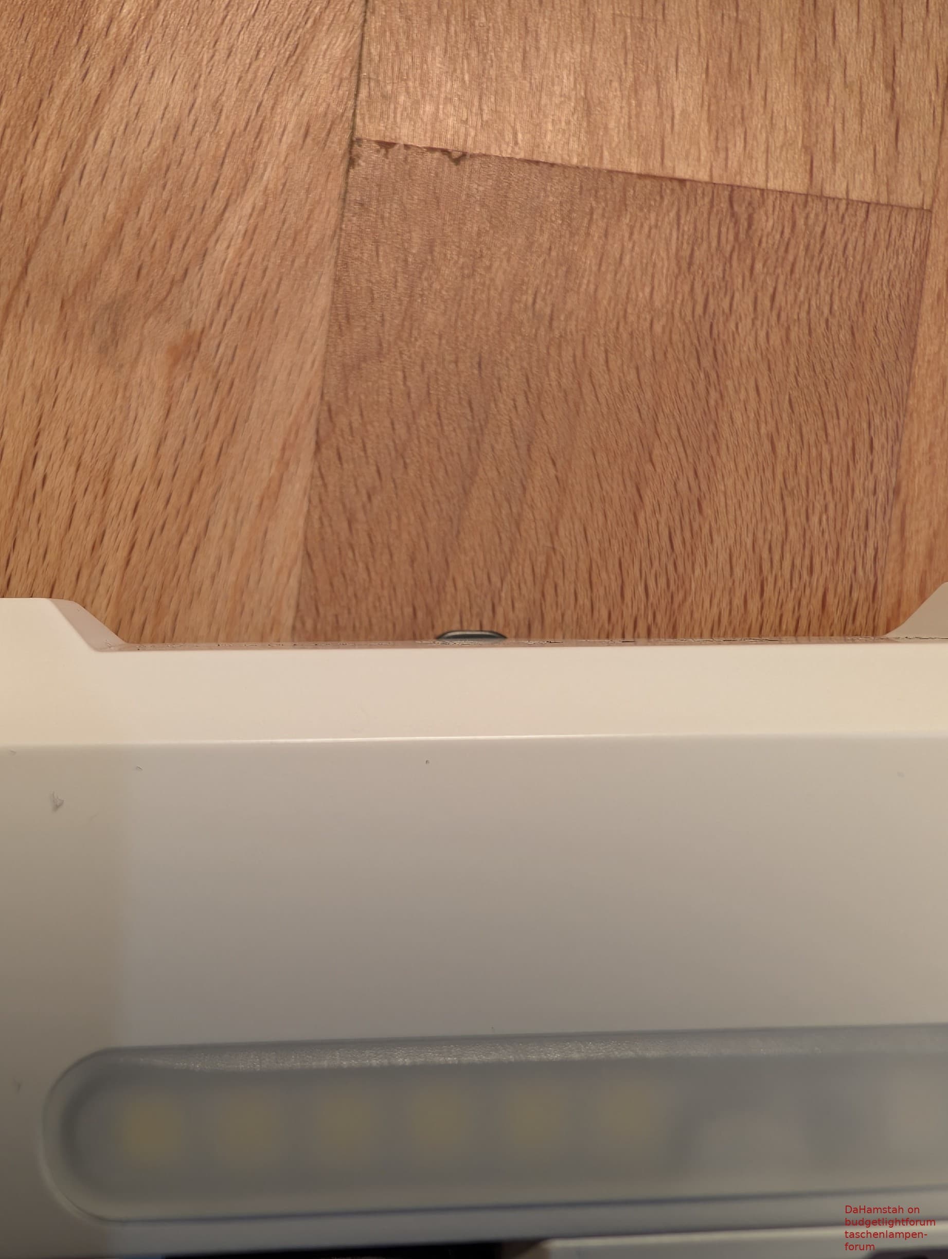

Magnet: There is a magnet in the tail. It is a bit weak, most likely because the lights doen’t sit flat on surfaces because of the tail switch. As long as the surface isn’t slippy, the light will stay put in horizontal position. So it works, but it could be better.

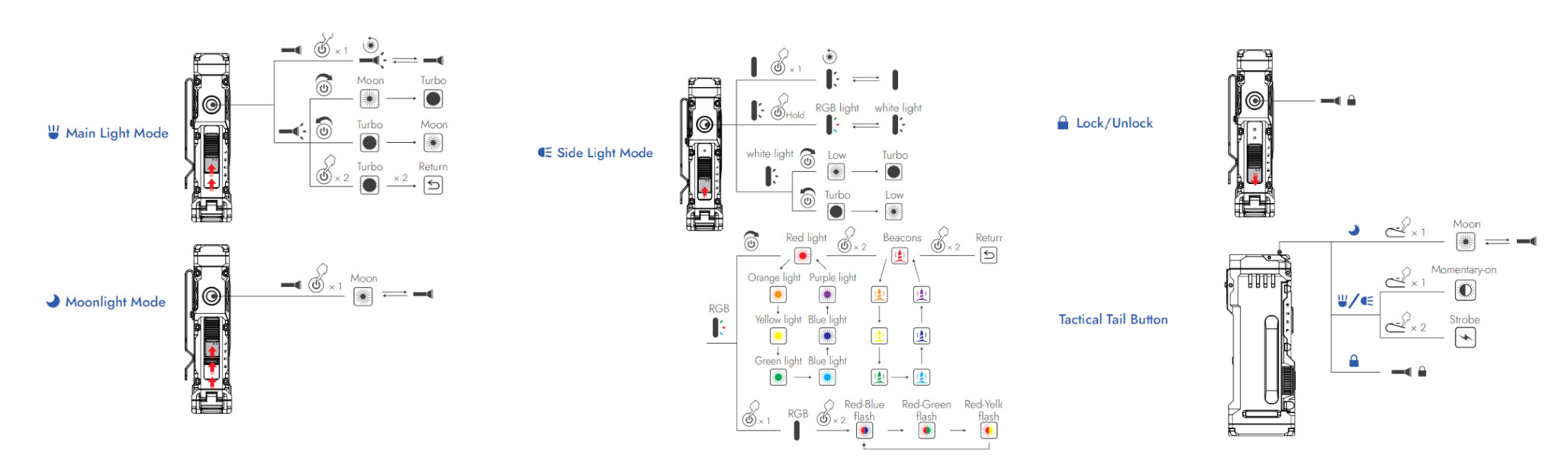

And Wuben listened. And they didn’t only make it better, they made it good! Have a look at the UI table in the manual:
Looks complicated? In fact, its very intuitive. Let’s explain it starting with the side slider:
  • Lock - Everything is locked.
  • side light: side switch and wheel control the side light, back switch goes to momentary turbo on the front light
  • front light: side switch and wheel control the front light, back switch goes momentary turbo on the front light.
  • moon: wheel doesn’t do anything, side switch and back switch active moon (no momentary)
  • There is strobe: with the side switch in sidelight or frontlight position, double click the tail button.
There is a little inconsistency with the back switch, I would prefer it to be always momentary. I found myself not only once activating moon permanently with the back switch while I intended to use it only for a brief moment, like I do it with turbo on the other side switch positions.
In the side switch mode, as already mentioned, the back switch goes to momentary turbo. Controls for the side switch are:
  • click for on/off
  • hold from on to change between RGB and white
  • Wheel controls brightness on white and colour on RGB - the brightness on RGB ist not changeable.
  • From off, a double click activates a two color flash, further double clicks cycle through red-blue, red-green and red-yellow, memorizing the last used mode.
  • In color mode, you can activate a beacon in the selected color with a double click
In the front light mode, controls are easy:
  • Click for on/off
  • Wheel controls brightness from moon to turbo
  • double click goes to turbo, another double click goes back to the previous brightness.

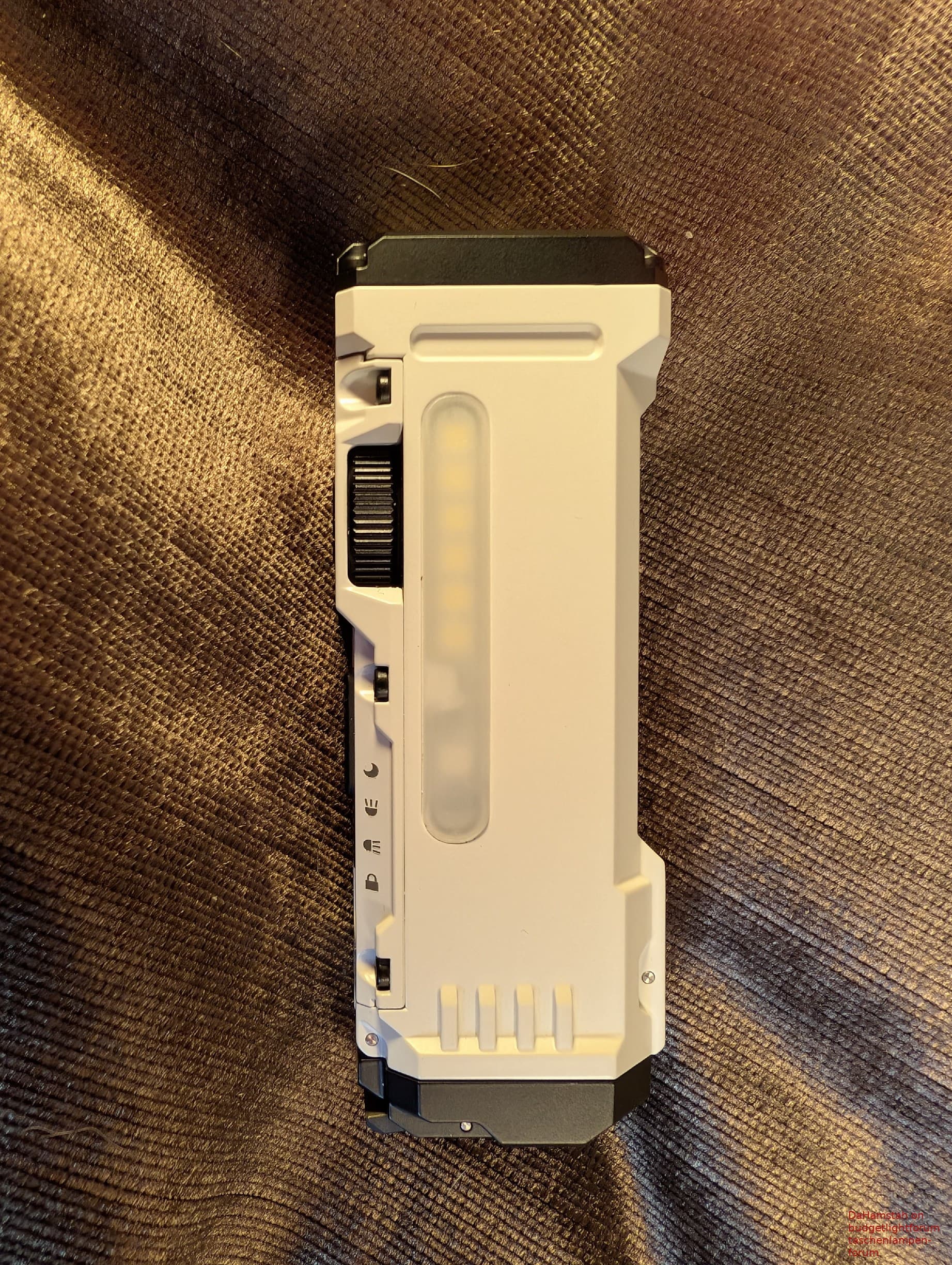

Colors in the side light are preset, you can choose between red, orange, yellow, green, light blue, dark blue, purple.
If you use the wheel to change the brightness, it’s mostly smooth and nearly stepless (there are steps, but wuben did a good job with the transition). There is a bit of a jump if you start at moon. Could be smoother, but nothing you wouldn’t experience using a light with preset modes.
There is no more focus option like in the X2 Pro. The UI profited heavily from this. Just for the sake of playing around with it, I wish a triple click could change the wheel from brightness control to focus control.

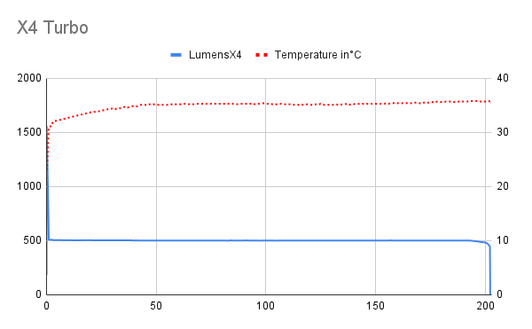

Measurements are done in a 30cm integrated sphere with a TSL2591 lux sensor. I didn’t have the chance to use a calibration light until now, but it is dialed in quite good and matches the values of other reviewers very closely. Keep in mind this is hobby equipment and measurements can be flawed. The temperature is measured on the head of the flashlight, but i can’t guarantee it’s on the hottest spot. In addition, I use an Opple Light Master III.
As mentioned in the section above, Wuben removed the focus option on this light. It was so fun to play around with on the X2 Pro and worked really good! But to be honest, I didn’t miss it while using the light. The beam profile is nice, a wide, bright spill with a smooth transition to the big spot. Of course the throw is limited, as always with small lights, but I found the beam very useful for EDC, walking the dog,…

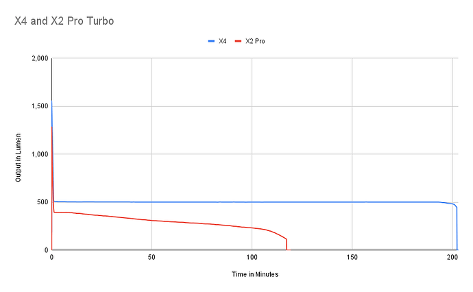

The side light is pure flood and warmer. Compared to the X2 pro it might seem like a downgrade at first, as it has basically a Wuben G5 integrated. It’s not like that, they are simply to different to compare. Each has it’s own advantages and disadvantages. The X2 pro steps down to around 200 lumen very quickly and is unregulated, the X4 keeps its output steady. I measured 125 Lumen, so quite a bit over spec. I double and triple checked that, but it also corresponds to my optical impression. Very nice!
The front light hits the spec at startup, quickly stepping down. But after the stepdown, it’s regulated very well. I think this (and only supporting one battery type) is the main reason wuben ditched the focus - it’s not easy to regulate the output if you have the LEDs on different channels, and it gets nearly impossible if you want to keep price and size reasonable. Good decision, if you ask me.
