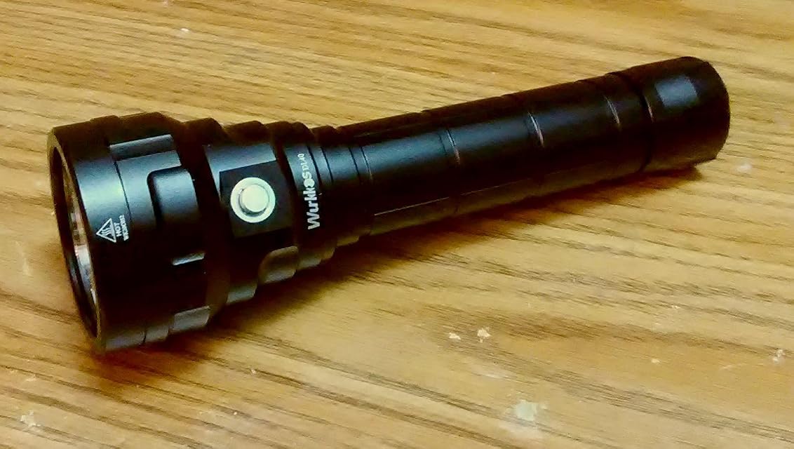

Being a fan of Wurkkos lights like the WK20 and WK30, I gave the DL40 diving light a shot. I like diving lights because they’re pretty much guaranteed to be waterproof in case of rain, getting dropped into a pool, etc., whereas other “waterproof” lights might merely be water-resistant. This is a big light, a nice solid big light! It takes a pair of 26650s for lots (and lots and lots…) of runtime. Each cell is rated 5000mAH, which is spot-on in agreement with what my Opus says. Plus, the extra heft makes it shed heat quite well and not turn into a curling-iron if you leave it on turbo for too long. Underwater (as in diving), you’re talking about quite many gallons of active cooling.

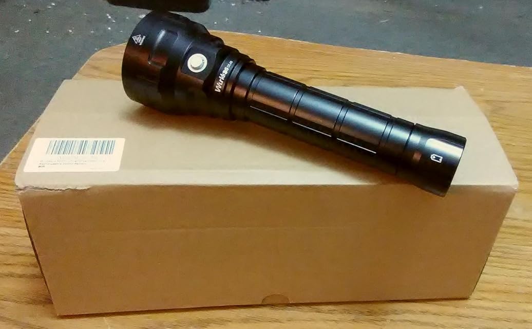

DL40 in profile.

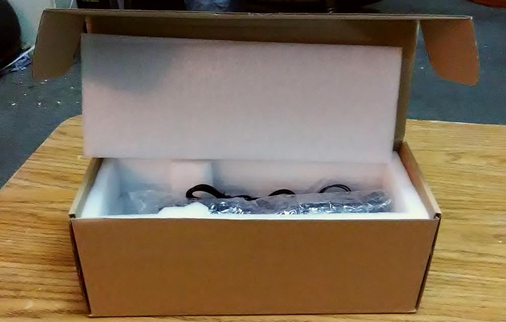

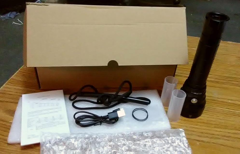

That said, the box that arrived was a nice locking-lid cardboard box lined with white foam. Inside were the light with cells inside, lanyard, 2-bay charger and usb cable, extra O-rings, and adapter-tubes in case you want to use 18650s in a pinch, as well as a multi-language user guide. You’re pretty much good to go at that point.
DL40 shipping box, just opened (top), and with goodies taken out (bottom).

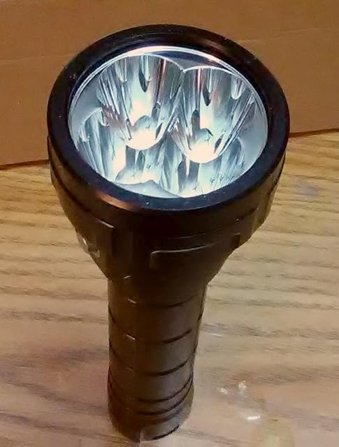

Four LH351D LEDs provide the light output, a nice neutral 5000K of creamy white goodness, the same LED that powers the WK30 and similar lights. Each LED in its own reflector will show a somewhat “flower-petal” pattern in the outer beam (spill), but the hotspot is perfectly circular. There’s a slight yellowish tinge in the corona, but it’s not objectionable, and in fact not even that noticeable except if you go white-wall hunting.
DL40 head, showing the 4 reflector-wells.

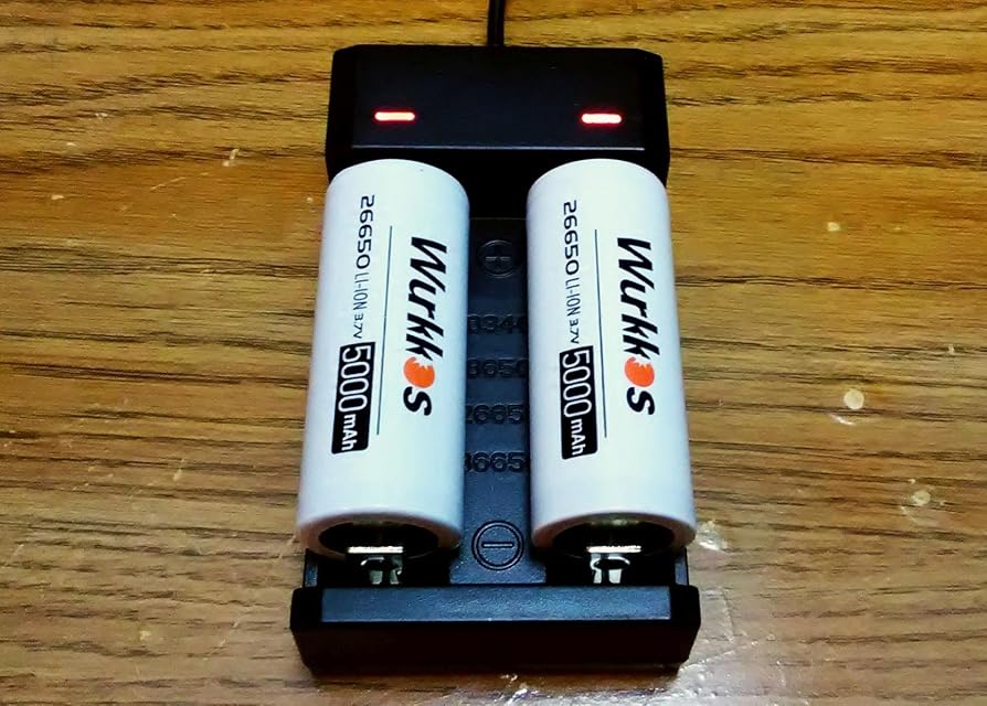

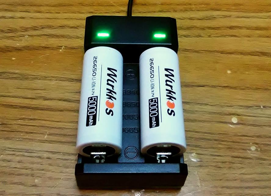

Charging the cells initially via the included charger is a breeze, too. Pop in the cells, connect to a USB charger or even just a computer port, and let it go. The lights will indicate red while charging, green when done.
Charger, while still charging (red, top) and when finished (green, bottom).

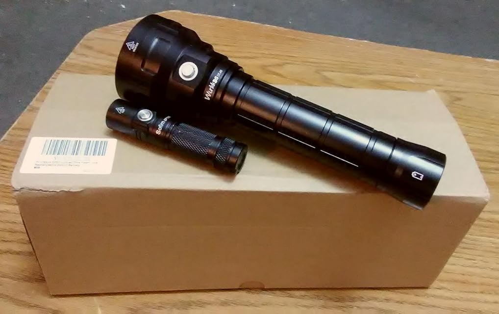

So, unlike a lot of diving lights with only one cell and limited runtime, the DL40 should keep going, and going, and going, with a pair of beefy 26650s powering it. It’s a nice big light with a good grip, that’s not limited to diving. Anywhere you’d need a light to be absolutely waterproof, the DL40 is a great option to have. Me likey! :laughing:
DL40 on its box (top), and compared in size to an SP10 (bottom).
