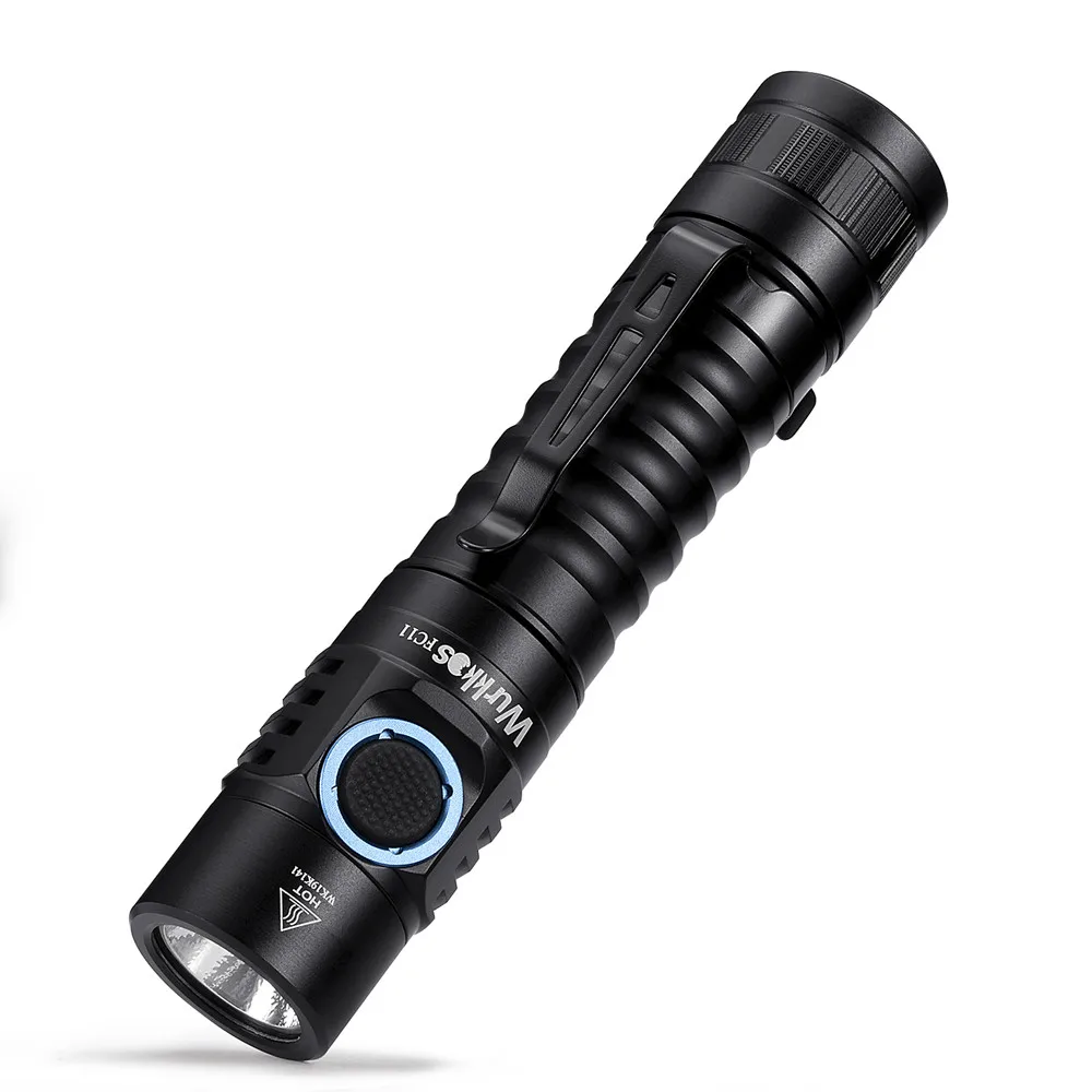

This is a relatively small and elegant flashlight! The anodizing is shinny and smooth (on touch), but it seems to be hard anodized. Time will tell and my aunts will “test it” ![]()
The flashlight fits well in the hand, with a very ergonomic design, at least for my experience. The big switch button is a big plus in this flashlight, making it usable with gloves too (well, winter is here already), and allowing it to be easily located. The “wavy” knurling is also a plus for a better and more comfortable grip.
There are no visible imperfections in the knurling, grooves, threads or other any visible part of the flashlight.
Speaking of grooves and threads, the head has some cooling fins on the sides. As for the tube threads, they are square, arrived slightly lubbed, and thread in/out pretty well without squeaks. They are anodized, except on the edge of the tube (to make proper conductive contact).
Going further down, the pocket clip can be used only in the lower part of the battery tube and it can be easily rotated within its’ groove. It is not a deep carry clip, but has good retention.
As for the tailcap, it is magnetic, has a lanyard hole, and some vertical knurling all around. It is flat and allows tailstanding without issues. Inside there is thick but “flexible enough” spring, that allows a good accommodation for protected and unprotected cells.
Back to the head, from the top we see a non AR Coated lens, an Orange Peel reflector over a white gasket and a Samsung LH351D 5000K 90CRI Led. The bezel is glued, and outside we see “HOT” signal and the serial number right below it. In my sample, these engravings are aligned with the switch.
On the lower part of the head, inside, the driver can be seen, and it has a spring for the contact with the positive pole of the battery.
Below the rubber switch - that has a blue metal ring around it - , there is another engraving, this time with the brand logo. On the back side, there is the USB-C port, covered by a rubber cap (which can be displaced and put back in place without being removed). Below, there is ths ROHS and CE engraving on white.
The flashlight can be dismantled in 3 main parts: head, battery tube and tailcap.
I said this was a small flashlight and it is, and also “lightweight”. I forgot to measure the diameter but it is around 27mm in the head.
