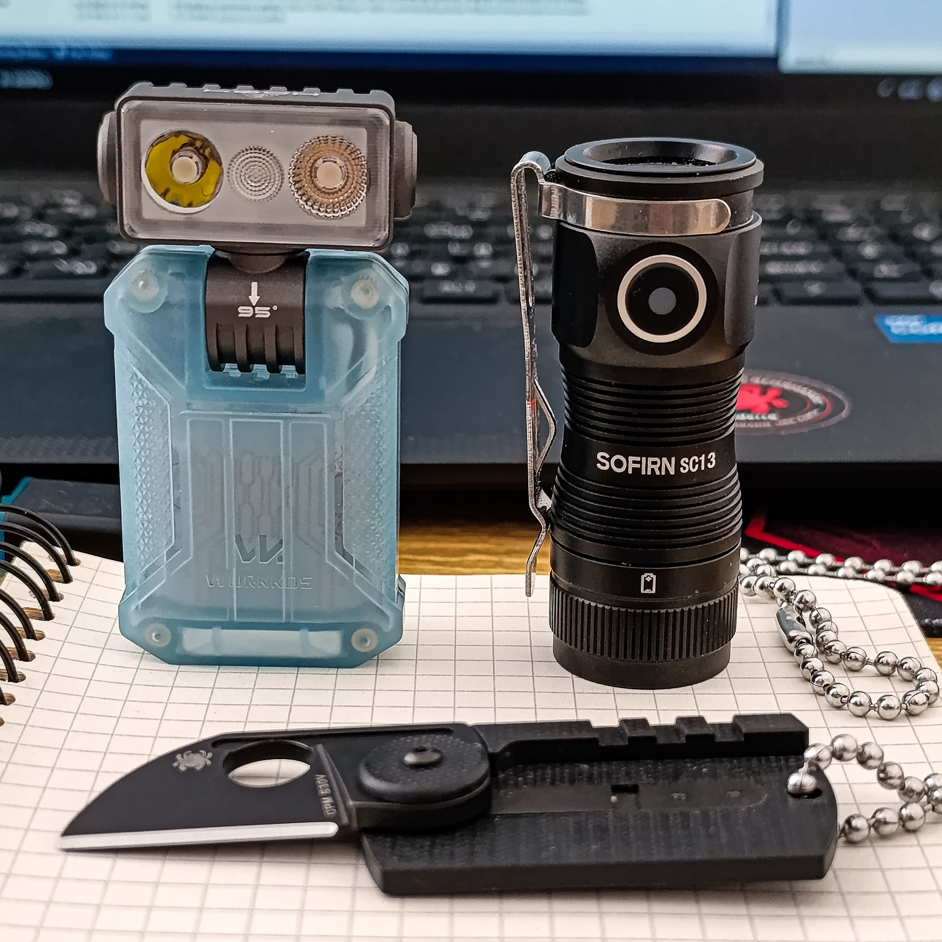

Once you have freed the light from its packaging, one of the first thoughts will probably be: “Oh, it’s so cute!”
The design immediately completely won me over!
Many small details are taken into account, even on the battery inside a print is visible that fits well with the aesthetics of the light.
The lower part of the light is completely made of plastic, just like the clip. Nevertheless, the light does not feel cheap. The head is made of metal, the cooling fins have slightly sharp edges. Overall, I would say that the light feels a bit higher-quality than the price would suggest - an HD03 with an aluminum body feels even classier though.
Plastic on the other hand has the weight advantage on its side, does not get cold, and does not deform during a drop - so the durability should not suffer.
But that is a good keyword, because the biggest feature of the light could definitely also be its biggest weakness. Because the head is not firmly connected to the body like on a normal light, it can be rotated and swiveled.
The head is freely adjustable with 95° swivel and 180° rotation. That should cover most adjustment requirements. The mechanism runs clean and smooth, an accidental adjustment can easily happen, though.
Everything sits tight, without play and wobble-free, I would definitely trust the light to handle a drop. However, I am definitely curious to see how the light holds up in the long run under everyday use, I am always skeptical about such joints. Even if, as with the HD04, there is no visible reason for it.
But let’s take a closer look at the head. On the front side is a TIR, not further protected by glass. It consists of three areas. A smooth one for the throw LED, a smaller one with beads in the middle for the colors, and additionally another one for the flood LED, this one with facets.
On the back is a USB-C port. This is not further protected externally, whether it is sealed internally I do not know. Even if only an O-ring is installed inside, that should be enough for the IP6 rating. The middle LED in the front serves as a battery indicator.
The two switches are located on the left and right sides of the head. Both are of the same design and easy to find. Operation should also work well with gloves.
