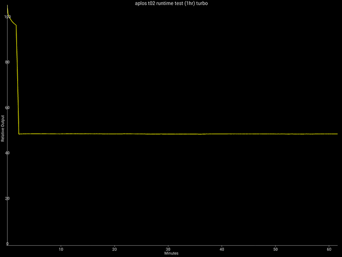

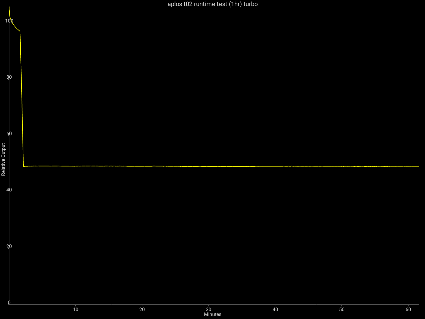

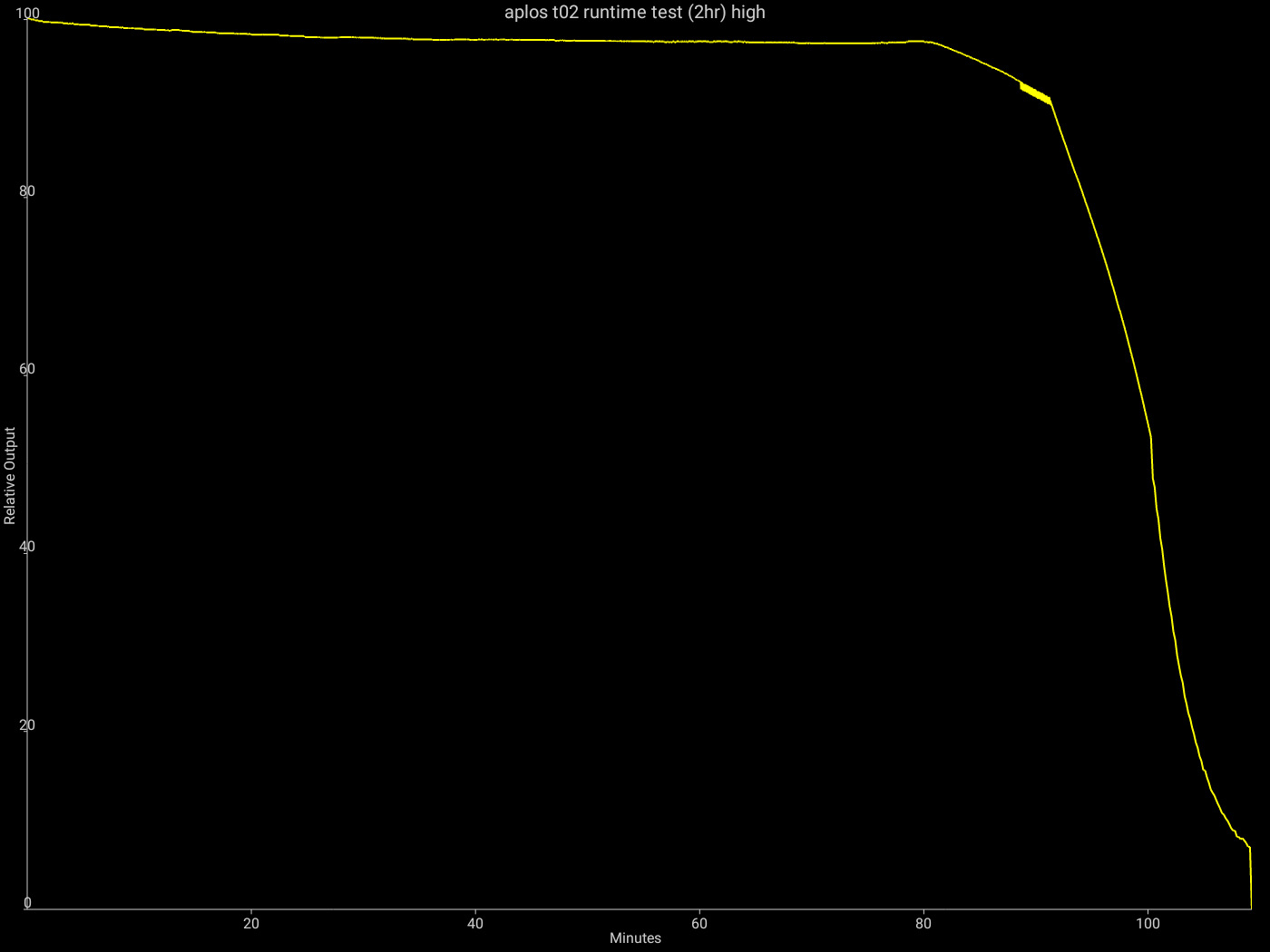

Yes it is regulated - very well in fact. The Aplos T02 is identical to td05 except for using 6500k sft40. I got mine from AliExpress super deal it was $16 - a very good price for this level of regulation.
