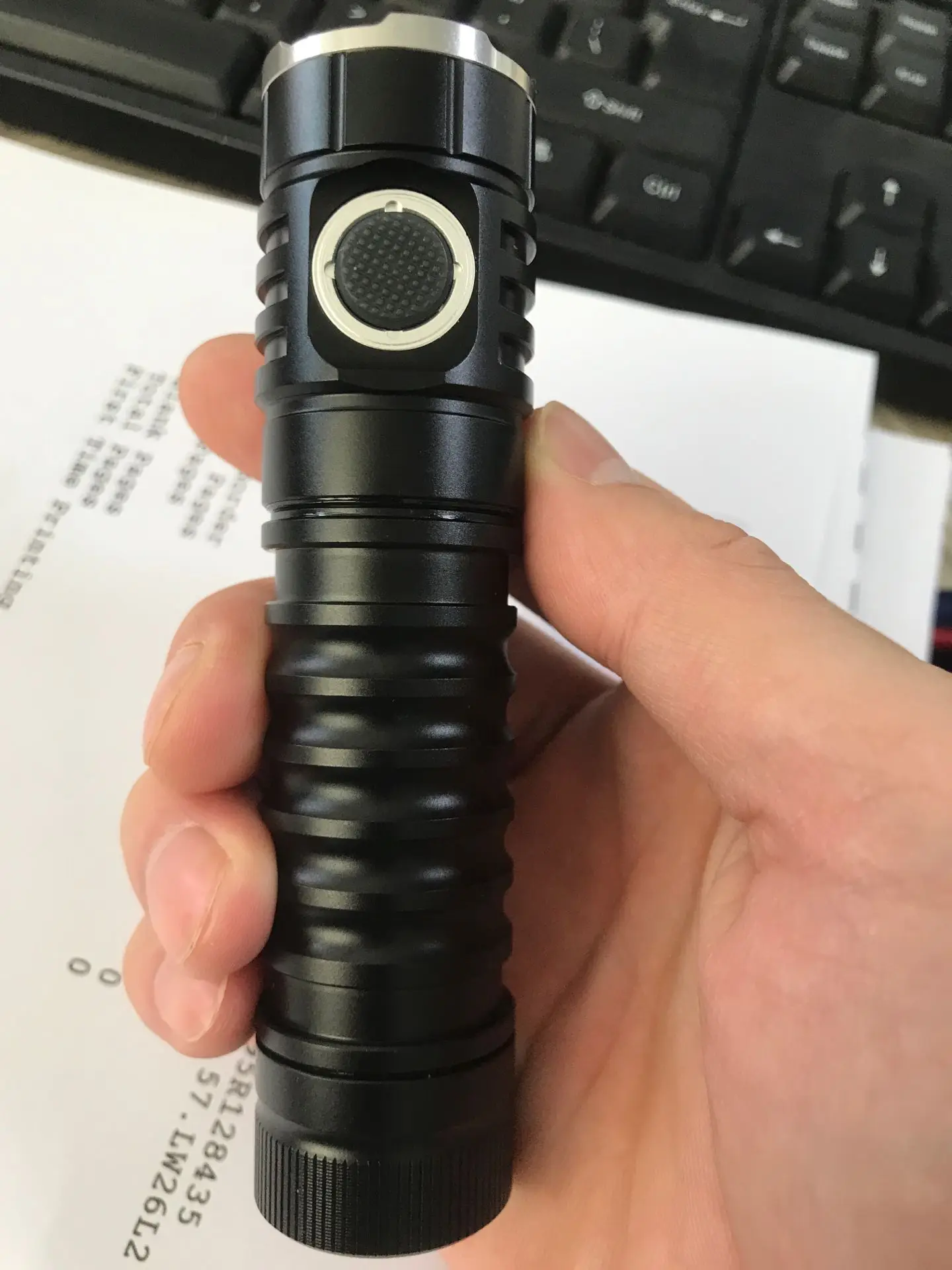

Yes, the switch of TS21 finally decided to change to rubber ones
