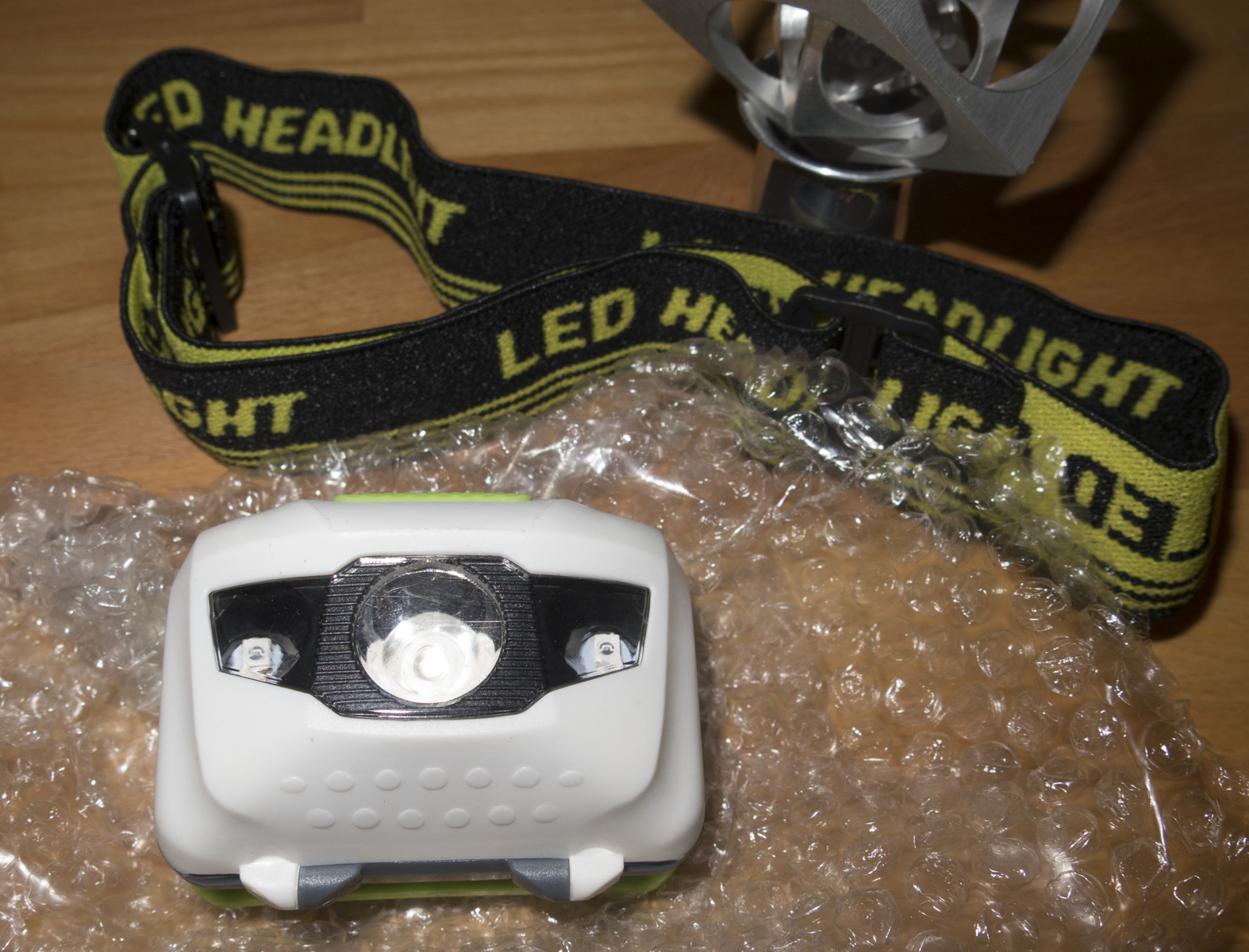

Package and content:
The lights box came packed in a plastic bag
The light comes in a small box
It comes with headband and light

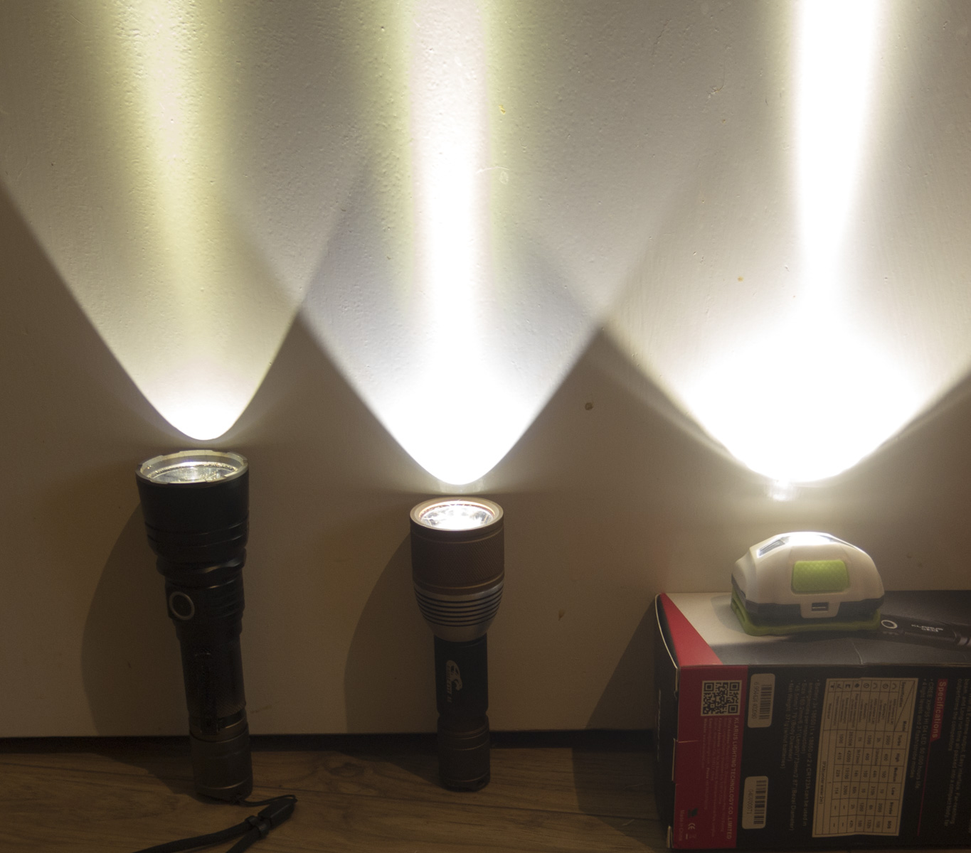

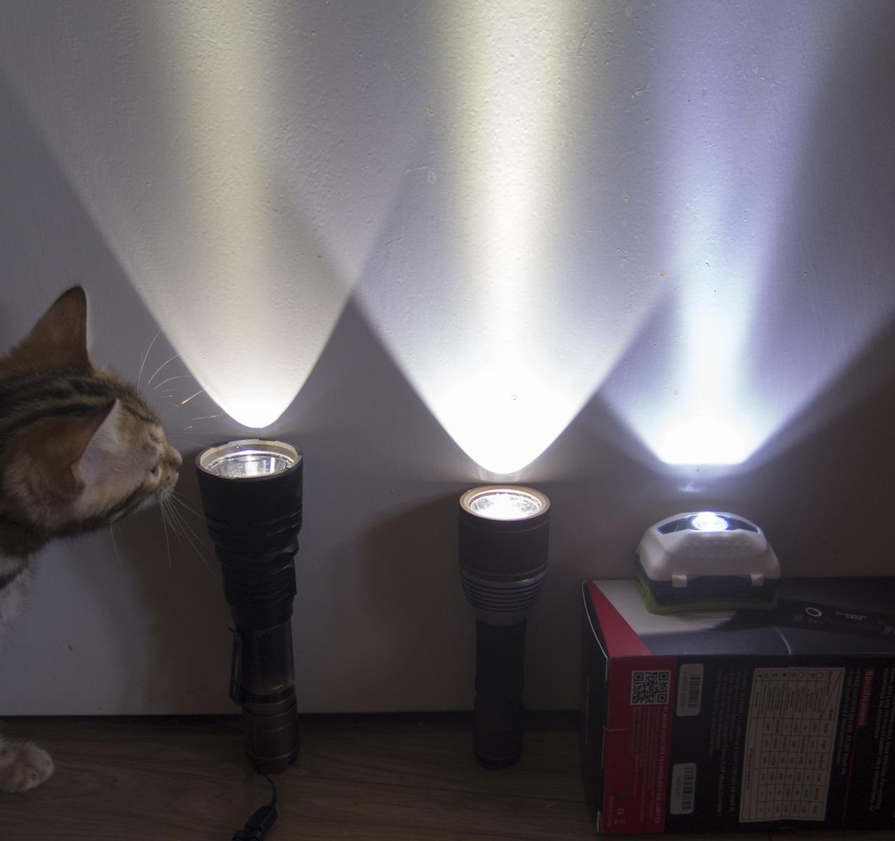

compared the light to a Cree 3C 5000K and 2B 6000K LEDs in lower modes
Klarus XT12 Cree XHP35 5000K, Eagle Eye XPL HD W2-2B 6000K, Xanes headlight
Beam color is above 7000K with a very aggresive purple blue tint

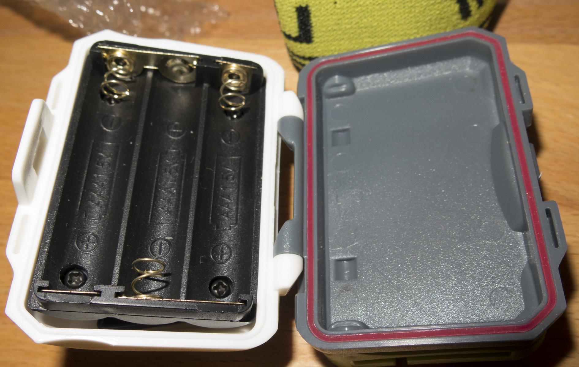

The light can be easily taken apart only 4 screws, the battery compartment got an o-ring
The light can be run with 3 AAA sized batteries

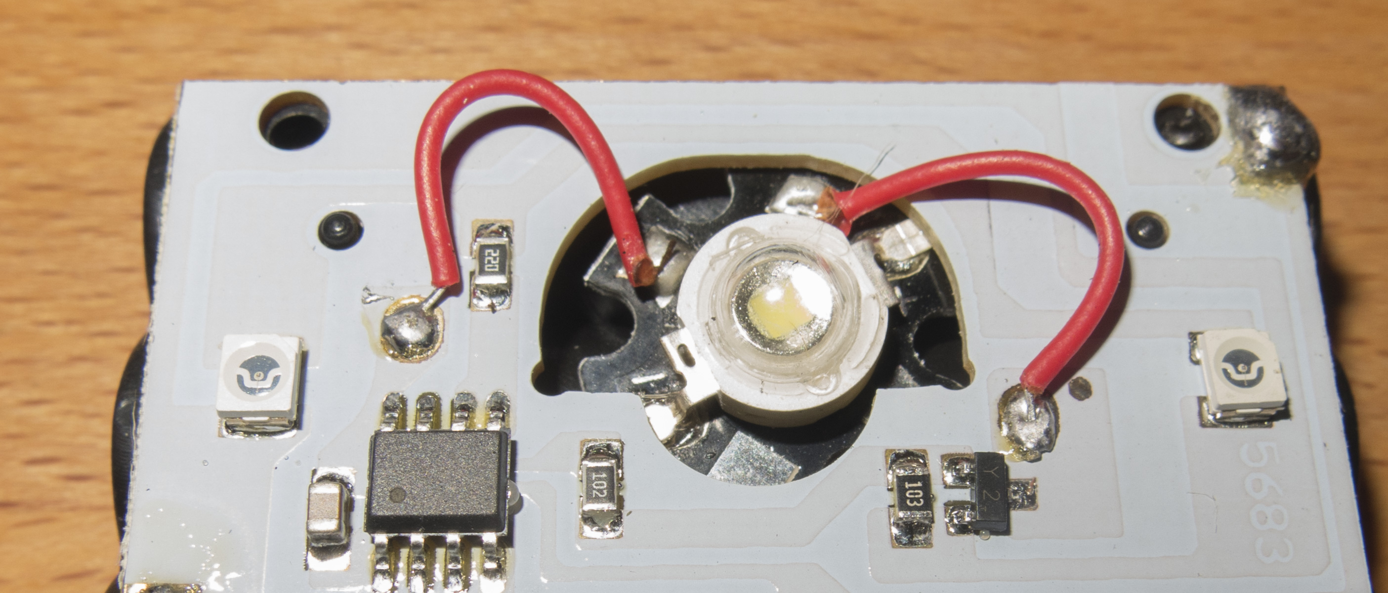

The driver is basically a MCU a transistor and some resistors

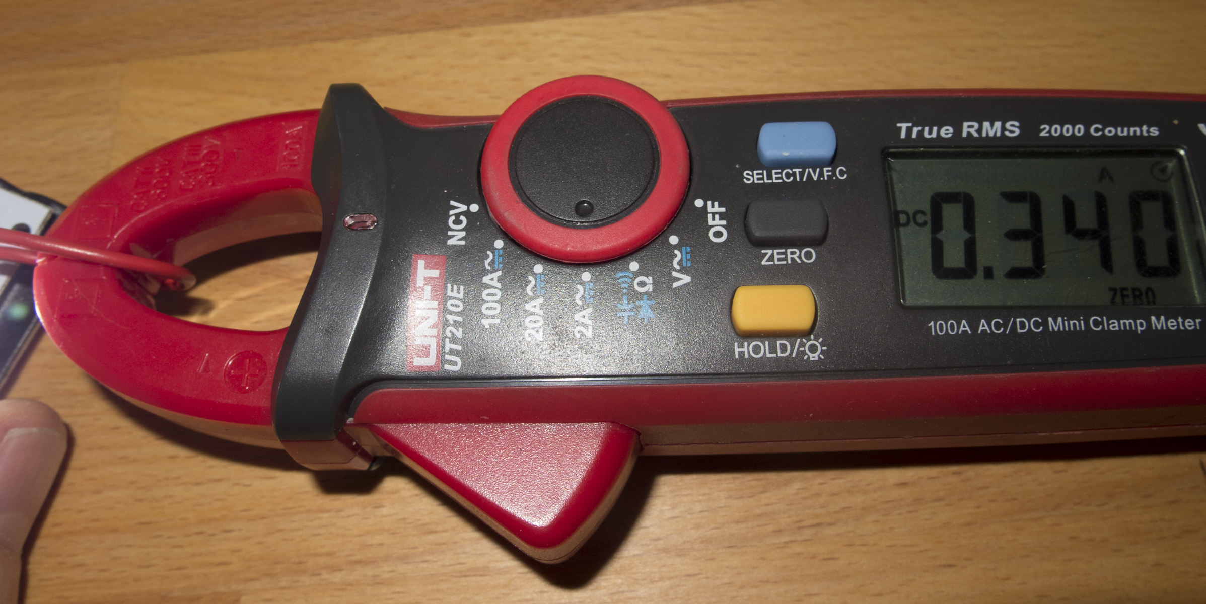

The light draws 340mA on fresh NiMh on highest mode

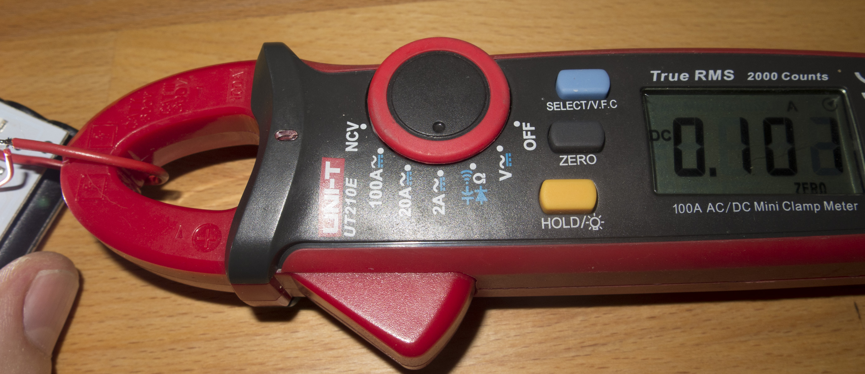

110mA on medium

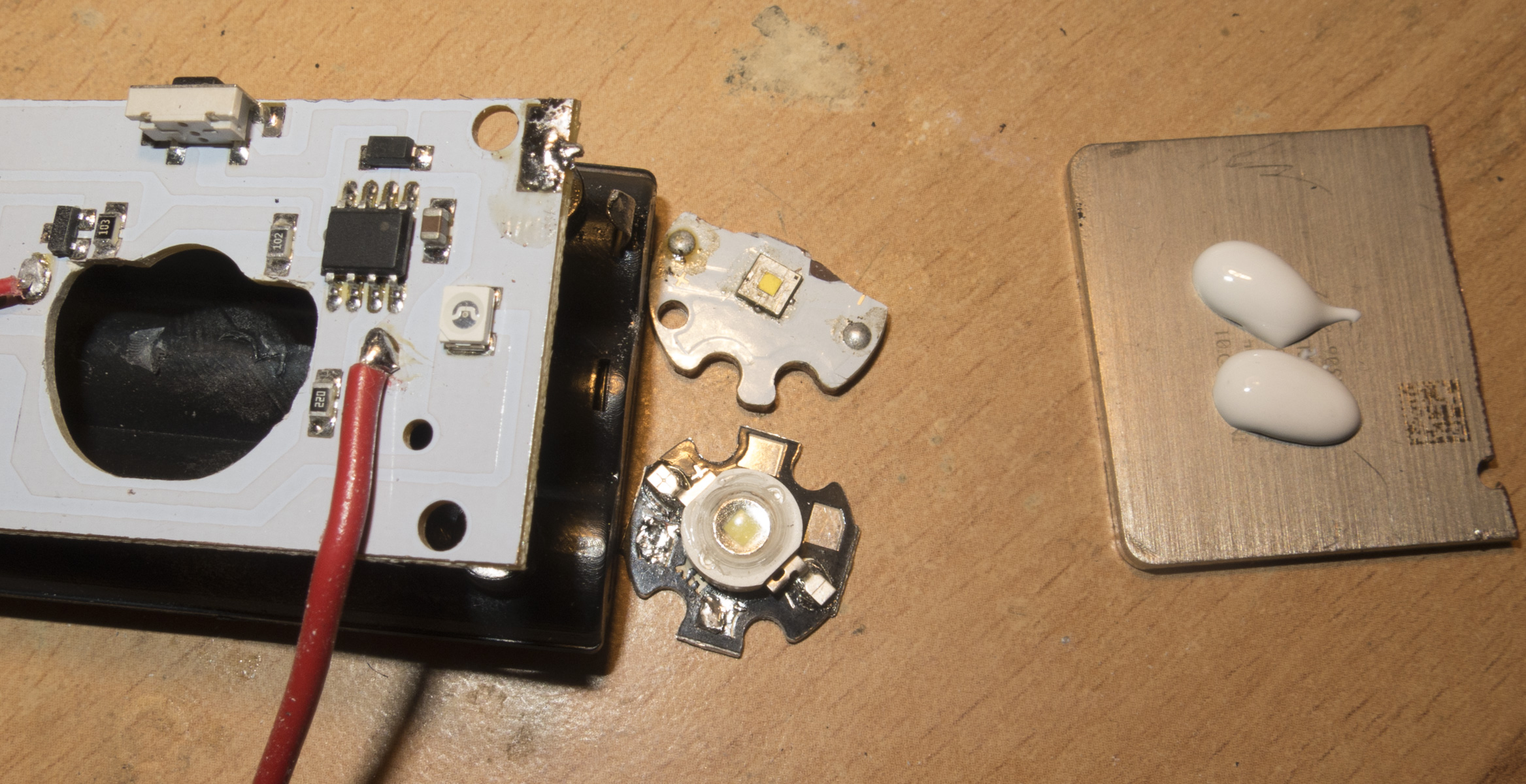

Modding:
First thing was to replace the LED, I had a dedomed XPG2 laying araund
I enhanced the heatsinking
I used an old copper MCPCB and a heatspreader from a CPU
Cut the LED board and driver PCB to fit
Then used thermal epoxy to glue the driver PCB, star and heatspreader together
The current and light output has increased
The light draws 620mA on fresh NiMh on highest mode
180mA on medium
compared to the original
