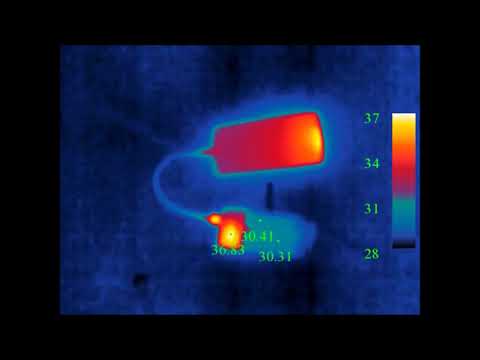

And here is a thermal pic of the phone being charged by the PB2S.
