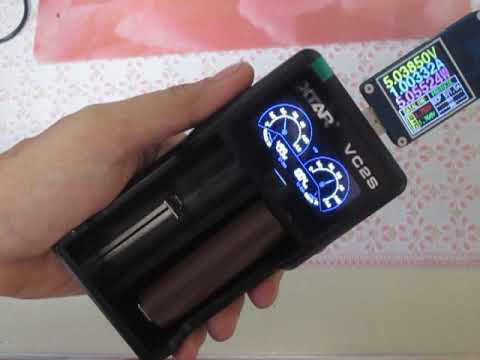

Power Bank
When using the charger as a powerbank, the cell must be inserted and the button pressed to start the charge. The display will show the voltage of the cell in the dial gauge, and the USB voltage below. The current out is also displayed.

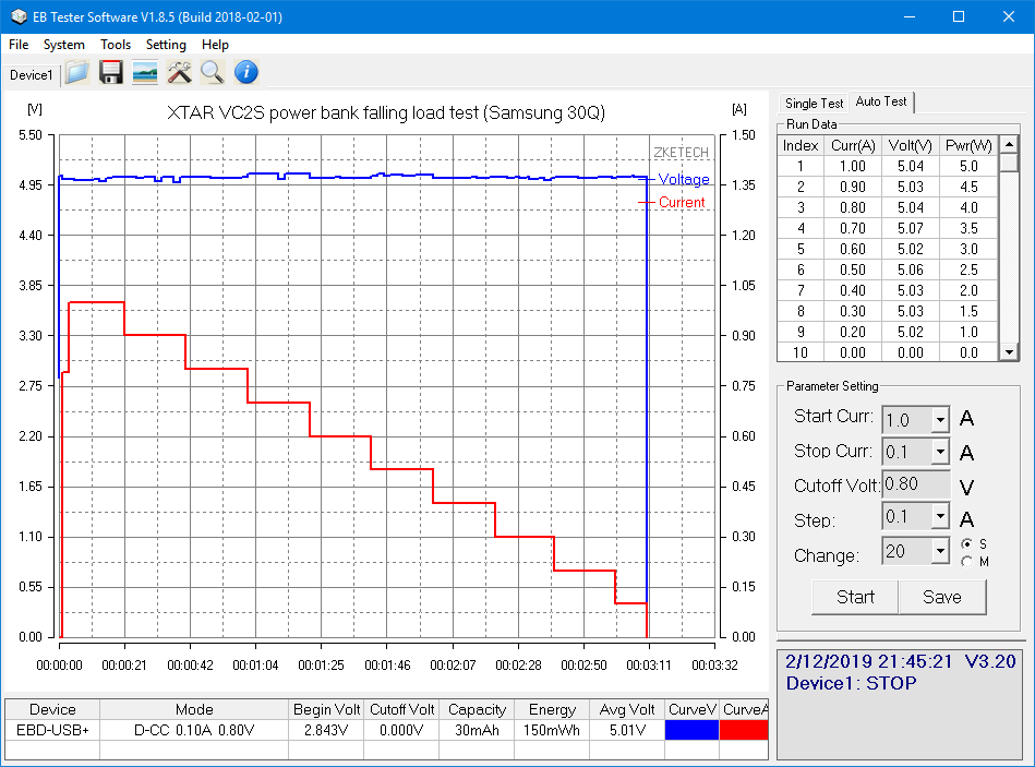

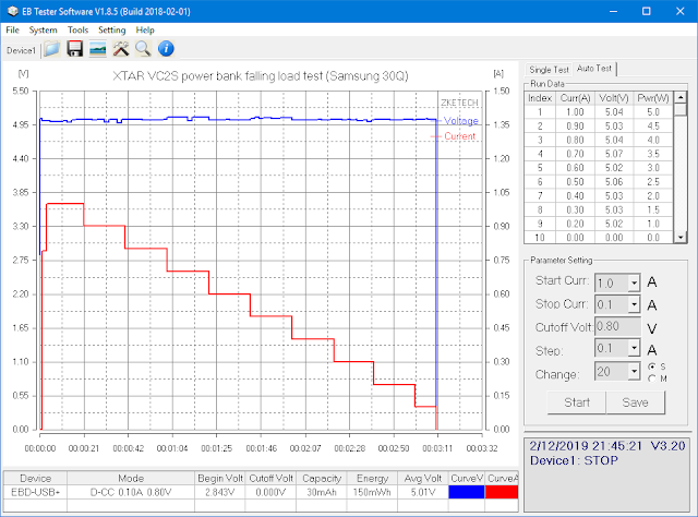

This charger is rated to provide a maximum 1.0 A current over the USB-A port.
Slowly increasing the current, I found the charger would not begin charging a device over USB unless over 0.2 A was drawn. The charger has no problems delivering the rated 1 A, and didn't cut off until attempting to pull 1.4 A.
Slowly dropping the current, the charger cut off between 0.1 A and 0.2 A. The power bank is ideal for charging mobile devices, but won't be suitable for very low current draws.
