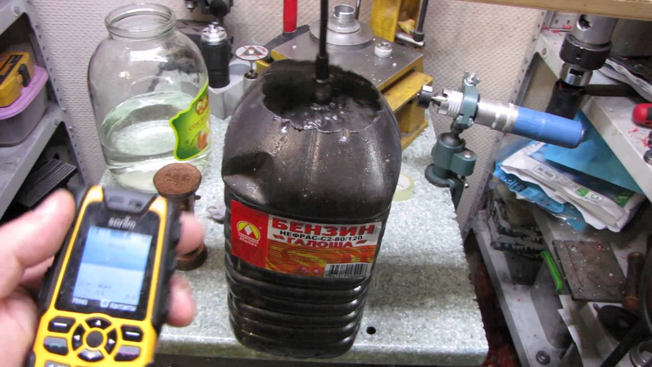

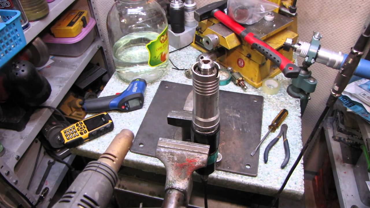

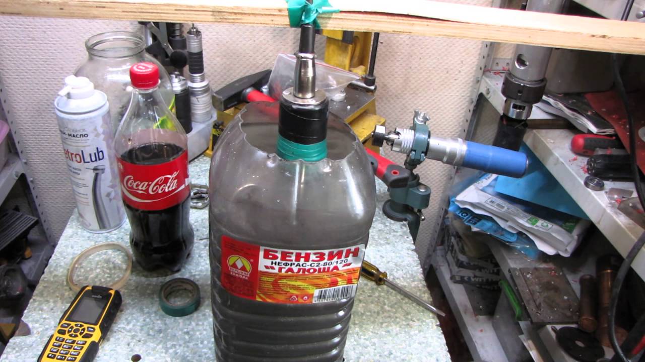

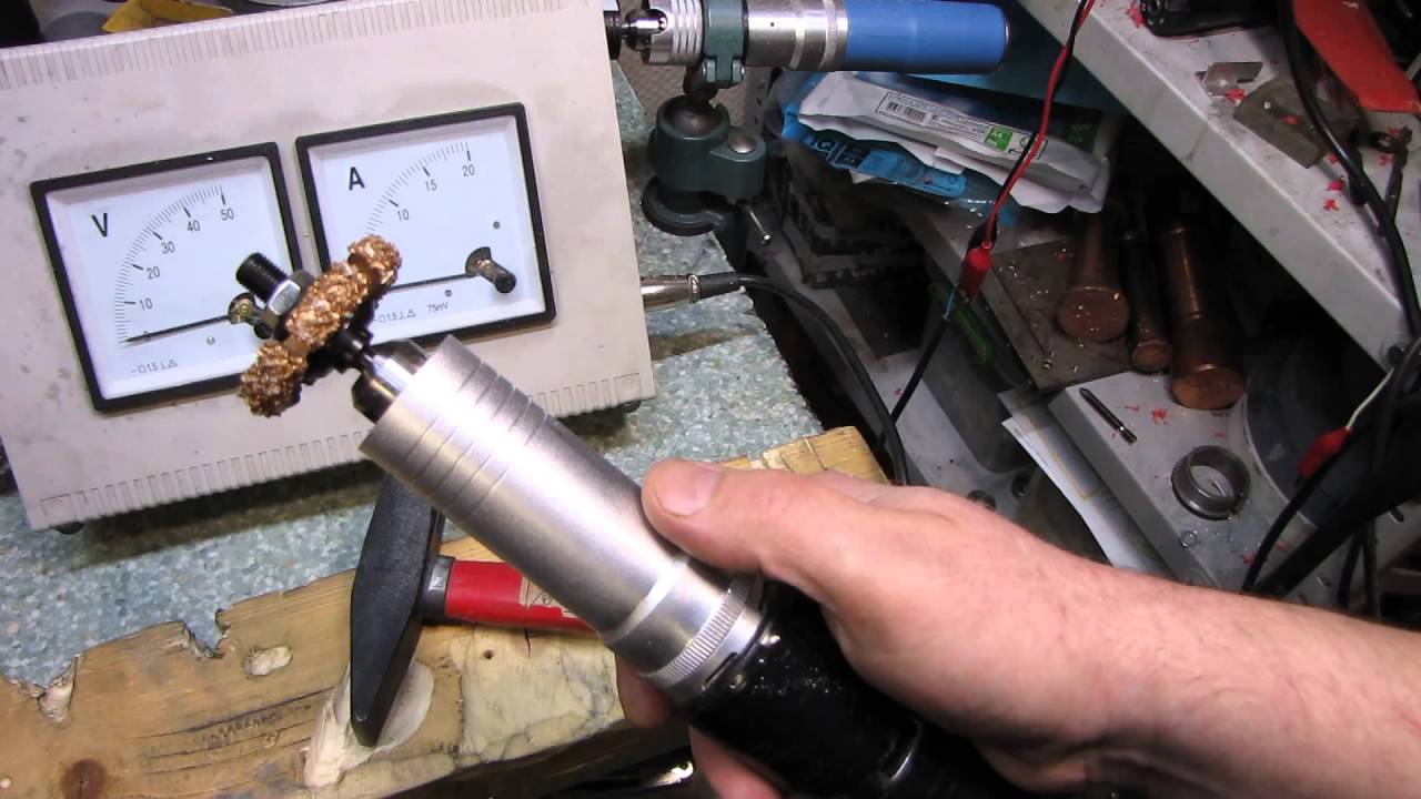

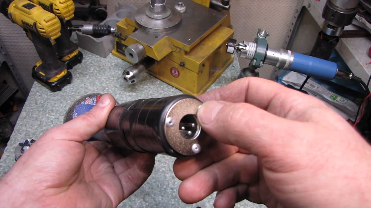

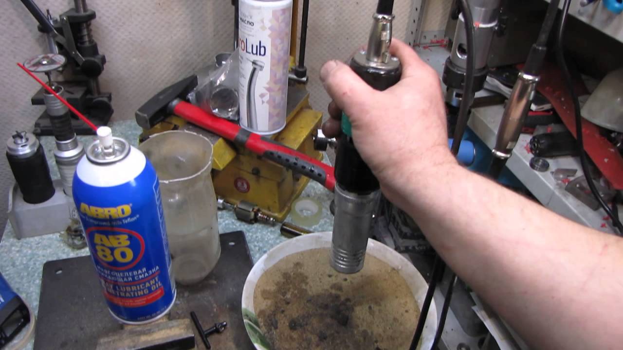

Hope you`ll enjoy this
Russian tool is heavy duty one (waterproof, rainproof dust proof).
But it is seems like it has rather small RPMs so it is not suitable for metal/glass engraving attachments.
If one day it will have simple onboard on/off switch and variable speed control + direct wall cord plug it could be even more interesting.
This is power of a drill/mill in a hand.
