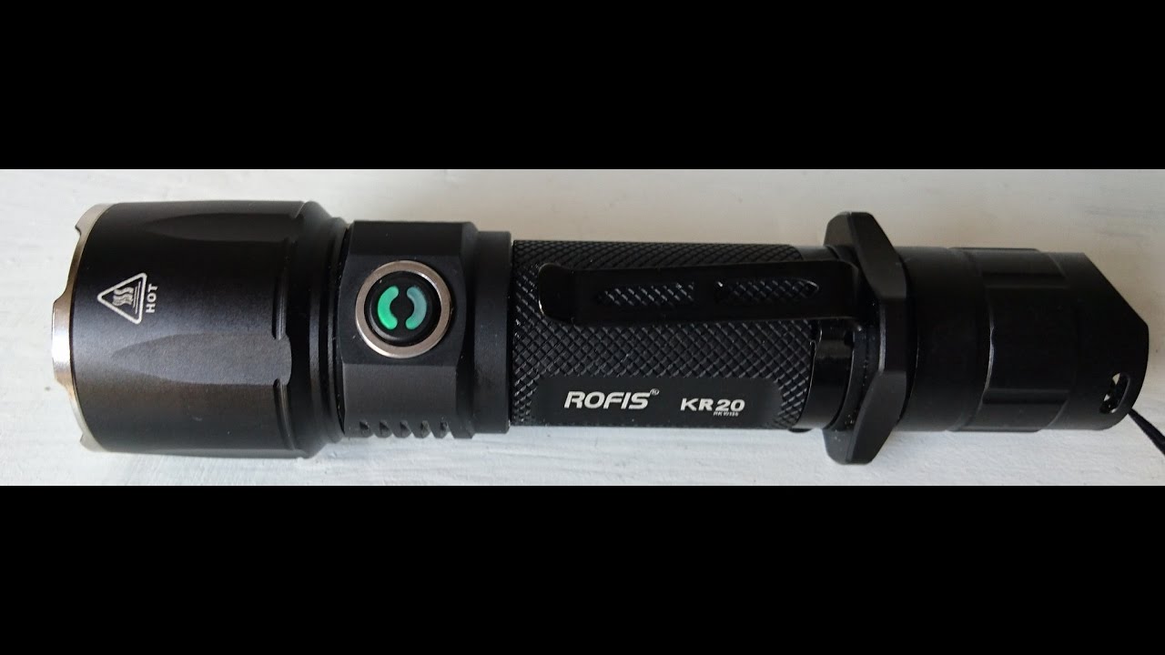

Hey folks today we will be reviewing the Rofis KR20 every one seem to love the Rofis TR20. This is for a good reason the TR20 came with great features. The Rofis KR20 is a more tactical style counterpart to the TR20. But the KR20 is still feature packed with all the goodies you want in a more robust outdoors and sports style flashlight. You lose some features from the TR20 but they are more then made up by the added features you get with the KR20.
The KR20 is more beefy and robust compared to the TR20. The TR20 is more of a work style flashlight it has all the features you need to make it a great light for work in the trades. I guess you could call the KR20 a work flashlight also if your in the military or a police/fire officer or even a security guard. The KR20 would come in handy if you do any of these jobs. Well to me a flashlight comes in handy no matter what job you do Gynecologist? Ha Imagine losing a flashlight up there going home and being like where did I leave it? Oh no! The same could also be said if you need your hemorrhoids checked. That would be a pain in the arse!

The KR20 is an awesome looking light! This is a good place to start I guess its the kind of light you would gun mount on your rifle. Its small but not to small coming in at 136.5mm (13.65cm) in length its a tad shorter then a Convoy C8. The head diameter is 34.8mm (3.48cm) and the body width is a messily 25.4mm (2.45cm). The KR20 is marketed as a thrower and it is defiantly a thrower but by the specs you can see it will have limited throw. The reflector is deep but is not to wide you get the extra throw from using a XPL-HI width wise the reflector is probably half the width of a C8.
So for the purpose of this review I will call the KR20 a pocket thrower. This is where theKR20 holds its place in the pocket throwing market. It is much smaller then a Convoy C8 but offer about the same amount of throw compared to a stock XML2 C8. The KR20 will give you 336 meters of throw with a peak beam intensity of 28360cd not bad for a flashlight that only weights 118 grams with out the battery. The KR20 achieves its throw from using the Cree XPL-HI in a cool white tint. The TR20 also uses a XPL-HI but the reflector is about 1/3 of the size of the KR20.

Rofis still managed to give the KR20 a manual switch which means it has the greatest feature known to man a manual lockout. Considering how small the KR20 is I am surpirsed that that Roifs opted for dual switches. The back switch is mechanical and the KR20 also features a back lit side switch which acts as mode selection and a battery indicator and location beacon for when you leave the KR20 unlocked. One thing to note is when you are charging a cell inside the KR20 the tail cap switch has to be in activated mode or else the battery will not charge.
The KR20s back mechanical switch and memory mode means you can select a mode and mechanically turn of the KR20. Then when you turn on the KR20 it will still be in the same mode. When using the back switch the KR20 will always start on your last used mode with out having to cycle modes again. This feature is used a lot by hunters when they want to spot out prey usually they would be using a remote pressure switch but this elevates some of the need for a remote switch. The back switch also acts as a momentary switch so you can half press the button and the KR20 will stay on for as long as you are holding that button. Might as well throw away all your pressure switches.
The KR20 uses hard anodizing type 3 with a semi gloss finish its dark but not way to dark it would be a similar finish to the TR20 the anodizing on the KR20 is thick and will last. The KR20 also uses AR coated glass lens. The KR20 is built out of the usual Aircraft grade alloy aluminum. The knurling is so fine on the KR20 but it does do its job well plus you have the added luxury of the tactical ring which helps hold the light when using the rear switch and using gloves.
The Rofis KR20 is water resistant with an IPX rating of 8 this IPX8 rating means a minimum water resistance to 1 meter under water. But Rofis went one step further and mde the KR20 up to 2 meters water resistant. Its not a dive light so don’t be goofing around diving with it.
The water resistant rating is thanks to the KR20 using a O-rings and a USB rubber boot charging cover to cover the integrated charging USB port. The port cover fits on nice and snug and tight you can lube that port cover up for extra protection. This sounds like I am heading in a dirty pun direction right? What are we 10 years old?
The USB charging port is a great addition to the KR20 it charges at about 750mah if I am correct I did check my self . This is with the included Rofis USB cable and this chraging rate also depends on the USB charging port you are using. The termination voltage is 4.20 volts on the dot! This is amazing how they get it so close it could be a fluke checked with my fluke multimeter if you know what I mean. It appears to have the correct charging algorithm by droping current but keeping voltage the same amount at the end of the charge cycle which will add charging time but keeps your batteries happy. When you are charging a cell in the KR20 the red indicator the side switch will be on. Once fully charged the switch will turn to the standard green indicator so you know its done. When the charge cycle is almost done the switch flashes green while staying red at the same time. I like leaving the KR20 on standby mode so the location beacon flashes makes me feel all fuzzy in side.
The Rofis KR20 has a max output of 1100 lumens on turbo mode. All these numbers for the KR20 are ANSI rated using the included 3400Mah 18650 battery I think it is a re-branded Panasonic cell I will take one apart soon and have a quick look around. You can also use either 16340s or CR123 in the KR20 but run times will suffer. Also the USB charger will not work with these style cells the inbuilt charger will only work with a single 18650 battery. The batteries point towards the head in case you where wondering.
Mode selection on the KR20 is easy I love using a simple UI give me one button to push like a monkey and I am a happy man. Basically all your modes are accessed by using the side switch the 5 standard modes are easy as to access. Simply make sure the KR20 is unlocked and push the side switch to cycle modes. These modes are as follows.
