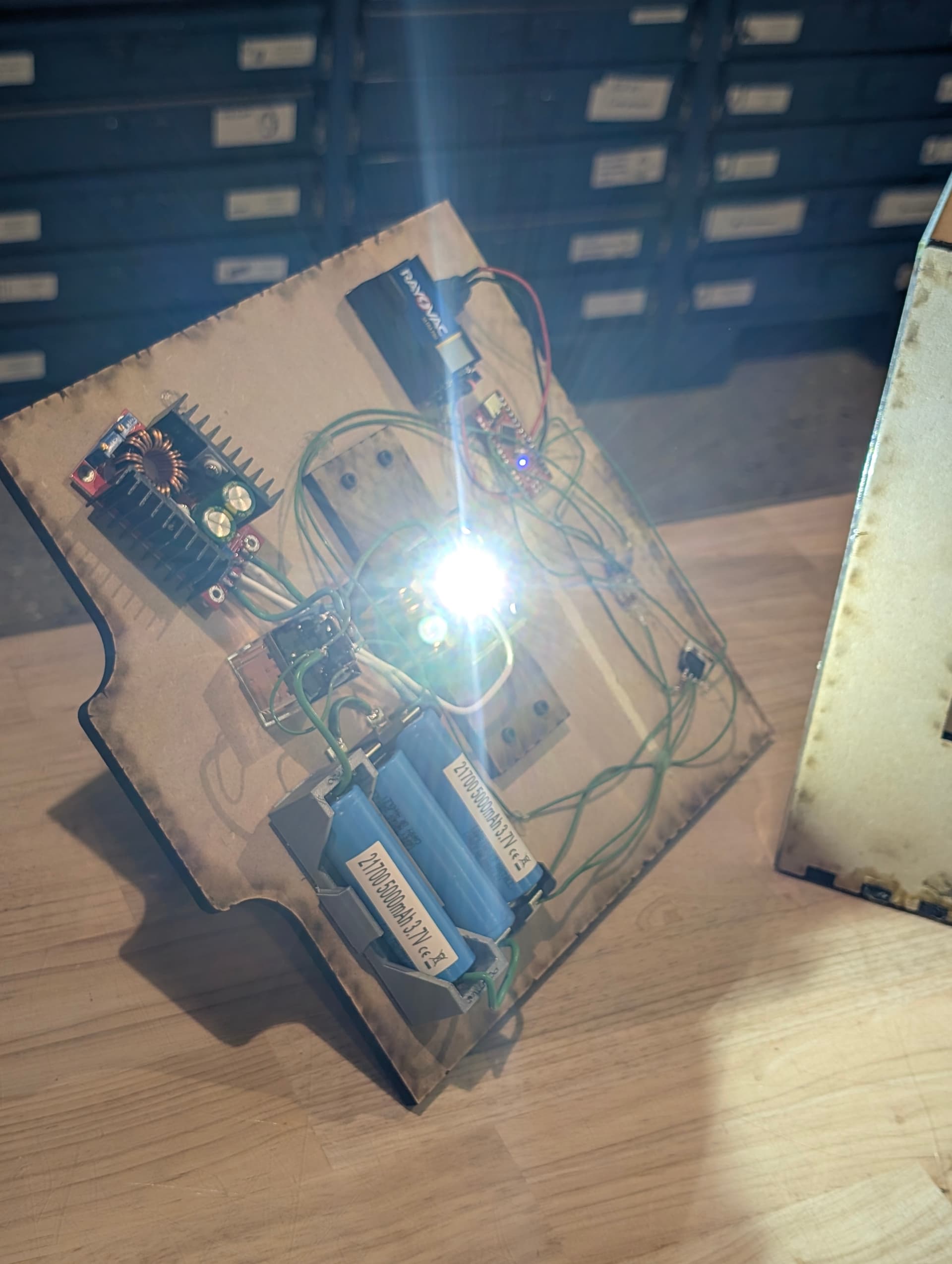

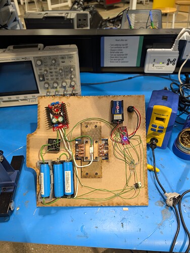

I wasn’t sure that the convoy drivers could handle a continuous 100% power without cooling, rn it’s in series for the buck but I could convert it to use a standard driver and be in parallel
I’m no driver expert, but I believe those Convoy buck drivers are pretty efficient. All else equal, input voltage close to output voltage is preferred. I don’t think you’d be any worse off than you are now, and you’d get the amperage output you want plus a UI.
As for sustained output, I think our hobby is a little lacking in the study of driver thermodynamics. But if you thermally decouple the driver from the LED like you have, and maybe add a heatsink to the driver, I imagine you’d get a big boost in sustained output versus a setup traditionally found inside a flashlight.
One drawback would be lack of thermal regulation at the LED- since LED4POWER shut, I’ve not seen any MCPCB LED boards that offer a way to remotely measure LED temperature, of course, with this setup, it looks like there would be space to attach some sort of temperature sensitive resistor near the LED.
To be fair the LED really shouldn’t even be warm given all the cooling I’ve added, after a while at full power I get a few degrees over ambient at most

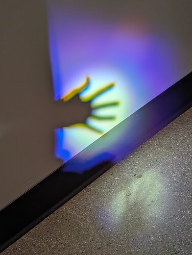

Here’s the almost finished light, if I can find a way to drive it harder then I’ll update the electronics, otherwise I’m happy with it as is.

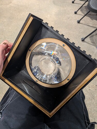

I need to re do the lens holder to add 1.8mm to get the led better focused and I also need to create a centering ring for the lens, then I’ll glue in my magnets and the box will be complete.
I’m going to brainstorm ways to keep the lid perfectly centered before I add the magnets

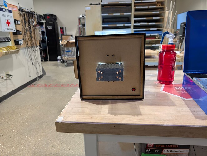

The spotlight got fully redesigned and is now very easy to build and it’s super sturdy

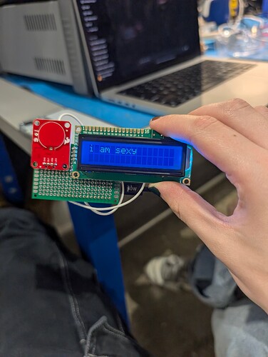

co-worker projects: I taught cad and then we raced to make new name tags; I taught Arduino and soldering and we made a screen that shows a new affirmation whenever the button is clicked

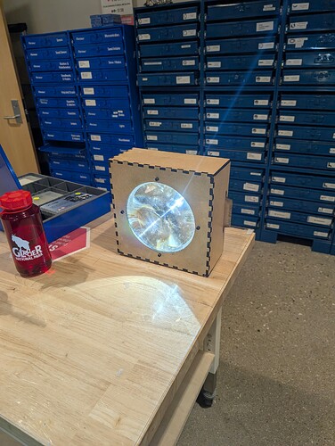

spotlight sealed with poly and painted inside to reduce reflections. I will upload a full video showcase later this week.
