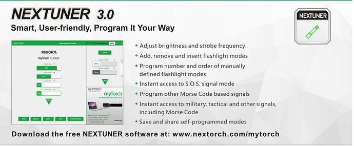

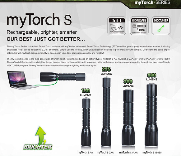

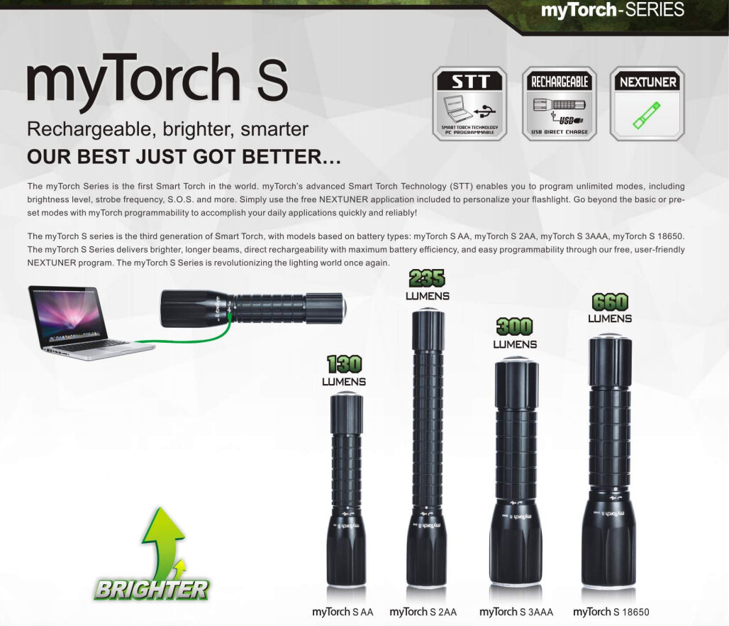

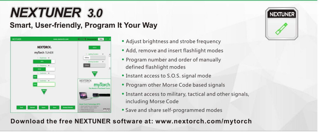

There is one thing that I really want for some time now, in terms of UI, but (almost) no manufacturer has attemped it: a user customizable/programmable of the UI (with a software program) via the USB-C port.
There was one manufacturer (Nextorch) that tried and developed it and was really on the right way (I think), but for some reason they quit with the concept. I’ve never tried it, but in general it exactly looked like how I would like it to work.
There is not much info to be found about it anymore, but I found a little bit of information that explains most of it, to give you an idea:
The download link mentioned in the image above no longer works, but the German Nextorch website still has a working link, which I already translated to English with Google Translate: Download Nextuner Software | NEXTORCH Deutschland
I’m not saying that you exactly have to copy what Nextorch did, but I specificly use this as an example, because it basicly is (almost) the perfect example of how I would like the concept of a programmable flashlight would like to work!
The fact that choose your own specific brightness levels (to suit your personal needs/preferrences), can add or remove levels/modes, change the order of them (for example if people want High-Medium-Low instead of Low-Medium-High), program your own blink/morse code signals.
This feature really suits this part of text in your post:
It is ‘weird’ (or maybe better: unusual) and I think it hasn’t REALLY been explored yet, since I personally know of only this one manufacturer that did it in this way and quit with it before it really got a (good) chance (in my opinion).
